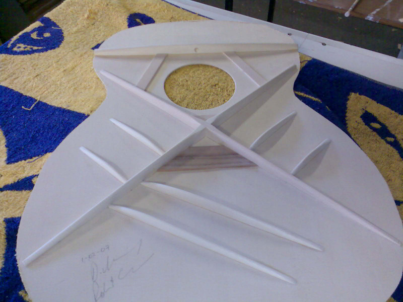

We built this identical pair of OM's in early 2007. One had parabolic bracing the other scalloped.
One has since been sold bit I still have the parabolic.
The scalloped instrument exhibited better bottom end but the parabolic was much more focused in the mids and top end. It also had a much more even response as you moved up the neck.(and this was before I started using carbon fibre in the necks)
Both are still nice guitars - just depends what you prefer. The para would probably make a better fingerstyle instrument.
I've since moved in another direction with bracing so I'm not sure which I'd now prefer.
There's a pic of the parabolic bracing (the tone bars are kind of short eh
). I can't find a pic of the scallops.
