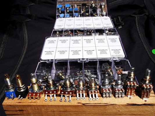

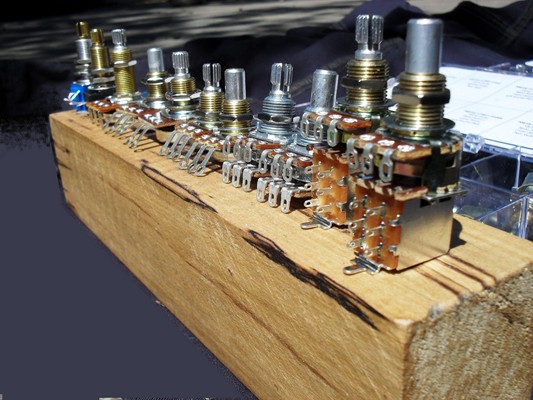

HI guys,
I recently tested out some of the Potentiometers by Bourns and i thought to share the input here:D
Firstly, the samples
- SDC102734 (Copy).jpg (94.46 KiB) Viewed 19851 times
- SDC10269 (Copy).jpg (103.96 KiB) Viewed 19851 times

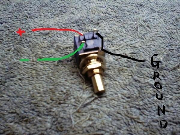

The first thing you may notice, there are a few sealed pots (Bourns® Model 95 Premium and
Model 82 Vintage Guitar Potentiometers) and a few standard(unsealed) pots.
The sealed blue and black pots have a washer with a tab that you use as a ground instead of the back of your pot, great for removing the pots and re-useing them without much risk of heat damage. Also being completely sealed it make it hard for dirt to build up inside and you also dont have to worry about solder running into the pot as you ground the outer lug. As you can see the unsealed pot has a slightly different lug settup(top pic) and the sealed 10% vintage/20%Modern pots (bottom pics) are built a little better with better quality washers/nuts.
- l_0d4fa6e5807f4531b854cafcea77e02f.jpg (47.18 KiB) Viewed 19845 times
- l_47b67b35dc98491d9bf5300363b0439d.jpg (47.72 KiB) Viewed 19845 times
- l_23d202c5150b4f428fede1fa1653d4bf.jpg (89.28 KiB) Viewed 19845 times

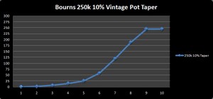

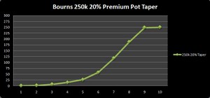

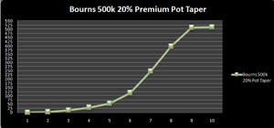

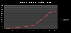

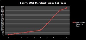

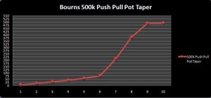

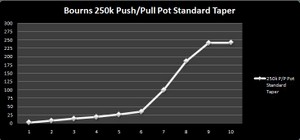

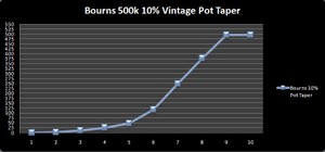

Ok, here is where these 2 sealed pots shine...the taper.
For gradual roll off and volume swells, i give a 9/10 for both. These are really easy to control your tone, using 50's wiring i were able to clean up and add dirt quite easily by rolling the volume back, no extreme jumps or loss of volume, just nice, smooth controlling. Clarity is very nice and no scratching anywhere in the 4 pots i sampled for each graph.
I made up the following graphs using a multimeter and a spreadsheet to help you get an idea of the different tapers. Each graph is the result given from an average of 4 pots. I did this with all models bourns sent me, the 250k taper is nearly identical to the 500k for each model, very consistent pot building
- Bourns 500k Standard Pot Taper (Copy).jpg (10.85 KiB) Viewed 19839 times
- Bourns 500k Push Pull Pot Taper (Copy).jpg (11.13 KiB) Viewed 19839 times
- Bourns 500k 20% Pot Taper (Copy).jpg (10.86 KiB) Viewed 19839 times
- Bourns 500k 10% Pot Taper (Copy).jpg (11.41 KiB) Viewed 19839 times
- Bourns 250k Standard Pot Taper (Copy).jpg (10.72 KiB) Viewed 19839 times
- Bourns 250k Push Pull Pot Taper (Copy).jpg (10.89 KiB) Viewed 19839 times
- Bourns 250k 20% Taper (Copy).jpg (9.95 KiB) Viewed 19839 times
- Bourns 250k 10% Taper (Copy).jpg (9.94 KiB) Viewed 19839 times

Another thing i found really interesting is that the standard unsealed pots come in 3 different torque levels(how hard it is to rotate the pot). Not a bad idea really, if you dont use the tone pot much, a high torque would come in handy to prevent bumping the pot lightly and changing the tone setting you like
Low Torque - Easy to turn
Standard Torque - Med to Turn
High Torque - Harder to Turn
As for the Standard and push pull pots... also very good quality, though i personally find the CTS log pots to have a smoother taper thats easier to control. I found the RS super pots and CTS 10% custom taper have a similar feel to the Bourns sealed pots.

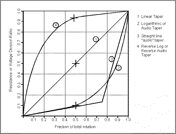

Well thats it for now, ill leave you with a graph of your standard log/audio and linear tapers to make a comparison with the Bourns Pots. I love how the Bourns sealed pots sit on 0-4k resistance at 1-3 on the knob, i like to use my volume swells for ambient playing and rolling off to claen up, for this... these pots are amazing.
- pot tapers.gif (10.65 KiB) Viewed 19839 times

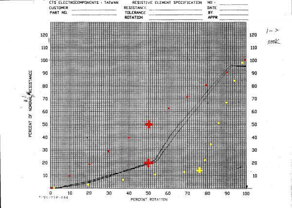

Hi Kim,
Your regular cts pots have the regular Audio or linear taper as posted in the white graph above, the custom taper 10% CTS pots have a different resistance curve, this graph comes from a freind, Jonesy in the US (it was sent to him from Ron at CTS)
Red - Linear CTS
Black - Custom CTS
Yellow - Audio CTS
I plan on doing the same thing for CTS and alpha so i can give clients a visual, i will add... no pot is better, but finding one that suits your playing style is the key. A guitarist that plays on 10 wont care much at all for taper variations.
Red - Linear CTS
Black - Custom CTS
Yellow - Audio CTS
- Red is Linear
Yellow is Audio
Black is custom taper (middle) - l_b7757915512040399f100d052e773ef6.jpg (73.13 KiB) Viewed 19741 times
