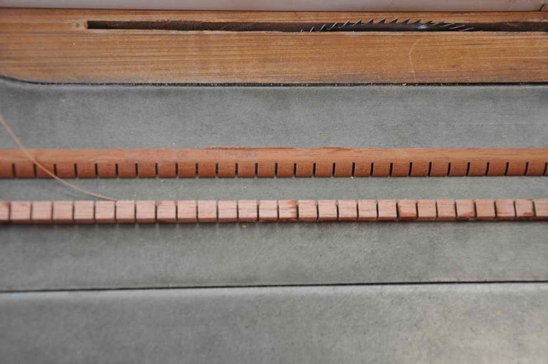

I've never liked the size of the kerfed linings that are sized for guitars going into something as small as a ukulele, so have usually made solid linings for my own, or made custom sized kerfed ones. But after a good buy on some ods and sods of various linings on the OLF Swap meet many months ago I decided that many of them weren't good enough for guitars, but just right for ukuleles I picked out a small amount of the stash and after thinking about what I wanted to accomplish and trying a couple different machining operations I settled on using my Stew Mac fret slotting blade to slice these guitar linings approximately in half thus doubling my lining inventory and giving me something much more appropriately sized for a uke.
Reverse kerf linings, One half to be used as intended, the other can be used with either the web inside, next to the side, or out and in the reverse scenario as above.

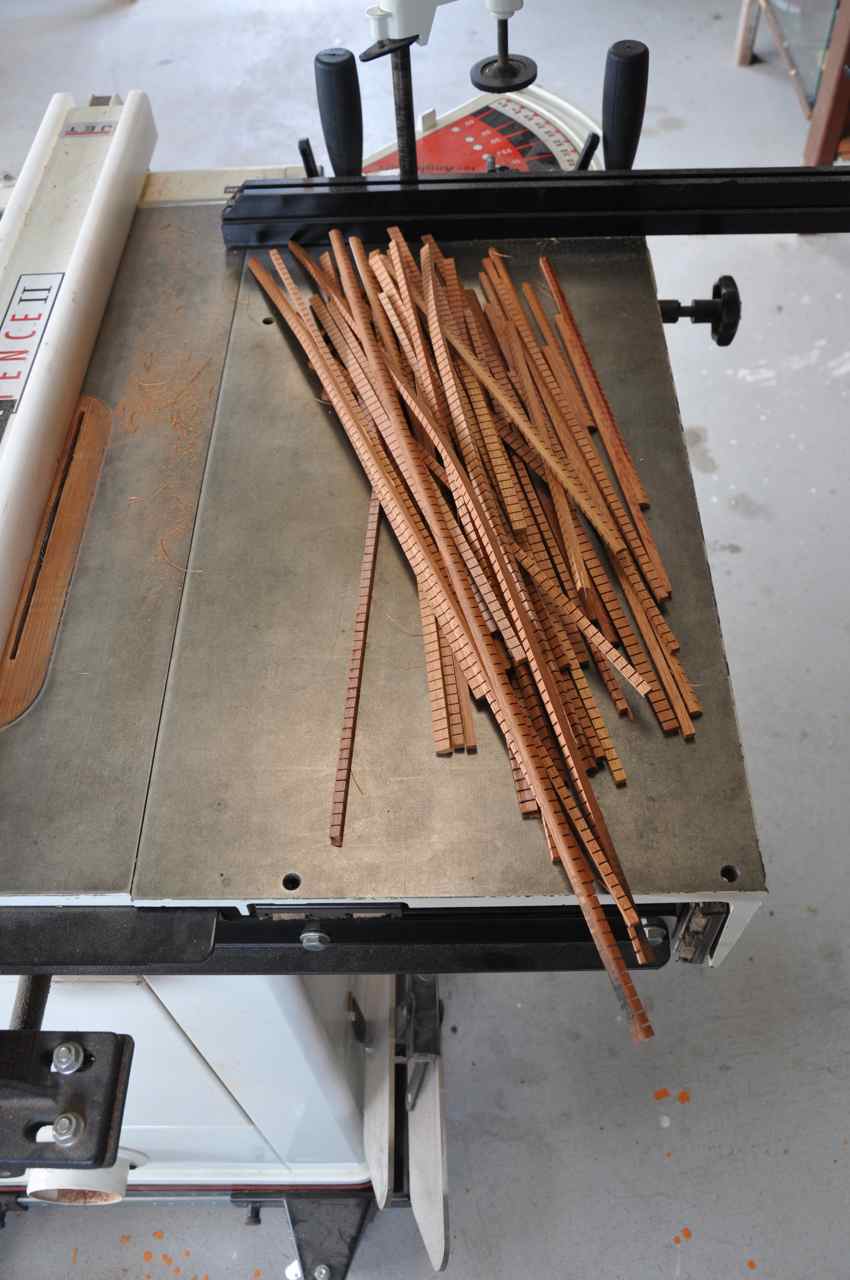

While the machine was set up I cut up a bunch to get me through the next couple of months.

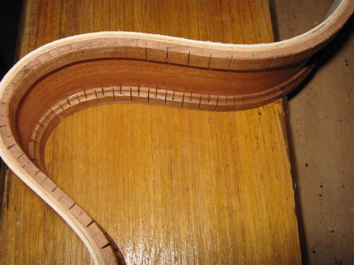

I kerf both sides for those tight bends.
Cheers,,, Rod

Yep - Essentially homebuilt Squiglewood. Great stuff :D

Just showing off Rod. :D
And no, I've not tried that one yet, but will the next time around. Though I'm not sure it will be enough, as on a tenor uke, those bends are REALLY tight.
Thanks for the tip.
