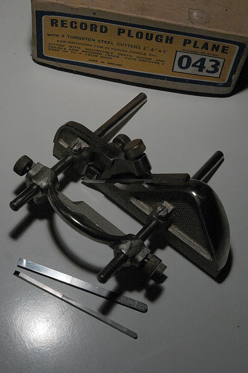

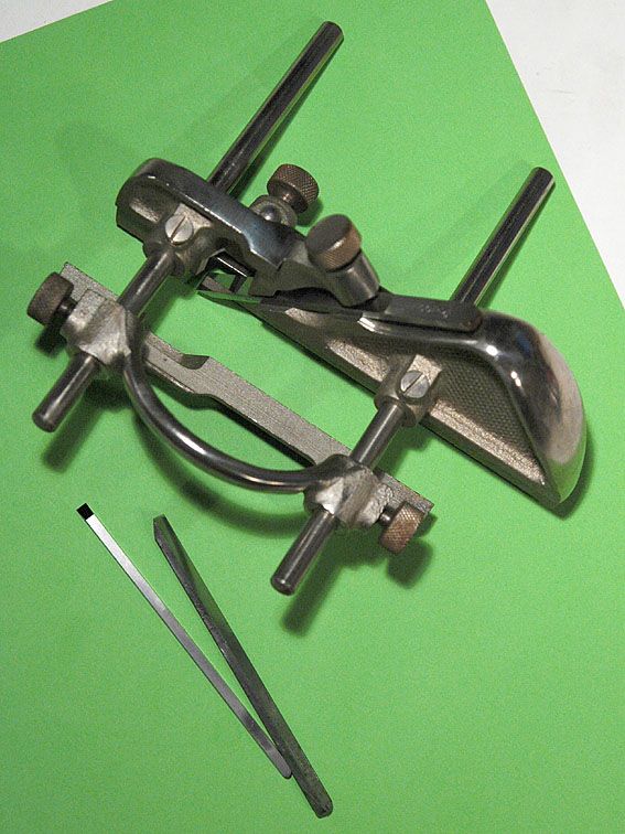

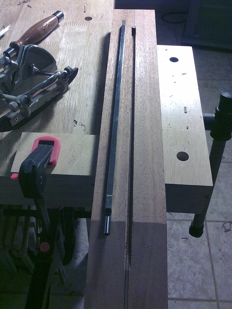

Had to cut some truss rod channels last night, so I thought I'd share how I go about it.
I know a router will cut a lovely clean, straight & square channel time after time but........I hate routers!
They're noisy, messy and, to be honest, they scare the sh*t out of me.
This little plough ('plow' for you yanks) plane is one of my all time favourite tools.
I only wish I had more opportunity to get it out!
Their are a few brands of this type of thing. This one's a Record.
It comes with 3 blades, of which I use the 1/4" for truss rods & the 1/8" for CF rods.
So it's slower than a router. Fair enough. It's much slower.
You also have to complete the last few inches of the channel's "dead end" with a chisel. Can't argue with you. It's a fact.
But...
It's quiet.
It's accurate.
It feels good.
It makes me want to do more woodwork dammit!
Is it better than a router? Probably not.
Depends how you look at it though :wink:

Post by charangohabsburg » Wed Feb 16, 2011 12:25 pm
Clancy wrote:But...
It's quiet.
It's accurate.
It feels good.
Clancy wrote: This little plough ('plow' for you yanks) plane is one of my all time favourite tools.
Dammit! You made me want one too!!! :mrgreen: :D
Thank you Craig for showing us this one!
And now I already have one! :D Not that nice as yours, but it's ok.
I will like and use it for the reasons you already have listed, and it because it doesn't produce as much dust as a router.
The same day you opened this thread I started searching...
Clancy wrote:Their are a few brands of this type of thing. This one's a Record.
Yes, there is also the Veritas plough plane, but my bank account said that I'd better buy a used Record and spend the price difference on some more wood...
So I went hunting on eBay.
Today (oh well... actually yesterday...) I received my parcel. There is only a bit of rust on the knurled knobs (don't know yet how to get rid of it, but that's a minor issue), and there was a bit rust on the blades too (I could nearly wipe it off, oh well some assistance of 360 grit sandpaper was needed). The plane is nearly unused, two of the blades had still the protecting varnish layer on. Honing the mirror side of the used blade was a breeze, the new blades cost me some more work (no flat mirror side on new blades).

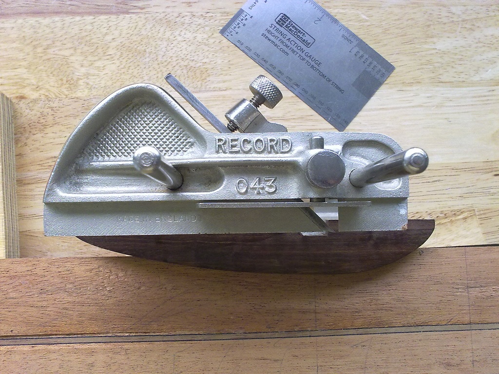

I think I also will make a wooden fence, a bridge blank will do it.
So I am pretty happy with this new tool. Maybe I'll use it mostly for routing channels in MDF :shock: when making tools and jigs. I don't like it a lot to work with MDF (has some virtues though), but I think not having to touch it with spinning router bit is a great enhancement regarding dust production.

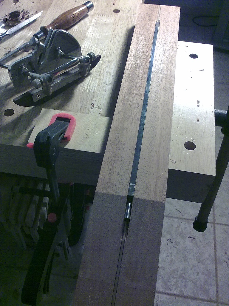

Here come two low quality nighttime pictures (bad light):
Thanks again, Craig!

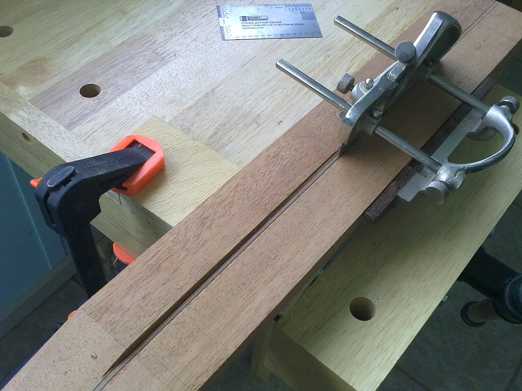

Clancy
Posts: 620
Re: A tool I like
Post by Clancy » Thu Feb 17, 2011 10:51 am
Nice one Markus.

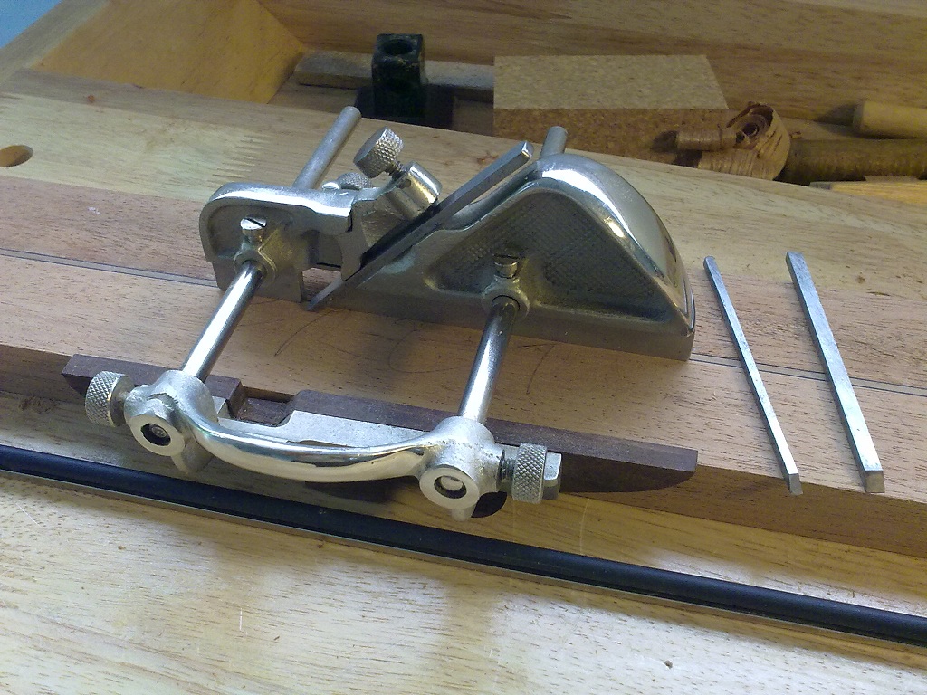

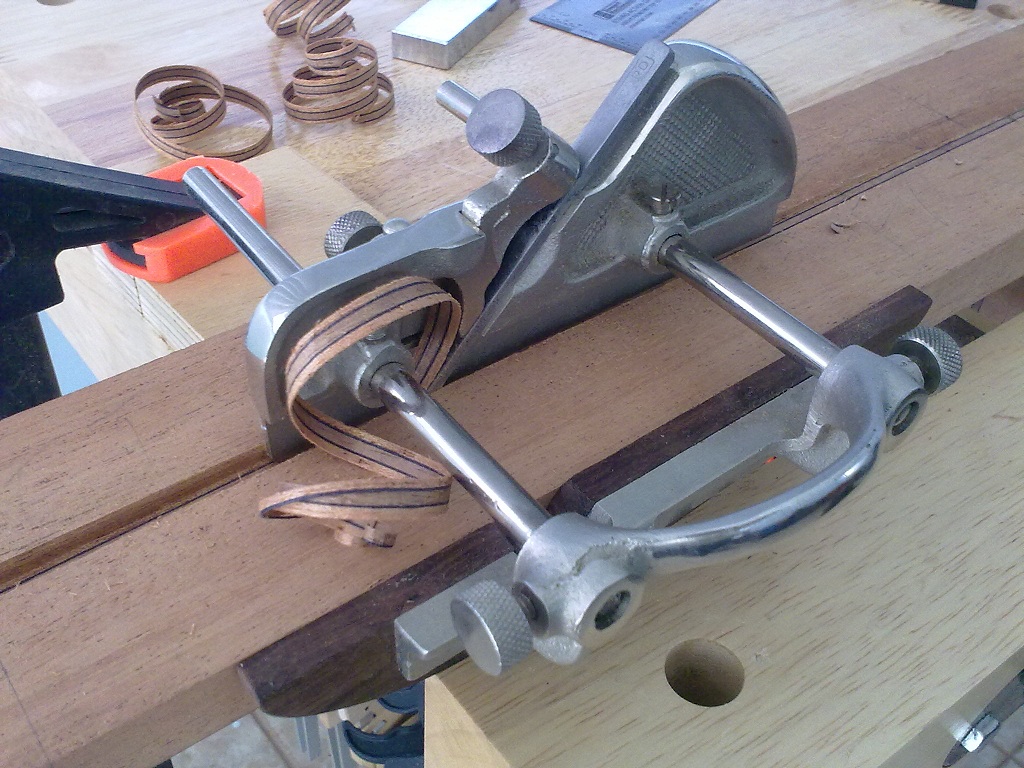

You will need to put a wooden fence on it, they are designed for this (I shaped up a scrap piece of burdekin plum).
The fence adjustment on these planes was made for the rods to stick out to the left. Unfortunately this gets in the way of the fence handle.
Using a tip from Derek Cohen, I place the rods out to the right and use the locking srews to set adjustment rather than the knurled knobs on the fence.
Have look at this....
http://www.onlinetoolreviews.com/review ... wplane.htm
I wish you many hours of enjoyment with your new tool.

I have some cherry bridge blanks laying around but i don't think of making bridges out of cherry. It's local wood I cut some years ago, and part of the rests it just had the dimensions of bridge blanks ...or plough plane fences ;)
Clancy wrote:The fence adjustment on these planes was made for the rods to stick out to the left. Unfortunately this gets in the way of the fence handle.
Yes, I already noted it 8) and then also saw in your pictures how you handle the handle/rod problem. Probably I'll do gross adjustment with the locking screws and allow up to 10-12 millimeters of protruding when making fine adjustment with the knobs.
Edit: finally, here is my wooden fence.
