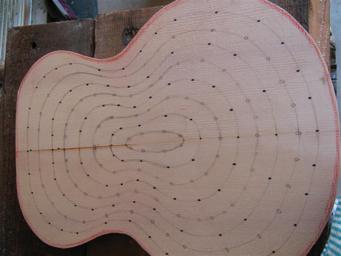

Hey, despite saying i would make my pantograph on the weekend it didn't happen. I ended up getting stuck into the next batch of guitars including 2 MJ cutaways, a 13 fret cutaway L-00, another hauser classical and an archtop. We've seen plenty of archtop builds here but I don't recall seeing anyone actually carve a top or back so i thought I would post my progress. Here goes. If anyone has any comments or thinks I am stuffing something up please let me know. Its only my second archtop so I don't want anyone picking up any bad habbits I may have.
Top is sitka from Alaska Tonewoods. B&S are maple from SM. It has been glued and cut out pretty close to final size which makes carving the profile more consistent as you don't have to account for any overhang.
I am using wedges so the first step is to thin down the edges around the neck and tail blocks and the waist. I use my home made scrub plan, a block plane and my Ibex palm plane. This is so the safety planer can get into those areas to cut the margin.

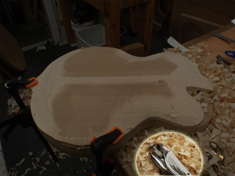

Next I have set up my safety planer and in two passes take the margin where the re-curve will go down to around 10mm. I have attached a rounded piece of 9mm mdf under the planer to act as a stop so the margin is nice and consistent at around 30mm in from the edge. You can just make it out in the pic.
You can see here it is a nice even line which is very difficult to do free hand.
Lastly, I have hollowed out the back a bit so when I flatten it I am only sanding the glue edge and not the whole back. There is not a lot to play with on a 17" archtop from the wedges I got so I left flattening the back to last so I had enough to carve with.

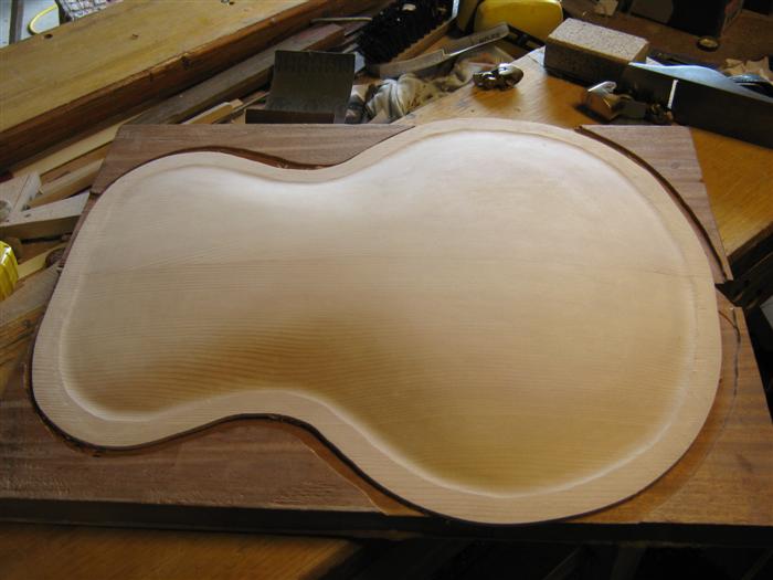

Next step is to use the various arch templates and carve those into the top before joining all the curves up. I'll post more pics soon.

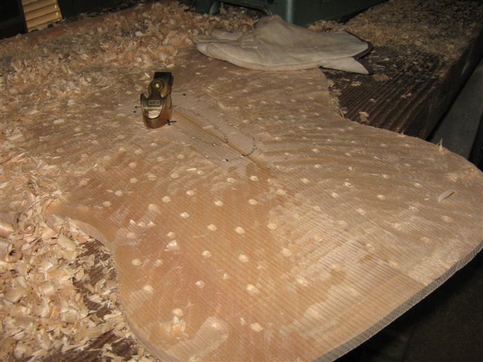

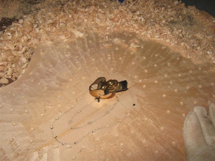

I've been busy this weekend. I've got the neck and tail blocks glued up on one MJ and the classical. Also made 5 fret boards and bent up some strips to make solid linings.
But most fun was the work I did on the archtop. I made two new planes, one with a beautiful curved hock blade and one with a toothed blade I got with my palm plane. Both are made as scrub planes for rapid stock removal. They work either pushing or pulling. Heres a pic.
So I have been working on the arch on the long axis and smoothing it out towards to sides but my main focus is getting the arch right down the glue line. Nearly there. The arching is a bit high still and i need to lower the whole curve. You can see the dark spots where I have not cleaned off the outside wood from the wedge yet. The new hock blade plane works great and I can plane against the grain and it still cuts clean. For the initial hunking out of material I had it set for a very aggressive cut and it didn't take long to get down to the basic shape. Next step is to refine the arching from the centre out and and work on blending it all into the recurve area. This is so much fun. Last picture is of the cutaway MJ.
