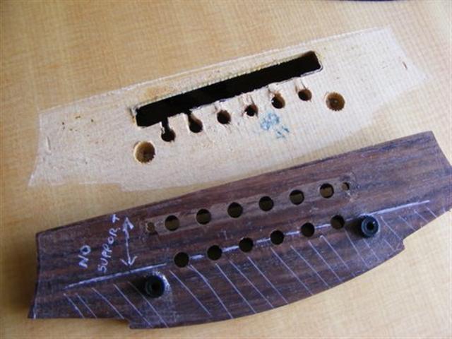

I'm just working on another top USA branded guitar [the bridge flew off] made in China, where the rosewood bridge plate is only 4-5mm wider than the bridge.

It looks like anything goes. "If you cant see it, she'll be right", another well known manufacturers blooper.
The shaded area on the bridge was the only area covered by the bridge plate, no wonder the top deformed and the bridge let go. The manufacturers did offer to do the repair, but were sorry the guitar was out of warranty. I left that one to the customer to sort out.

It looks like a case of Bridgeplatus Incorrectolocatus!
Re: Bridge and bridge plate wood
Wow!
what's the point of the massive slot
liam_fnq wrote:Wow!what's the point of the massive slot
It's for the pickup..Maton do much the same.
Wow, that's weird! Hilarious. It looks like the black hole where the owner's money goes in when the bridge or top does not fail within the warranty period.Kim wrote:It's for the pickup..Maton do much the same.liam_fnq wrote:Wow!what's the point of the massive slot

Some Takamine's use the same pickup hole, but often a pinless bridge so less holes in the top to weaken it. And the bridge is glued and bolted on.
The Takamine that I put a new top on was like that one Taffy. Big slot and bridge pins.
