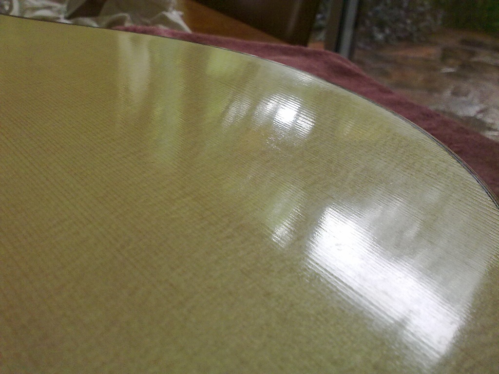

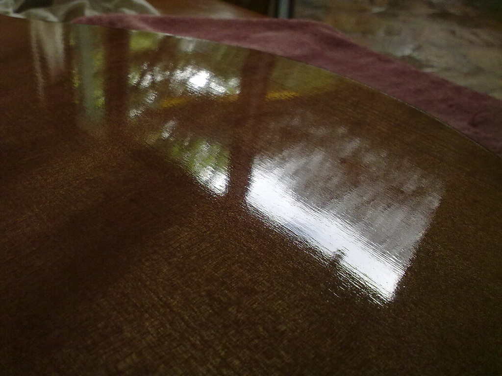

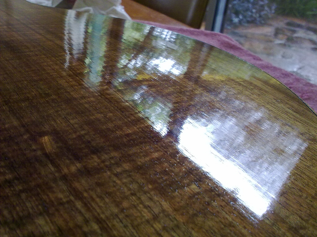

Just thought I'd mention that the 'grain accents' are now appearing in the back & sides.
I've tried to take some pics of these to show you but it's hard to catch with a camera.
The finish is so thin & looks so cool, I'm really liking it.
The spruce top

The Tassie Blackwood
The Tassie Myrtle

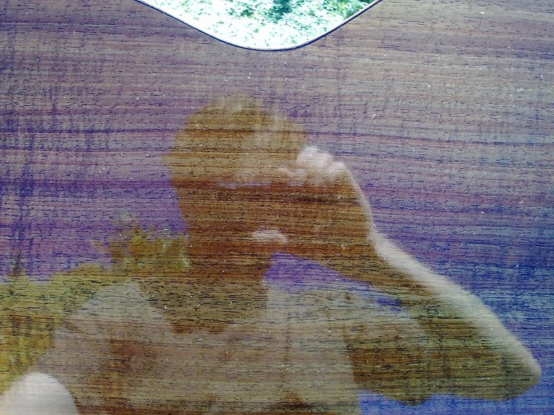

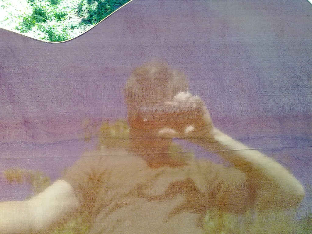

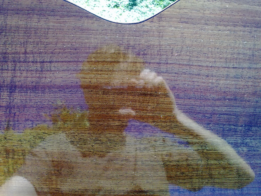

The Myrtle
The Blackwood
Hopefully the mirror won't crack in the next year or so!
