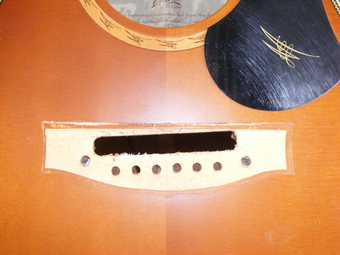

Taffy, Now I can also see why they bolt their bridges through the soundboard... If I made mine that way I would be worried about the glue failing as well! Thats beyond shoddy in my book... And people want to know why a proper guitar costs more...we all know the answer :D

Post by Taffy Evans » Sun Mar 27, 2011 9:45 am
Hi John, I don't see Maton using bolt on bridges anymore, tho I do have some from the 1960's bolted on, CW100 for instance, even had a cup washer under the bolt head. I've seen Takamine's use a bolt on bridge with this same pickup system concealed under a wood dot inlay . The two bolts seen on Maton bridges hold the pickup in position under the bridge.

Post by woodrat » Sun Mar 27, 2011 1:51 pm
Hi Taffy, I was under the impression that the two outside holes in the photo that you posted were for bolts through the bridge and they would be hidden under a pearl dot. Are those holes to just mount the pickup?

Post by Taffy Evans » Sun Mar 27, 2011 3:25 pm
Hi John, I see now, those holes are for two locating plastic dowels that go into the top and part way into the bridge, for positioning the bridge during manufacture.

Post by woodrat » Sun Mar 27, 2011 3:52 pm

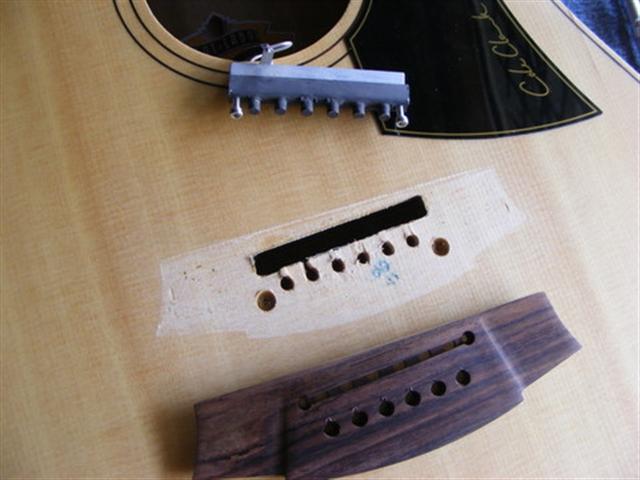

OK I see Taffy, I thought that they where the bolt hole locations. I (and countless others) use small holes at either end of the saddle slot to locate my bridges....but Maton have gone and chopped a great big hole there! Well... interesting...do you have a picture of their pickup? and why is it necessary to have it through the spruce like it is? I would have thought that it would decrease the gluing area by a considerable amount.

Post by Taffy Evans » Sun Mar 27, 2011 6:51 pm
So far I have come across Maton, Takamine and Cole Clark that use this style of pickup, here a pic of one off them.

Post by woodrat » Sun Mar 27, 2011 7:33 pm
Thanks for the pics Taffy, It is not a wonder that Cole Clark use them as they are ex-Maton personel. How heavy are the pickups? It seems that they remove an awful lot of wood to put the things in. In your photo the little bit of wood between the bridge pin holes and the MASSIVE GREAT BIG SLOT is easily broken out. I wouldn't like my spruce tops that compromised by a pickup installation. How many problems have you seen from this design?

Post by Tod Gilding » Sun Mar 27, 2011 8:07 pm
Hi John,
I spoke with Brad Clark about 5 yrs ago regarding this, but could'nt quite understand what he was saying, but here taffys pic is worth a thousand words,I was under the impression that the hex bolts just went through the soundboard and secured the pickup below it , that had me a little confused,but obviously not,Thanks for that pic Taffy.

Post by Kim » Sun Mar 27, 2011 9:08 pm
Based on scale of production, I have seen few bridge issues with Matons fitted with A4's and A5's. Lets not forget that these are THE Australian workhorse guitar. There are plenty of them out there and they have a good following for good reason. Yes they are built to a price point, but they must be to compete with the imports. At the end of the day, the A4 and A5 pickups are very good performers ( if I recall correctly they are made by B-Band in Finland) so if you are a working musician who plugs in and needs to set up, pack up and travel on a regular basis, you would be hard pressed to find a better tax deduction than a Maton or Takamine guitar to drag around the country.
