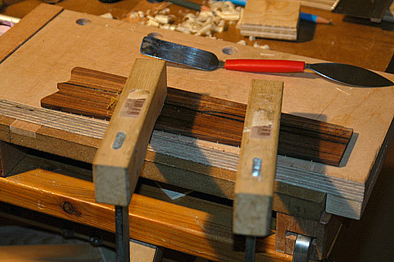

This is the bridge how it looked like before gluing it on:
charangohabsburg wrote:
  • Further on you can't see the saddle would just flip over under full string tension. Double design error, [...]
My two design mistakes were to copy the horizontal dimensions of an existing charango-bridge but having been so distracted that I applied the vertical dimensions of a classical guitar bridge, thus leaving the remaining wood in front of the saddle slot too thin for the relatively high saddle.
On a charango with nylon strings the saddle height (string height above the soundboard) normally is somewhere between 6 to 7mm, on this bridge it was 10.5 mm. This meant a highly increased torque force on the bridge which caused the saddle to break the wood in front of it within 20 seconds after having tuned the charango to it's final pitch.
Today I was searching the photo of the broken bridge but i seems that it remained on the PC in Peru. You have to imagine how it looked like. The pried off part of the bridge just flipped over like a hinge. Edit: here it is, it was still on the mobile hard disk...
I glued it back in place an glued a 3mm thick piece of rosewood in front of it to beef it up:
I clamped it with this go-bar setup:
On the picture above you also can see that the rosewood part of the soundboard is broken at lower edge of the treble side soundhole. This occurred due to another series of design mistakes. :shock: :lol:
When glued on, I planed the reinforcement down to it's size:
Done. Ready to string up again...

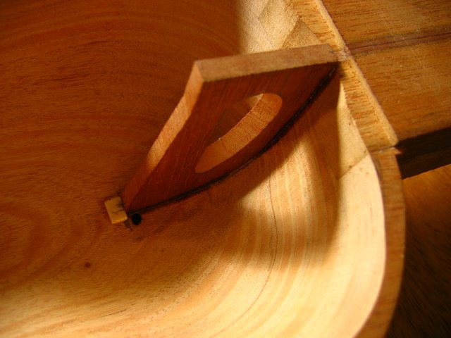

The problems here arose because the upper bout of this charango is not well supported by the soundboard. I had chosen to decouple the active part of the soundboard completely from the upper bout part:
Plantilla
This is not my own idea. But here, on this charango built by the Dutch luthier Jeroen Hilhorst (owned by my friend Patrick Zeoli) it works very well. He simply left off the whole upper bout part of the soundhole! Note that he also built in a sturdy, longitudinal center wall which handles the forces acting from the neck on the upper bout. In 2004 I tried to take a picture of that center wall but it was a bit difficult because the charango body is made of massive ebony (!) and taking a photo of black wood in a hole at night is a bit of a problem:
Try to see the center wall of the ebony body (1).
I cheated a bit with this picture by lightening up in Photoshop the dark part of the instrument:
This instrument sounds amazingly loud. When Patrick Zeoli got this charango the pianist José Cibils said: "Finally I can open the lid of the grand piano!" :shock: :lol:
It really works:
youtu.be/
Nonetheless Patrick complained about lacking mellowness and warmth of the sound and I thought that instead of this huge opening which is replacing the soundhole was a bit too much, allowing a too high air resonance. Nothing easier than to cover part of the opening I thought, but I didn't thing that this centre wall was really necessary and I reduced it to a mere support for the fretboard:
Small center wall - fretboard support
I thought it might be an intelligent idea to have an upper bout rosewood part of the soundboard that could vibrate freely and not only not let it be touched by the fretboard but also make it thin (down to 1.0 mm except the borders). But I grossly underestimated the forces from the neck, mistakenly believing the 6 mm thick bowl walls would be enough strong:

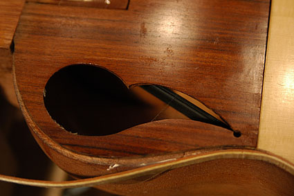

When strung up the upper bout got squeezed like a rubber ball (the soundhole positions helped :lol: ) and the centre part of the rosewood board moved about 1 mm south (of course cracking). The gap I left between the two soundboard parts nearly closed under the string tension.
There was even another mistake I made which helped the structure to fail. While the harmonic bar of the spruce soundboard is sitting in recesses like this one...
... the transverse bar of the rosewood board is not touching the walls but ends just before the weakest spot of the part! :shock: Too stupid.
Upper bout part of the soundboard with floating harmonic bar and center strut.
I simply relied too much on the 6 mm "thick" bowl walls.

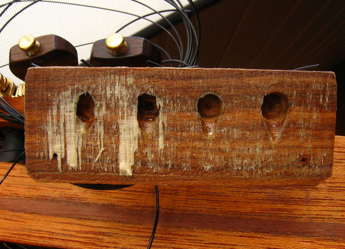

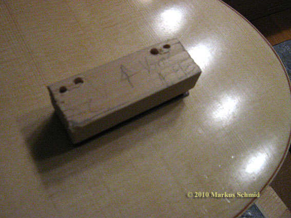

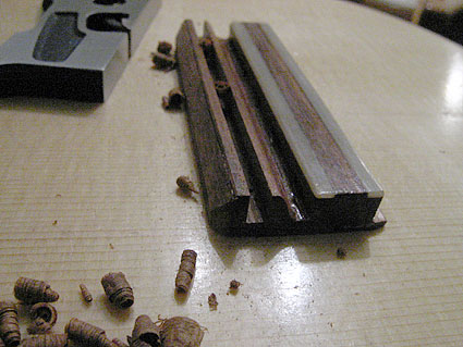

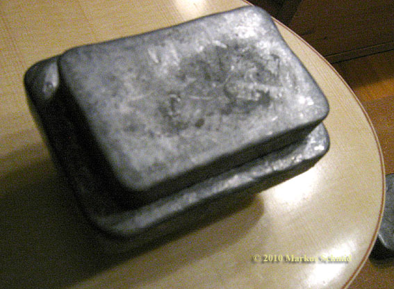

As promised some pictures about the flown off bridge.
First of all I have to say that I already knew that it might not hold well because gluing the bridge on already suffered from an accident. I used hot hide glue and steel location pins, pre-warmed bridge and top with a hairdryer and applied "clamping" pressure with some lead pieces:
Location holes - Removing french polish
Dry run
"Clamping"-caul
Lead-"clamp"
The accident: The charango was not camped firmly enough in the vice. Under weight of the lead, after a minute or so it tilted a bit and the leads slipped off, onto the soundboard :roll:. To my surprise, when I pressed the bridge with my fingers I noticed that the glue was still liquid at the inside of of the squeeze out which meant that the bridge and soundboard were really well pre-warmed an I had much more working time than I had believed before. So I simply put the leads back on top of the bridge and heated the whole area a little bit more with the hairdryer. But probably, by releasing the pressure on the bridge, at some spots air entered the gap between bridge and soundboard and let some glue cool down too much, and the heat applied with the weights on could not get through to the glue line. Next time I surely would repeat the whole glue process!

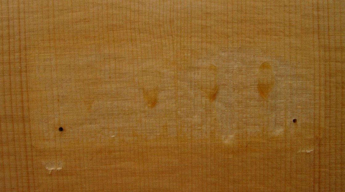

This is the soundboard and bridge after the bridge's furious "take-off":
That's where the bridge sat on.
Underside of flown off bridge.
You'll note that I had felt it would not be a challenge big enough to only minimise the bridge's footprint but I also had drilled some holes in it's bottom to reduce weight - an insignificant amount of weight but a significantly further reducing of gluing surface... :dru
You also can see how this accident visualised the runout of the spruce top. On the bass side (on the left half in the picture above) the fibers obviously dive into the top in direction of the neck, while on the treble side there is no tearout because the runout of the bookmatched half runs in the opposite direction. I think you can consider this amount of runout as minimal, it's about 1/4 mm on the length of 20mm. that's a ratio of 1:80, or ca. 0.7°. It's Florinett's AA quality, the same stuff as I have seen on Tim Spittle's website (go for it ;) ).

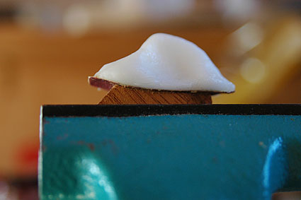

There's not a lot to say about re-gluing a bridge. Before using the steel needle locating pins I wipe them with a slightly oiled rag so that the pins can not get glued in by the hide glue:

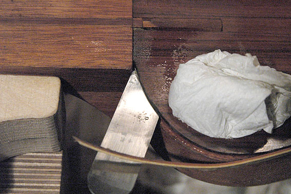

The next step was to loosen the bindings in order I could remove the upper bout part of the soundboard. Here I only used steam as heat source. When I wanted more heat and less water I let rush out the seam rapidly, when I needed more water I only let come out few steam so that it wouldn't blow away but have time to condense on the wood. Before, when cleaning up the surface of the fretboard I was surprised that when the steam exited at full power the fretboard surface would dry out! The steam had not enough time to condense on the surface, it just heated it up.
I used a thin blade I had dulled before on a coarse sharpening stone. I pushed it against the glue line and simultaneously heated both, blade and glue line with the steam. As a good side effect, like this I also dampened the wood and glue line.
I had glued on the binding with hot hide glue. The two binding strips only did not separate one from another because I had glued them together with Titebond III (the green label). If I had foreseen the binding removal I had been quite smart, don't you think?
I was very lucky, indeed. As you can see the pear wood strip wanted to fall apart because of it's less than perfect grain orientation. Fortunately it was inseparably glued to the maple strip:
... and I got the whole thing off without really big problems. As I wanted only remove the "pickguard part" of the soundboard I stopped at the waist and wedged in a small steel ruler so that the binding would not glue back on it's own:
Then the same procedure on the bass side. The white rag in the soundhole sits there to prevent get too much steam into the bowl:
Loosening the rosewood plate was peanuts. A question of three minutes (again Titebond original):

You had what 5 pounds maximum in those lead weights, vacuum clamping would have given you around 50 pounds without distorting the soundboard.
Just a thought for the next one.

Jeff, to fit a whole centre wall would be a bit difficult, and in addition I had to remove the small one that is already epoxied in there. A the banjo style rod is out for two reasons: it would press against the butt of the bowl which is end grain and in addition, the butt is an acoustically active part of the charango (like the back of a guitar). Yet, with your guess on my use of friendly plastic you are pretty close...
Clamping pressure is not an issue with hide glue, and internal access is not really bad. I used the lead weight to try it out - pure curiosity. I think it would have worked well if the whole thing would not have moved in the vice, throwing off the weights in the most critical moment. In fact, recently I recommended a friend to vacuum clam his charango bridges because he has really bad access to the interior:
With my charango (no the one in the pic above) I could not use vacuum clamping because of the locating pins which perforate the bridge and top. But surely it's on my long term list of "want-to-haves", not just for bridges.
Matthew, this repair can't be fiddly because the charango does not belong to the fiddle-family! :mrgreen:
I'm not really young any more, you are only winning for something like 4 years. Eyesight is not bad, but dwindling, 15cm is now the shortest distance I can see really sharp.
Not much trembling allowed, that's right. The down side of not to tremble: I'm slow! :lol:
I also believe that the glue has gelled, and with that oversized clamping caul the hairdryer's heat simply could not heat through the caul and bridge to the bridge surface. Lesson learned. On the other hand the gluing surface of my charango's bridge is 4 to 4.5 times smaller than the one of a classical guitar, but string tension is the same!

With my charango (no the one in the pic above) I could not use vacuum clamping because of the locating pins which perforate the bridge and top. but surely it's on my long term list of "want-to-haves", not just for bridges.[/quote]
I use locating pins too
2mm diameter plastic drilled through bridge slot and top
I just CA them in place in the top and they are sealed for vacuum clamping with HHG
I leave them in place.

As I mentioned earlier I wanted to stiffen the upper bout in some way.
The method of flying buttresses between the neck area and the waist would have looked like this:
Diagonal flying buttress (player's view)
Not very pretty.
So I thought I would run two parallel flying buttresses from the neck end of the upper bout to a sturdy, firmly anchored transverse bar at the waist:
More-sturdy-than-it-looks-like transverse bar
If you think that this slim maple bar wouldn't do it you are right and wrong: it is a carbon fibre bar covered with maple veneer. The black carbon fibre would have been just ok at this spot, but I didn't want to glue that bar in with epoxy, that's why I epoxied some veneer on it.
Now Friendly Plastic comes into play. Taking the inner shape of the bowl where the transverse bar's beefy anchors will sit:
Friendly Plastic
For each side one:
Friendly Plastic
Then I put both of them in the freezer, heated more Friendly Plastic and made then the custom shaped sanding blocks:
Making a custom shaped sanding block
From neck cut-off cut out the approximate shape of the two anchorage pieces...
Cut out anchorage pieces
...pre-shaped their inner curves with a gouge...
Preshape
...clamped the in the vice and started to sand in the final inner shape. I glued the sanding paper with Titebond to the Friendly Plastic, works great:
Done. The not sanded upper right corner lies outside the planned shape an will be carved away later:

The final shape:
It really plopps in at the right place and I trace a line for not smearing glue all over the place when I'll glue it in::
Streamlining, step 1:
Then I cut out the recesses in those little blocks and glued them in with forgiving gap-filling epoxy. ;)

jeffhigh wrote:
charangohabsburg wrote: With my charango (no the one in the pic above) I could not use vacuum clamping because of the locating pins which perforate the bridge and top. but surely it's on my long term list of "want-to-haves", not just for bridges.
I wouldn't feel comfortable with glued in locating pins. Although nobody wants to remove bridges some day it might be necessary and glued in locating pins will complicate bridge removal. I also don't want to imagine what to this charango top would have happened with glued in pins when the bridge flew off. Although this kind of punishment would have been well deserved! :lol:
