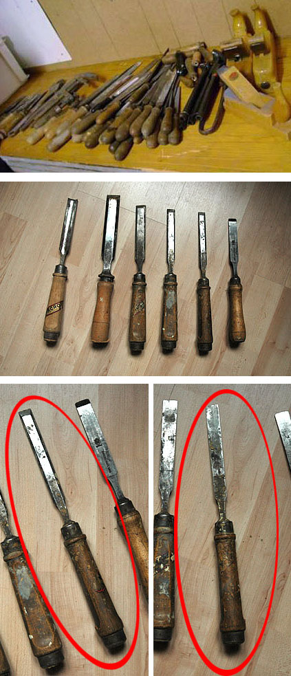

Some weeks ago I bought a heap of tool steel (my lifetime supply I guess) for 35 Swiss pesos.
here.

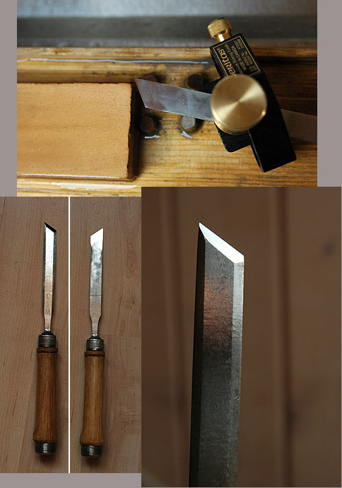

Shaping the chisel on a grinding wheel was done in a minute or two, no science or sophisticated geometry applied.
I quenched the shaped chisel in water, cleaned it and annealed it getting it to a yellowish color.
I gave it a mottled figure surface instead of an overall mirror sheen and sharpened it. It works as it is supposed to. Seems that I had luck with hardening and annealing. Everything was just eyeballed.
Yesterday I transformed the first piece to a usable chisel using the technique Jim described a few days ago I quenched the shaped chisel in water, cleaned it and annealed it getting it to a yellowish color.

Well Done Markus, I like resurrecting old tools too.
Re: Tool steel
Those 2 look great Markus. You've got a bit of work on all the rest of the pile. Looking forward to seeing what you do with some of the others.

Markus you bugga, now you have me wading through Ebay looking for cheap piles of tool steel
I like the way you left the front of the chisel with just that light pitting and bit of black rust. Some of my old tools are quite clean but maybe I should let them go like that.

No, there's no rust left. But it's hard to photograph "figured steel". The reflections appear 100% white and the shades 100% black, with not too many nuances in between.
I removed the paint, putty and rust on the blade with one of those tiny Dreml sanding drums, letting chatter it all over the blade. I decided I liked how it was left and not invest more time in polishing (lapping and polishing blades is my least favourite instrument building - related job.)

Rust?DarwinStrings wrote:I like the way you left the front of the chisel with just that light pitting and bit of black rust.

Ahh ok I see, I thought I could see what antique tool dealer call "patina" left in the pits. The black rust is really quite beneficial for preserving the steel anyway as it can hold oil very well, I have been considering bluing the fronts of all my chisels but have not made up my mind yet. I have a cabinet on the drawing board to house most of my tools that I have rust troubles with. I am tossing up between three methods, one is a hot cabinet like my de-humidification cabinet that uses a light bulb, the second is a sealed cabinet using VCI emitters and the third is what the gun dudes up here use, it is a sealed cabinet with a dehumidifier that you remove from the cabinet every now and then and plug it in the 240v which "re-charges" it and put it back in the cabinet to suck out the moisture. All this will be combined with wipe on coatings that contain VCI's. Rust sucks in the tropics.
