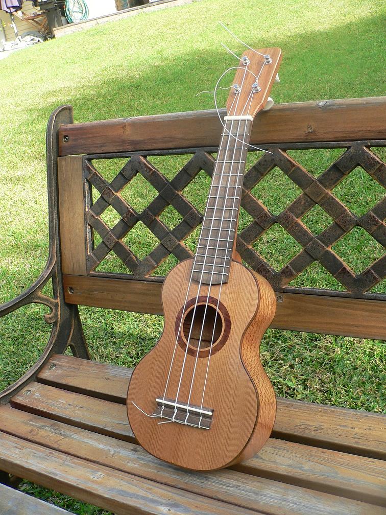

Post by Alastair » Mon Apr 18, 2011 4:56 pm
Good day All,
Following on from the assistance I received here, I have completed this build. While it needs some refinishing, and the strings to be tidied up after, I am reasonably happy with the result. As a non musician, I can't comment on the tone etc, except to say that the advice here was on the button, and working off a tuner, both the open and 12th fret show as true.
I'll stick the rest of the pics in the Build forum,
Alastair

Post by matthew » Tue Apr 19, 2011 7:19 am
Well done Alastair, that looks grand! Always like the look of silky oak and a sober binding. Does it go "plink" when you pluck the strings? If it does I reckon you have a winner!
