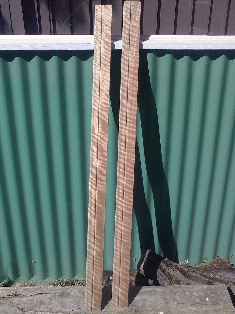

Yes Nick This Stuff I have is the same, I think my practice neck might just become THE NECK this meranti takes glue perfectly,is very light and very strong, has a nice figure, it also looks like it would take a stain well and around here is cheap as chipsNick Payne wrote:the variety I had was pretty light and had a nice wavy stripy figure

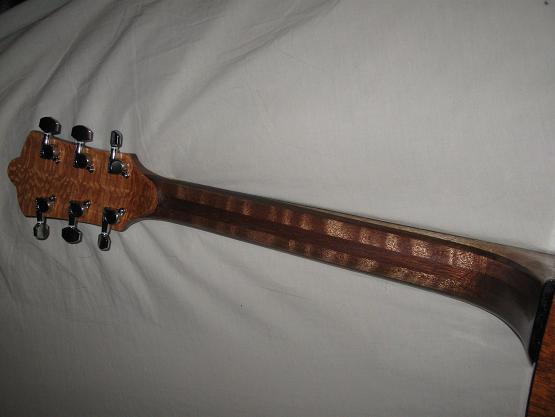

My eagle-eyed wife spotted a broken guitar out on the kerb-side collection pile a while back. It was an solid-topped Martinez with a snapped neck and a couple of other injuries. Anyway I eventually got around to making a new neck for it. It was my first crack at a dove-tail neck so I didn't want to invest heavily into something I was probably going to stuff up.
I laminated a blank out of three different scraps of Meranti and a bit of brush box I had lying around. Came out looking okay and so far seems stable enough.
