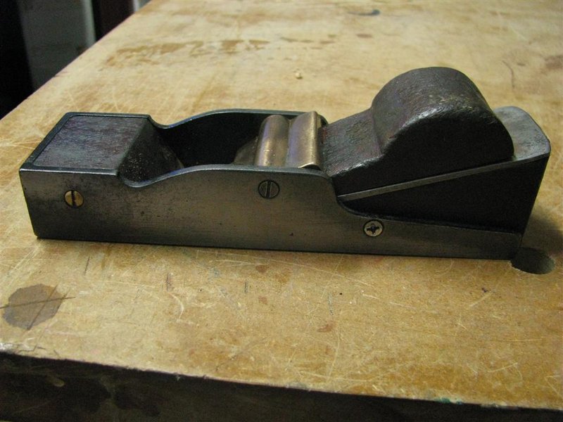

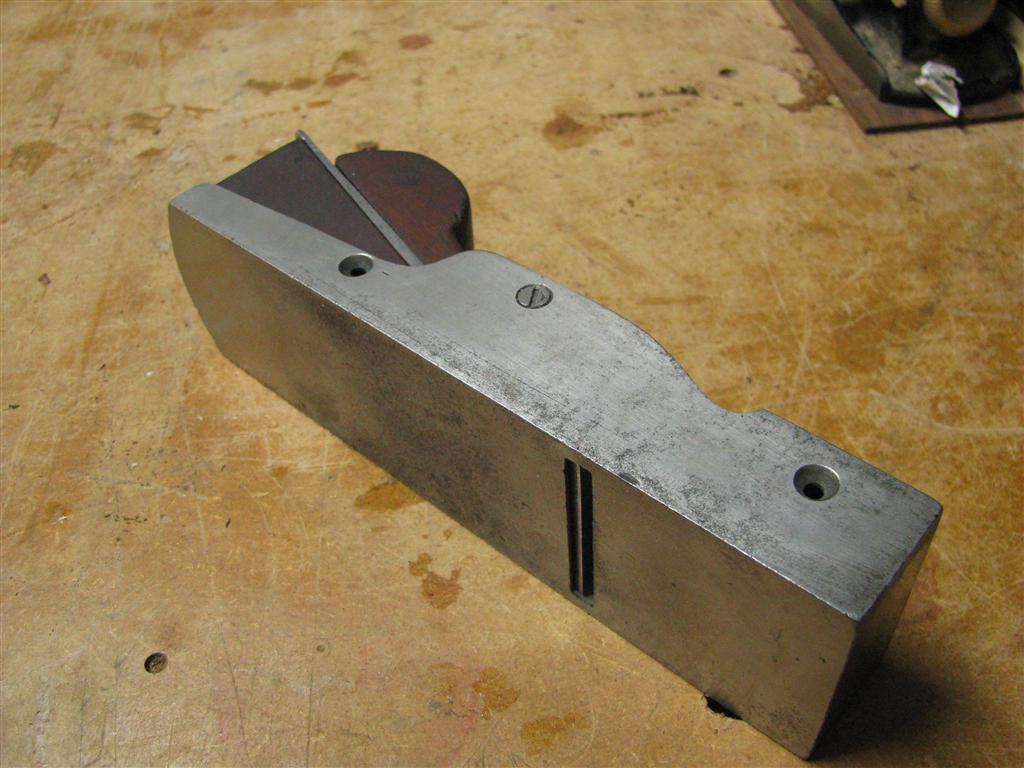

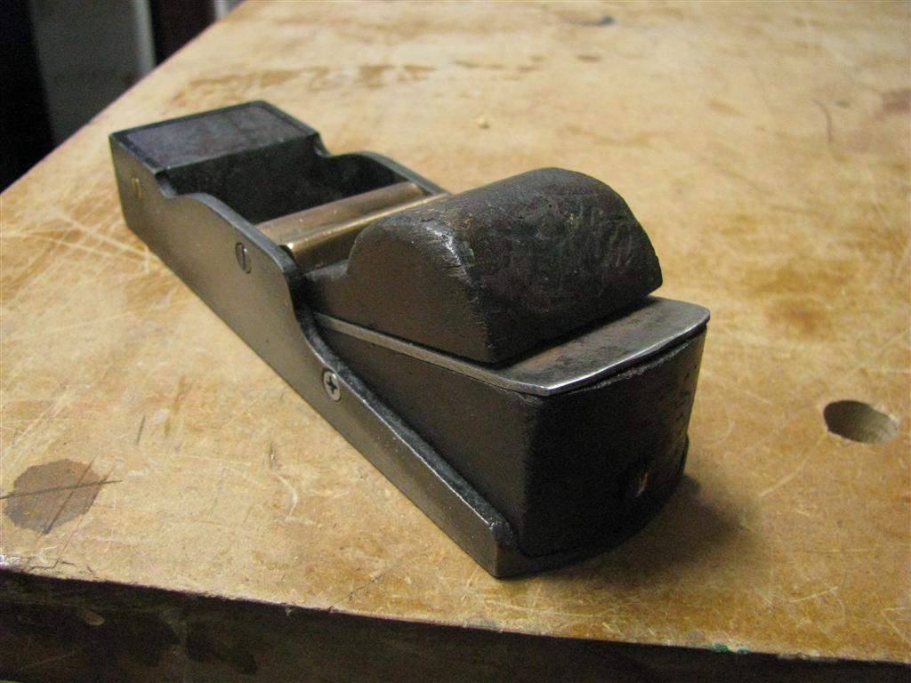

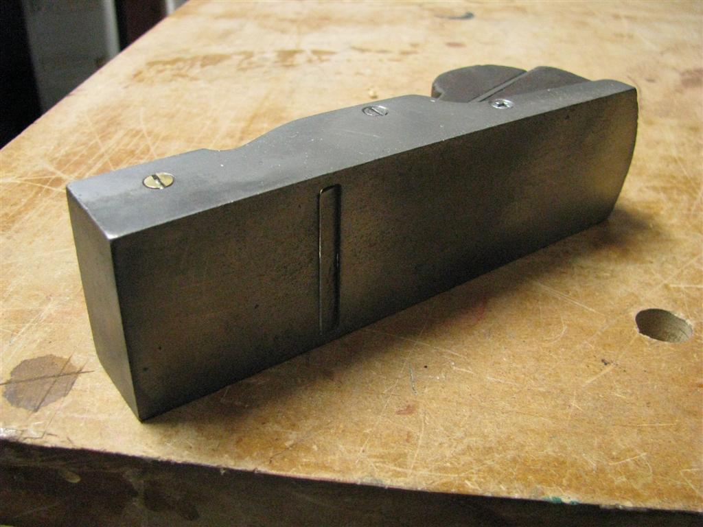

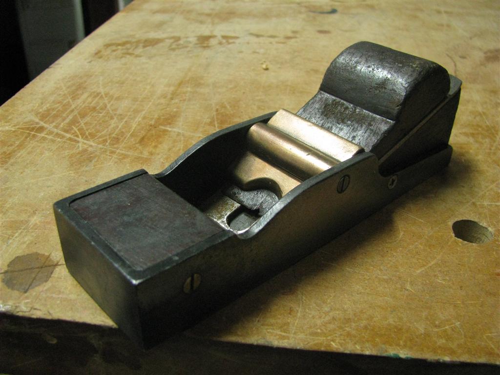

An infill block plane for $28 at the local swapmeet. No I didn't 'need' it, but it was there and needed some love and a couple of screws to get it going again :D
From the top of the heel radius to the tip of the toe she's all of 7 1/4" long by 2" wide.

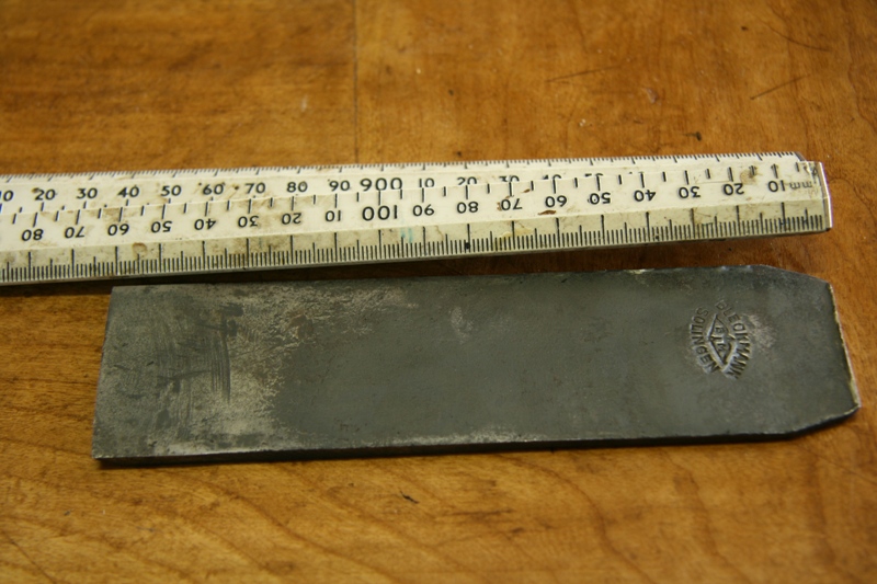

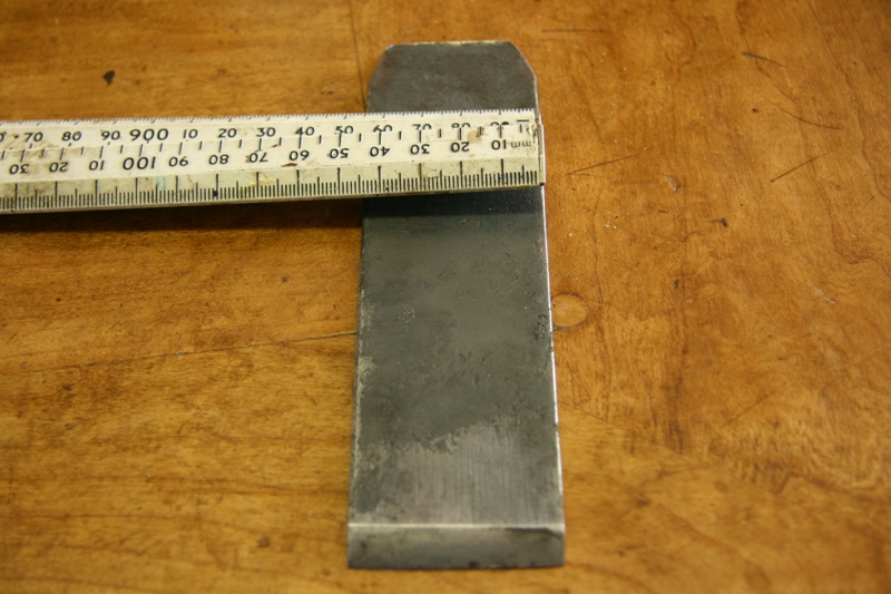

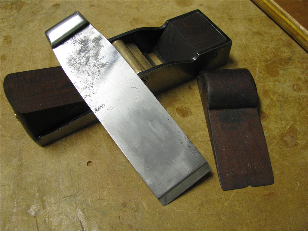

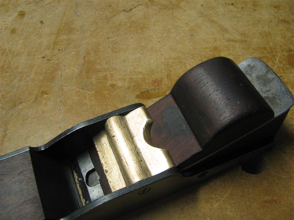

Its all there however the cutter iron is a badly converted Matherson from an old wooden plane. These irons have a taper which is not an overly good thing for the wedge fit of an infill plane. The blade had been roughly ground off on one side to fit the 43mm throat of the plane. The plane has been designed for a flat 1 5/8" iron with no slot.
You will not find a 6" slot-less 1 5/8" iron for love nor money these days, but Lee Valley have a flat slot-less 6" in either A2 or O1 steel for around $45USD...problem is its 1 7/8" so it will need a trip to the machine shop and that will add around $30 to the deal. Add shipping and the blade will be around $100 making this a $130 block plane...we shall see.

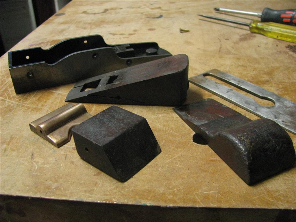

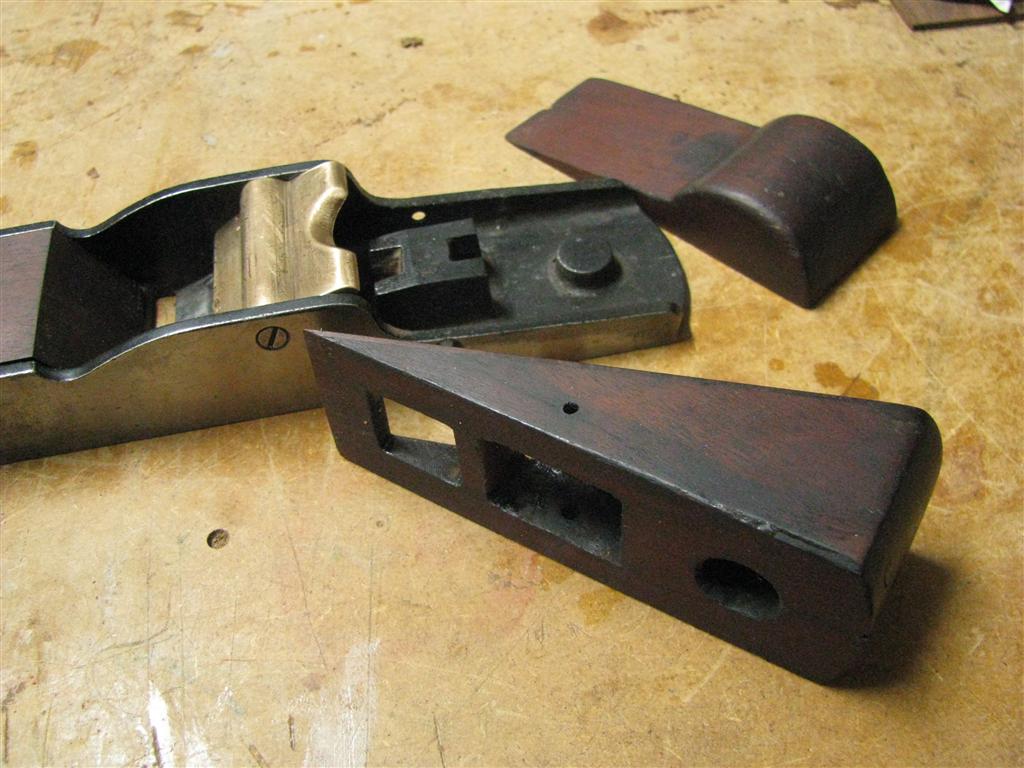

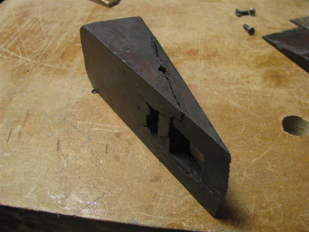

So here she is in bits...No the wood is not BRW. Its too lite weight and quite soft. It has the depth of old red brown mahogany however it also has very close grain...any guesses?

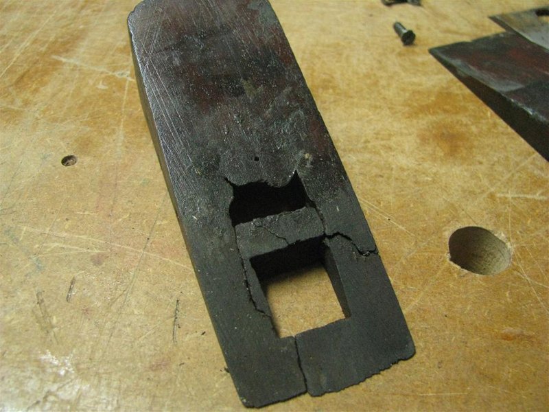

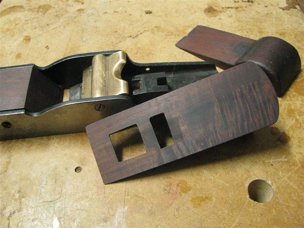

Here's the bed and its full of cracks and old PVA glue.

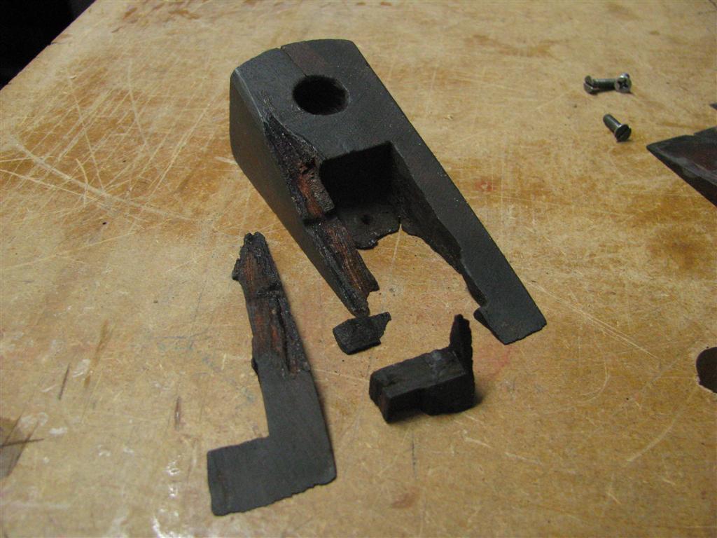

In fact it is split right through so with little effort....
It all came apart..revealing what a piss poor job has been done by who ever had a go at it before.
Yes it would be far easier just to make another wedge...........but the patina mate...what about the patina?? :D

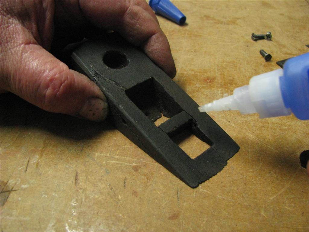

We have the technology....to rebuild it faster, stronger and more powerful....and still keep some of that old vintage mojo.

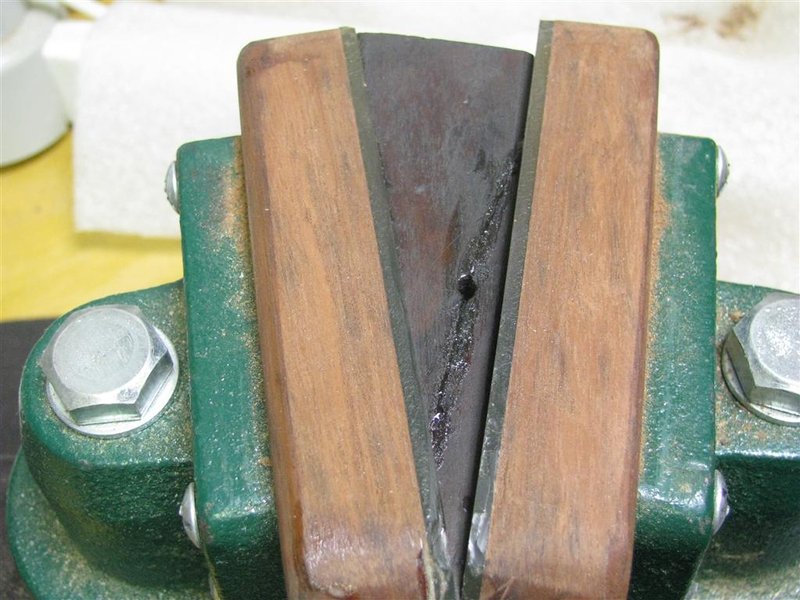

Glue and dust, glue and dust.

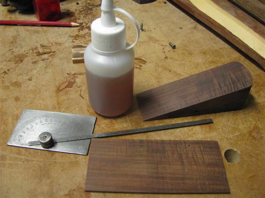

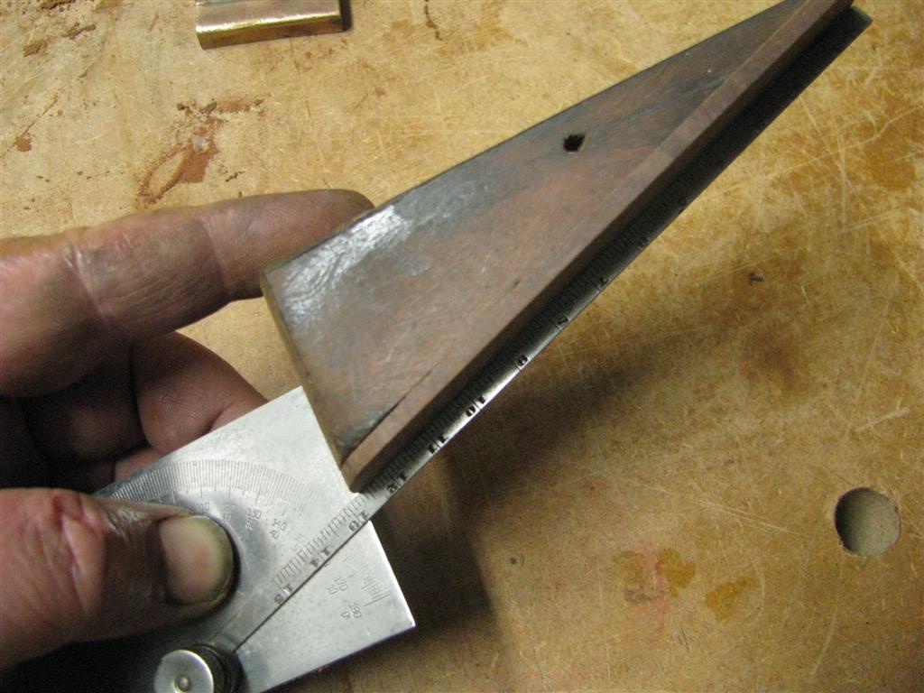

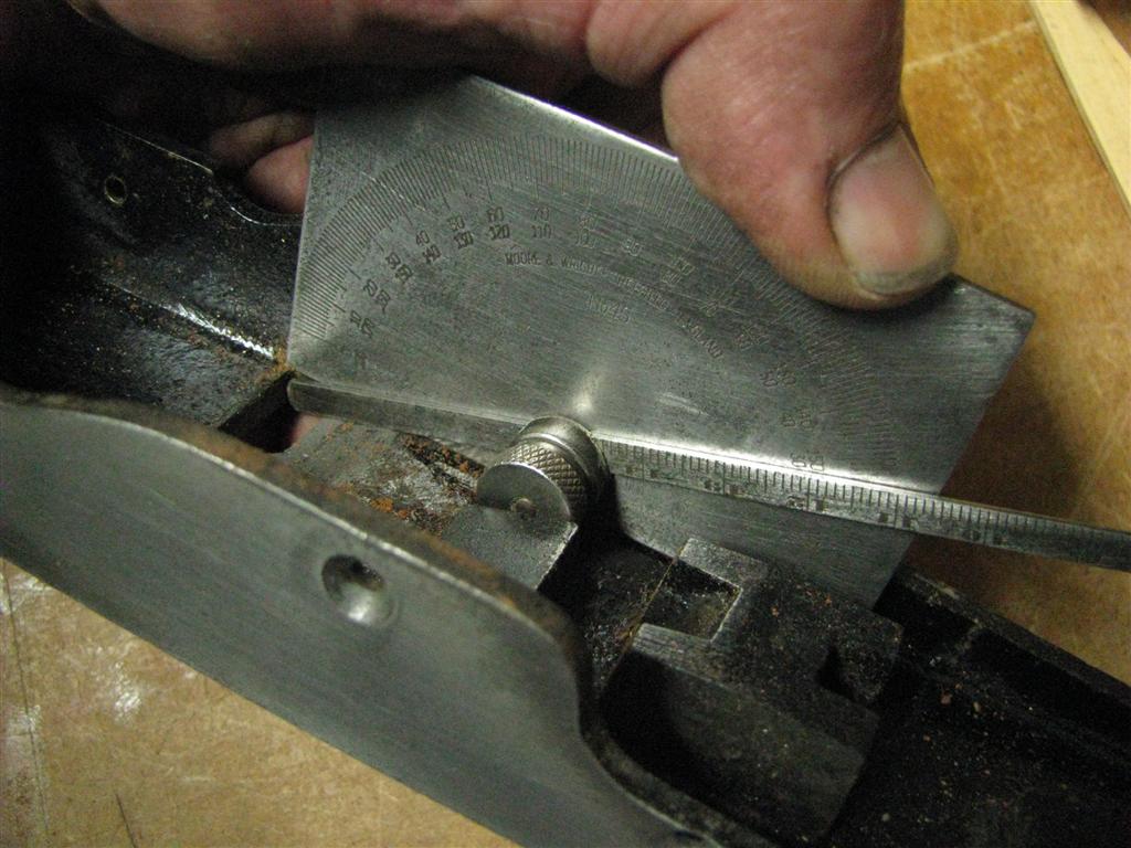

Next determine the 'correct' bed angle from the metal work of the plane...The last bloke had this way out, he must have sanded to clean up and gone too steep leaving the blade only supported at the leading edge of the throat. You can't take away what is no longer there so the bed would need a veneer. But that is not such a bad thing as it will help hold all thoses bits together.

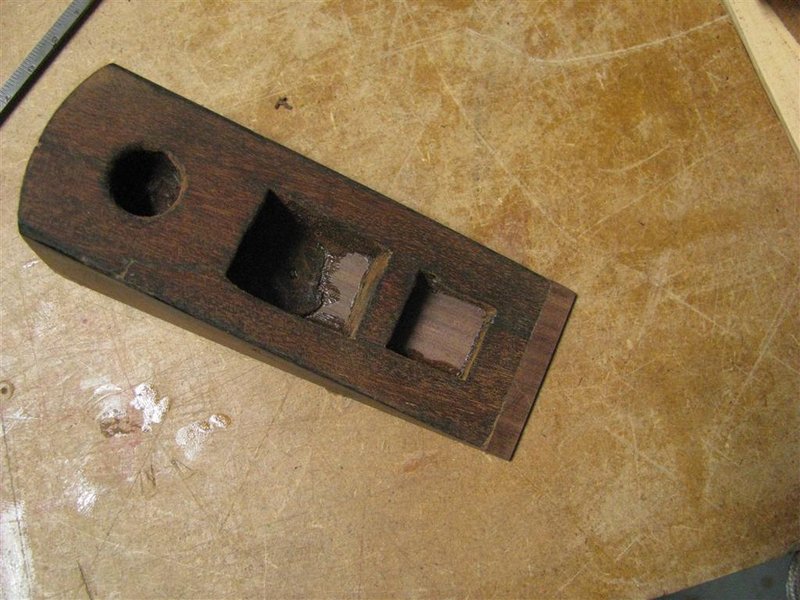

If you are wondering I chose some western mayall for the veneer. It is old stable wood with very fine grain and about the right colour match...besides I had a scape bit that was around the correct size sitting on the bench so it was a choice of the gods..and you can't argue with that.

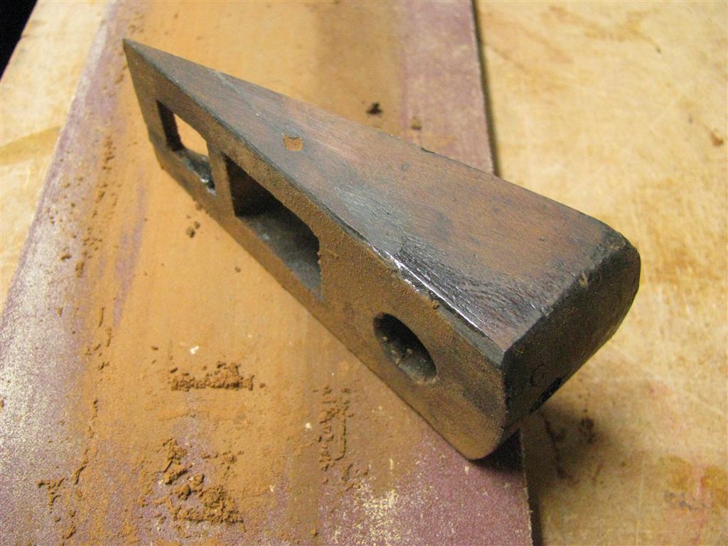

So here is the underside of the bed with the mortices blocked off by the veneer.

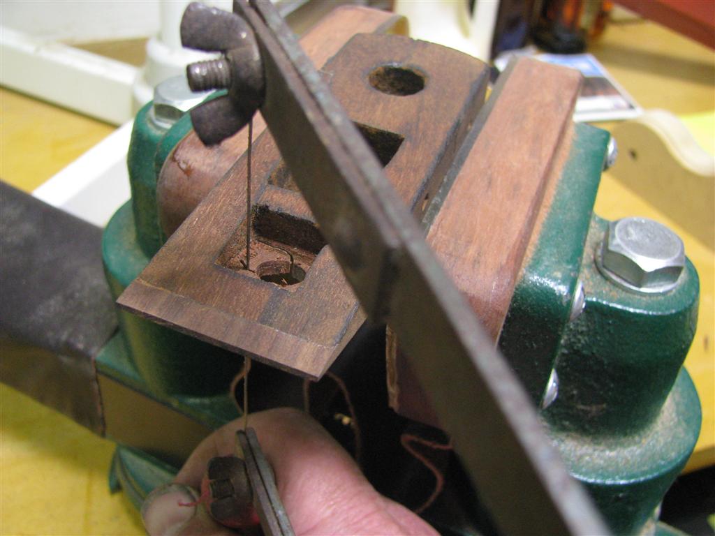

A drill and a coping saw to re-establish the mortices.

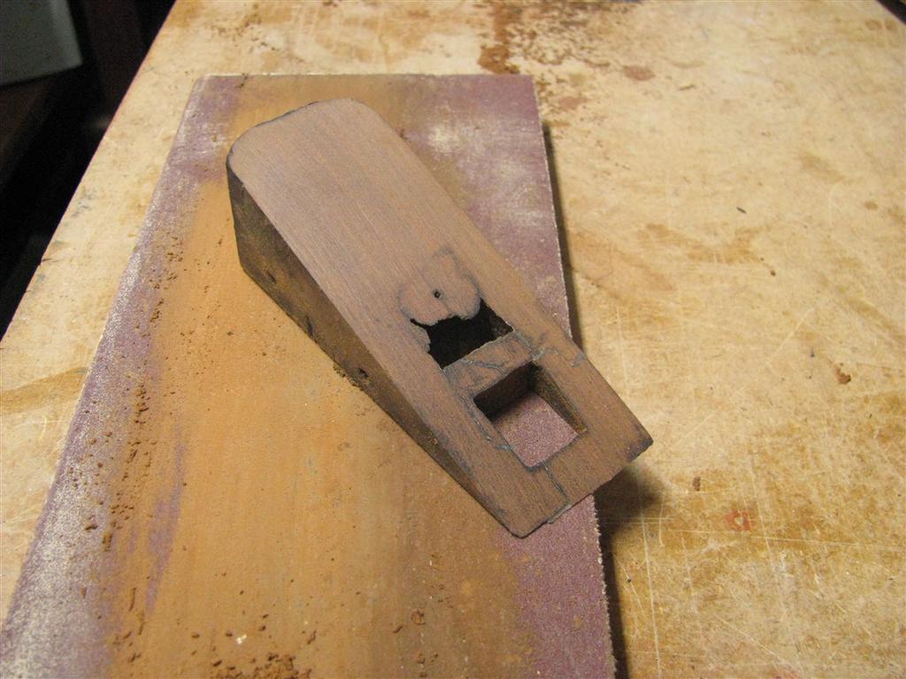

Reset the bed angle using a sanding board. Once done there will be little left of the veneer at the very back end of the wedge.
And with a bit of a clean, fill and blend...the bed is good again....sorry about the patina mate,
but even if this tool will end up just being an ornament...in my opinion it should still be able to work or else it should go in the bin.

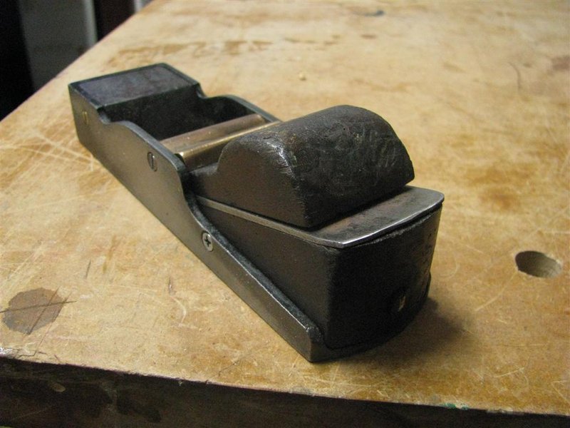

So here she is all ready and waiting for a new cutting iron...and some older style steel wood screws to fix the infill in place. Will need to have a scratch around and see what I can dig up.

Lill, I tried Ron Hock, well just the product list on site, and he has nothing I can see. I have also spoken with Paul of Academy Saws fame here in AU. Up until very recently Paul had been making all of the HSS blades for Terry Gordon, but he has nothing either.
The Lee Valley Blade I referred to is only $36.00 but its 1/4" too wide. Therefore it would need a trip to an engineering workshop to bring it down to 1 5/8". They would probably charge > $30 for the service so to include shipping from Canada makes the blade worth pretty close to $100. I have sent an email to Ron Hock but I was warned by Paul of Academic not to be too hopeful as their stock of 1 5/8" is very likely to be precut to 4" long to suit replacement of early Stanley block planes and I need 6.5" to make this work....so it may come back to the LV iron.

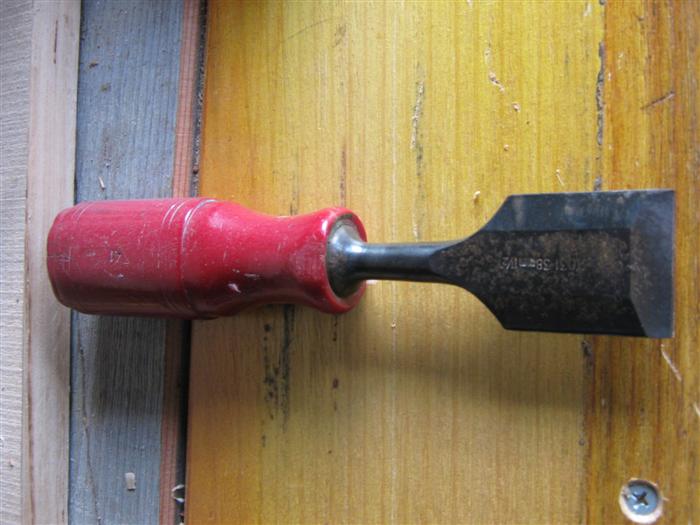

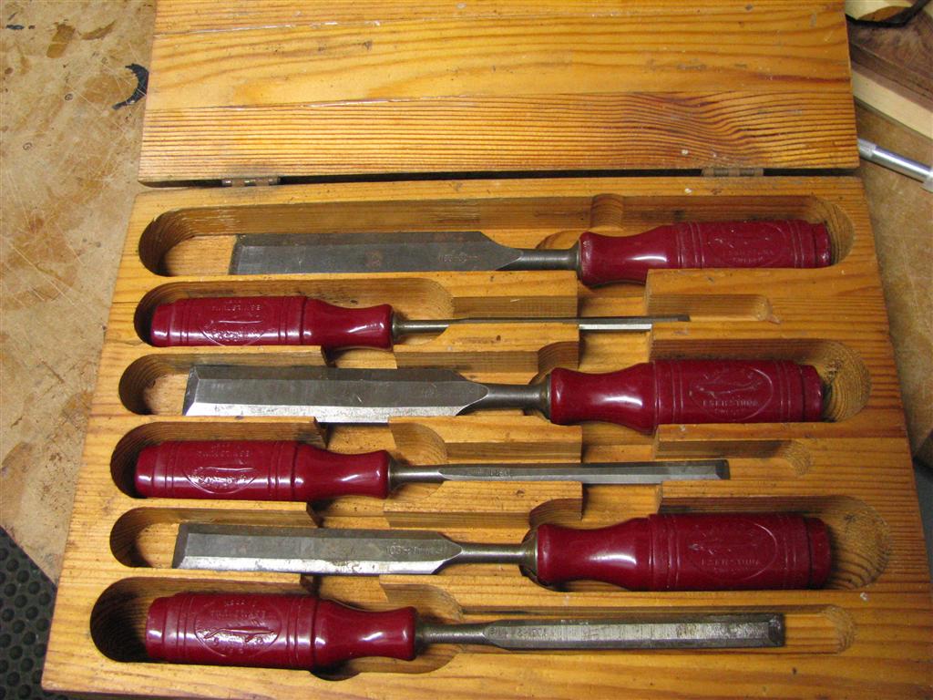

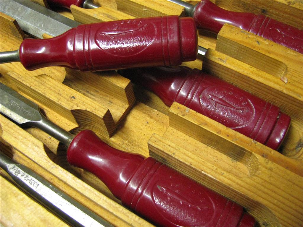

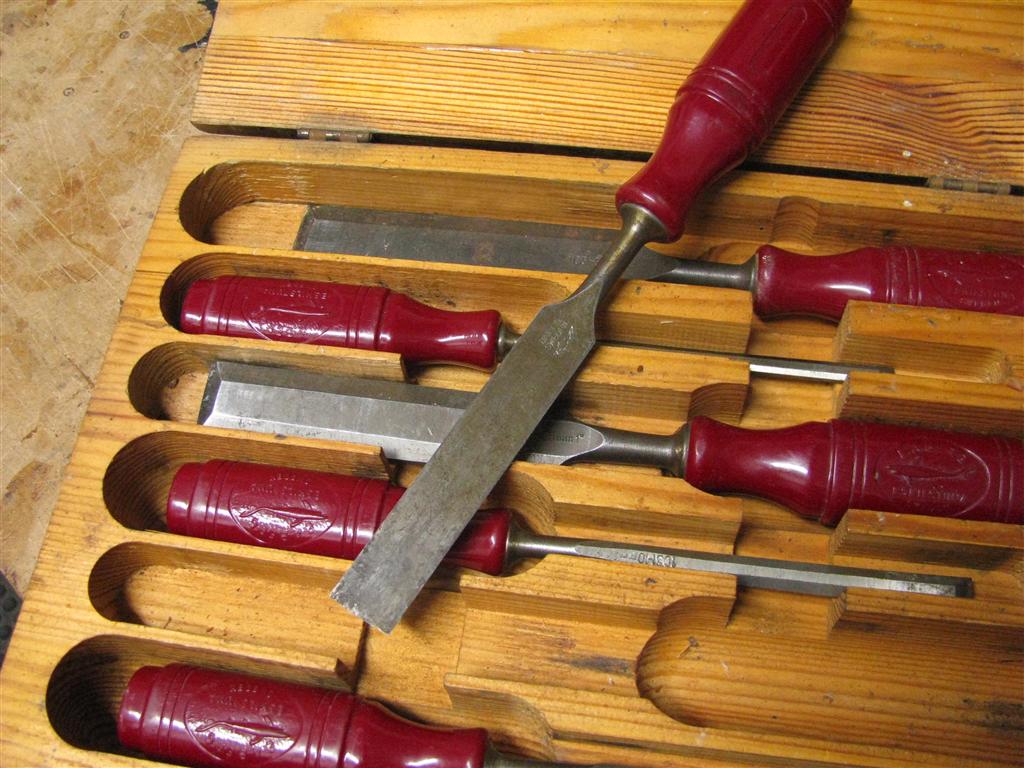

Wednesday arvo finished work and doing the kid pickup run from school. Drove past Cashies and could 'feel' the draw..Picked up my daughter and on the way back, for no other reason than the earlier feeling that I should do so, we stopped in for a look see....
The lid of the box had come unglued so I had offered the guy $40 but he said "No can do, they only came out on the shelf an hour ago"....I said ohhh OK, guess I'll take'em then :P ....I got home and re-shot the joint and you would never know it had been apart...the ugly repair you can see on the lid is not mine, it was like that so it will stay that way.
It is hard to see but the last image shows the 'yellowing' of original lacquer still on the blade...they are all like that, near 'as new' as you will get. Only let down, some tosser has at some time in the past used the largest chisel in the set, the 32mm, as a lever and in doing so bent the shaft a little at the neck ... :cry:
Still, its all good. :D

Re: Tool Time
Post by kiwigeo » Fri Apr 15, 2011 6:06 pm
(looking at Cash Converters label)
"Red Handel".........didn't know Handel had a Russian brother who made chisels :mrgreen:

Post by rocket » Fri Apr 15, 2011 6:16 pm
I'll swap ya Kim,,,, i've had this one from new, reached it's use by date now though.
Cheers ,,,,,, Rod

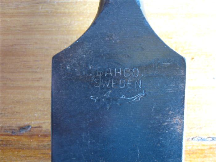

I just lifted the story of EA Berg quoted below from here: http://straightrazorplace.com/razors/26 ... story.html
Read on and it will explain the Bacho stamp and quite a few interesting things about the company.....
I got this in my email compliments from some of the people over at Bahco, it has a short history of the manufacturer EAB. Helps to date some of their razors and get an idea of how they were made.

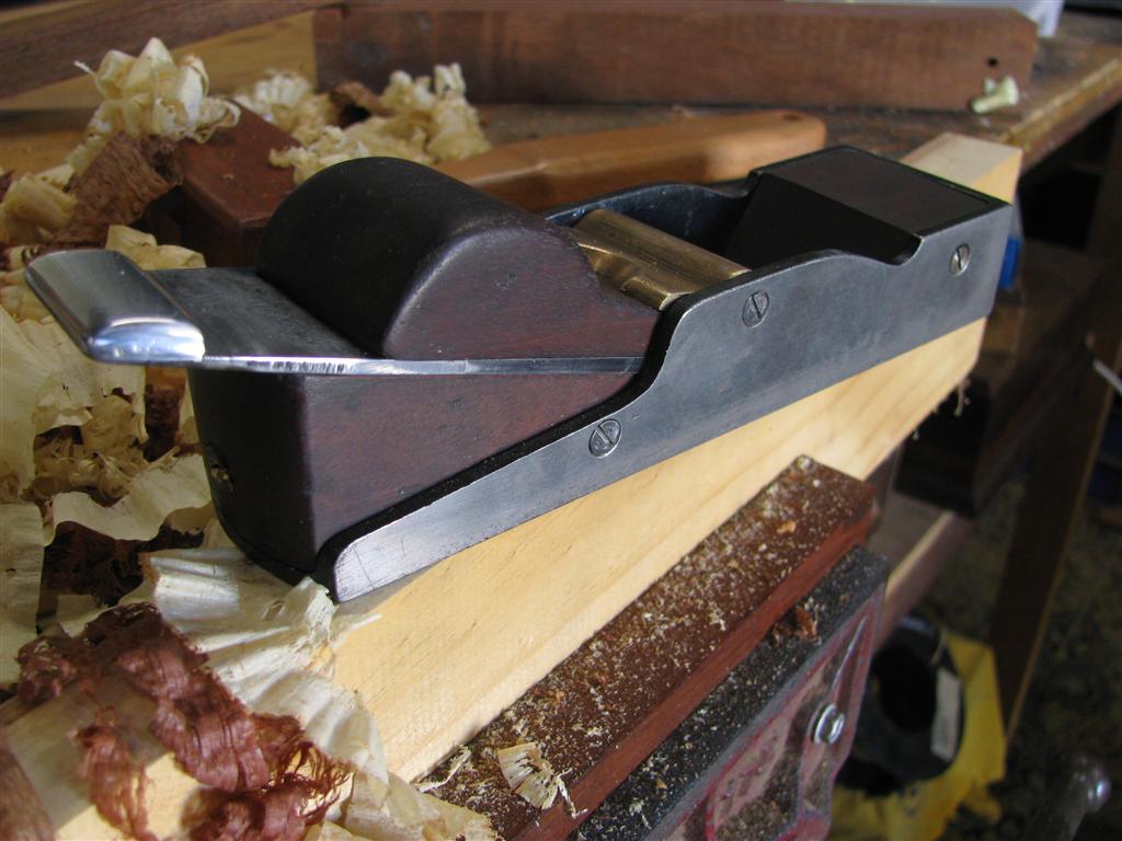

Filling you in on the infill..
Post by Kim » Fri Apr 29, 2011 3:58 pm
OK and update on the infill plane:

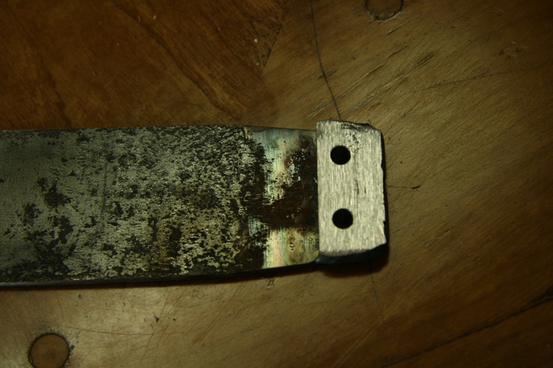

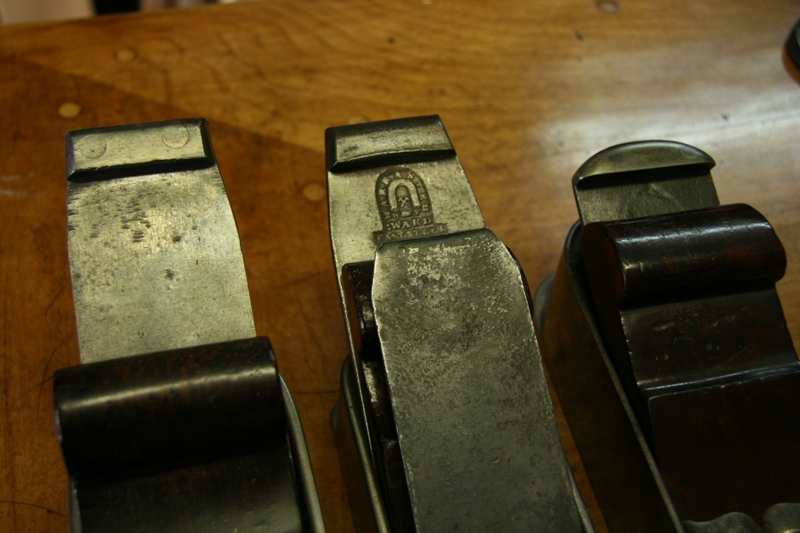

When I last posted about this little plane I was still procrastinating about whether on not to spring for the cash and buy a new iron from Lee Valley and then pay to have it machined down. It probably would have meant an over all investment of >$100 just for the cutting iron and the reality is that investment would have only resulted in yet another good functional plane, the size of which I already have in the arsenal. The other down side to the LV iron was that it would have stood out as 'new' killing the look I was able to maintain by salvaging the original bed and wedge.
Well a short time later I received a PM from ANZLF member Auscab (AKA Rob Brown) letting me know he has an old slottless iron that should do the trick if I was interested. Not only that, but for a small fee Rob offered to grind the sides so it would fit the throat of my plane and would also 'sneck' the back end of the iron so it would fit with the infill look and function..I was to discover that snecking is a process that requires riveting and welding of a slug of steel to the very back end (unhardened) portion of the iron, I assume this is to allow the iron to be adjusted in depth of cut by tapping the sneck with a mallet while under load from the wedge, the sneck is probably shaped the way it is for comfort when the plane is in use... (Sneking...now there's a term you don't hear every day..prior to Rob's PM the only snecking I had experienced was in the back of my XR Falcon with the squeeze after a snix pack or two)
Some examples of snecked irons:
sneck a.JPG (160.65 KiB) Viewed 31853 times
The iron: :D
iron 1.JPG (188.22 KiB) Viewed 31853 times
iron 2.JPG (190.41 KiB) Viewed 31853 times

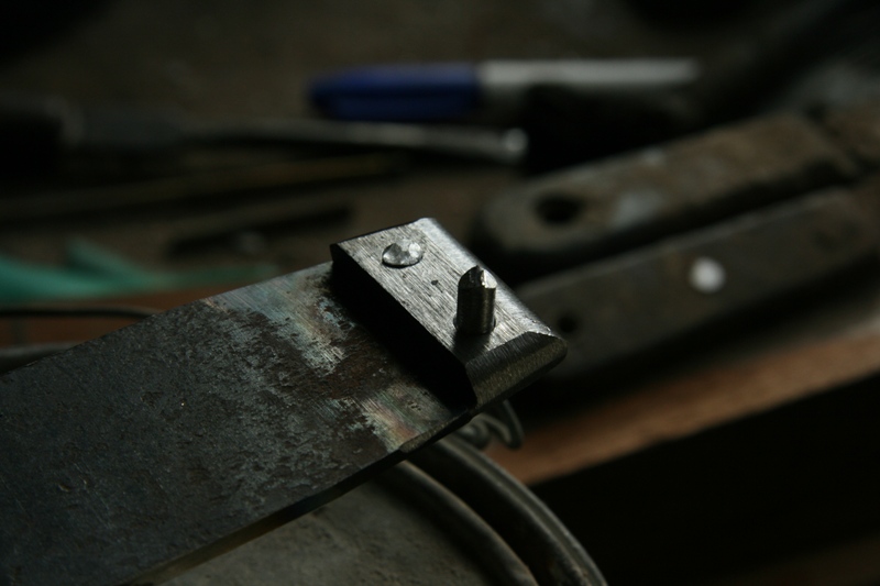

So a deal was done, Rob would grind and sneck the iron and send me images when done....
The snecking:
sneck 1.JPG (198.31 KiB) Viewed 31853 times
sneck 2.JPG (115.25 KiB) Viewed 31853 times
sneck 3.JPG (176.87 KiB) Viewed 31853 times

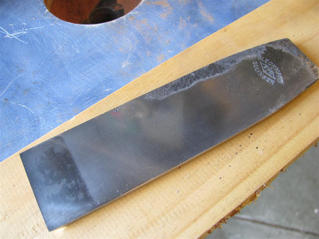

So with the iron now snecked Rob put it in the post where it was allowed to matured over the extended Easter break until I picked it up yesterday. I got to work on it yesterday afternoon and ...laaaaate..last night dressing it up and lapping it in to finish the plane. The sides of the iron were ground as per my specs so the first thing was to take just an ant's dick off the sides so it would fit the throat just right...I used a 40mm Norton 'Bluemax' grinding wheel on the 8" bench grinder. I really like these wheels as they run super cool and give quite a fine finish, so with a few quick lite passes the job was done.

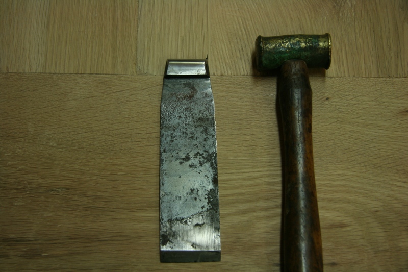

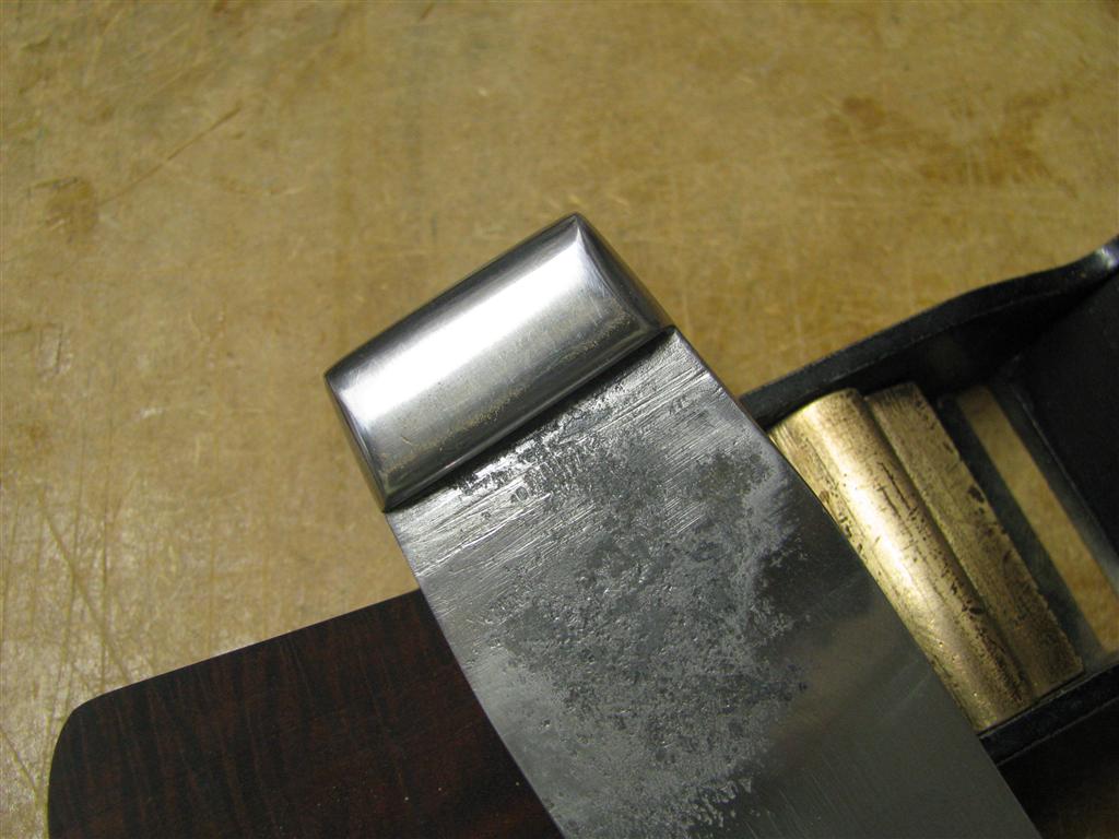

Next I lapped the back of the iron working first on the linisher/belt sander (the snek made this job a breeze because it doubled as a handle saving the fingers and allowing good control of the grind) and later through the grits on the 10mm plate glass. I am sure that I did not 'need' to lap in as much as I did however the thought behind getting the iron as flat as I could was to provide as much surface area as possible for the wedge and bed to hold the iron securely whilst in use...
Here is the back of the iron lapped in, honed, and ready to go:
The plane ready to assemble showing the top of the iron cleaned up and fettled with wet and dry:
A closer look at Rob's great snecking effort:

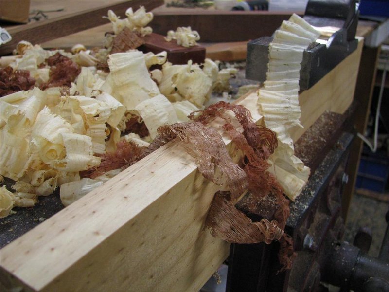

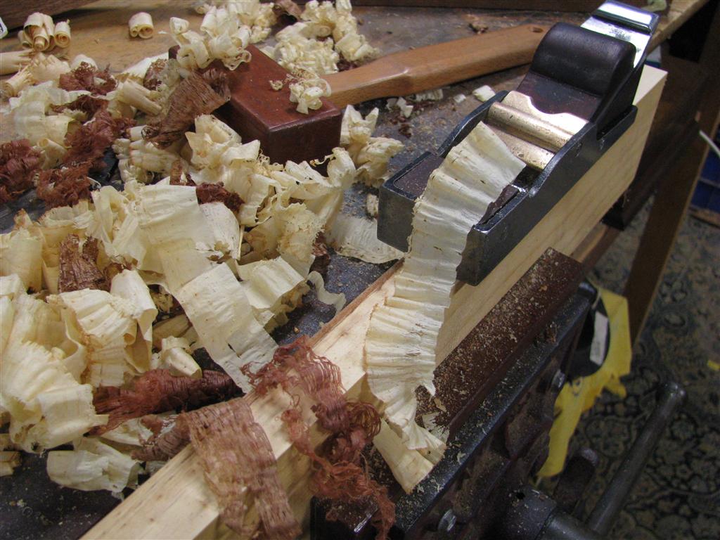

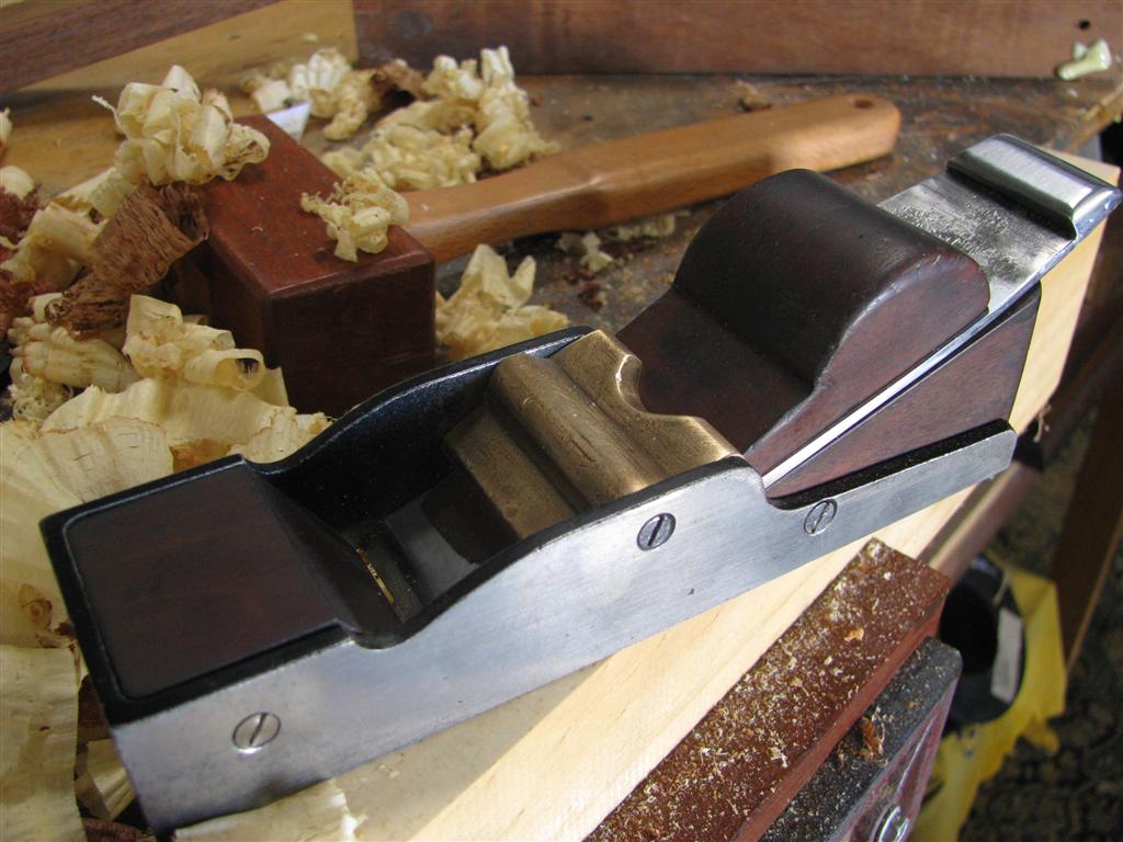

Ah! But does is work I hear you ask???
Indeed it does :D
In this image the shaving closest is mahogany, next is jarrah, and of course radiata is curling from the plane itself in the background.

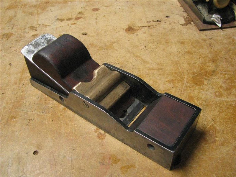

And here she is all done and look'in fine and dandy:
A HUGE thanks to Rob and the ANZLF because without them both I would still be procrastinating :lol:
Cheers all and thanks for looking
