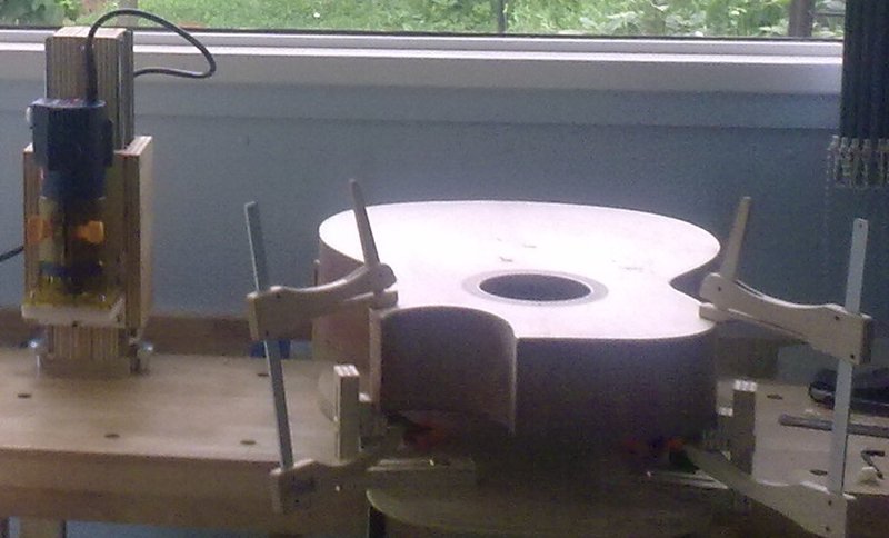

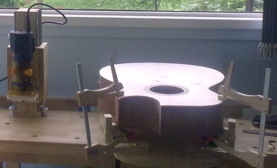

Post by Clancy » Wed Apr 27, 2011 1:25 pm
Here's my home made job.
Some drawer slides, cabinet bolts, T-nuts & ply.
Total cost for "tower" & "cradle" was less than $25.
(In the picture the clamps were just holding the guitar in the cradle while I scraped the top.)

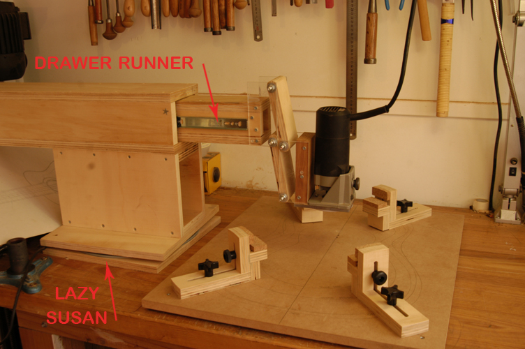

Post by J.F. Custom » Fri Apr 29, 2011 12:15 am
woodrat wrote:Hi Jeremy, Thanks for the reply...yes if you can post a pic of yours that would be great.
John.
Sorry for the delay John, particularly busy at the moment.
Managed to get a couple of shots today though so here you are. It should be pretty self-explanatory from the pictures.

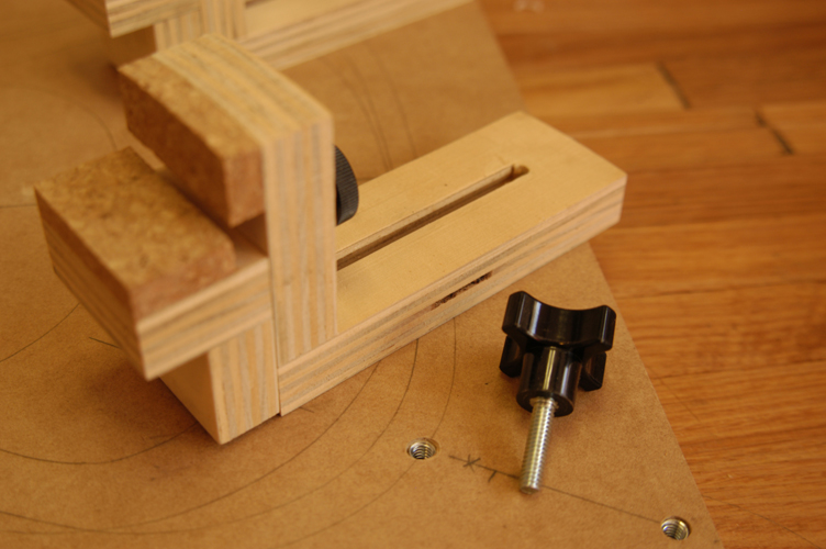

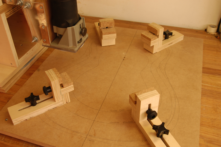

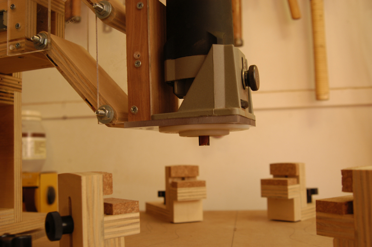

It uses the same style of guitar cradle the Stewmac setup does, the main difference being the guitar once mounted stays stationary and the router arm moves around the body. This is facilitated by both a 12" Lazy Susan bearing in the base, and some quality drawer runners in the arm. The router is mounted on the end of that arm in a parallelogram setup which allows it to pivot up and down while maintaining right angles to the bench - or guitar for that matter. The whole unit "glides" three-dimensionally effortlessly. Note the "slippery" plastic nut under the router as a sub base, that is slightly radiused. This material slips on the body with ease and helps you to maintain a more stable depth irrespective of the radius of the back or top. It is a comparatively large jig it's true, but I have inserted a large threaded bolt in the middle of the base plate (between the two bases where the Lazy Susan is) that goes through a hole in my workbench. This accepts a large wing nut under the bench top to hold it firm so it is easy to secure when needed, then remove and store up on a shelf when not required.
The cradle itself I've found useful for other jobs too but I modified mine slightly. I drew in rough guides to a range of instruments I make on the base. I then used threaded inserts mounted from under the board placed so that my adjustable brackets have enough adjustment in them at either of the two positions to hold any instrument I need. It is simple and quick to adjust and lock down this way and the rough drawings allow me to "eyeball" set it up for the instrument about to be worked on, before final adjustments are made with it in the cradle.
Hope it helps.
