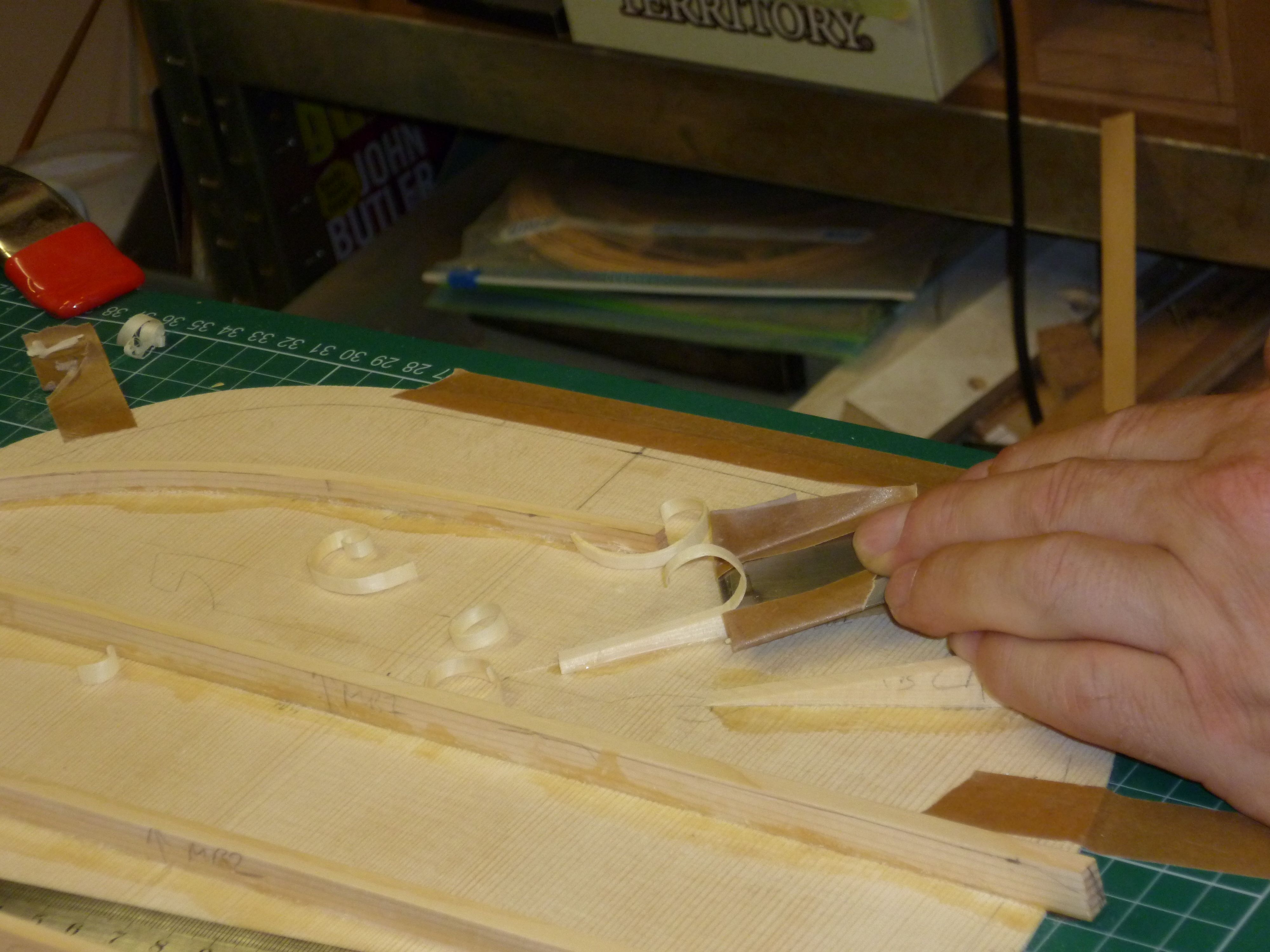

So here is the result
I cleaned up the cut as well as I could to get rid of the titebond. The I heated up the area a bit with the heat gun and wedged as much HHG into the slot as possible. For the caul I used a flexible steel 6inch ruler clamped to the curve
here it is glued
and after a sand with 120 grit on a block
Matt
