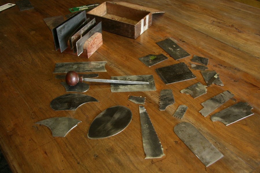

I've also got a selection of thick heavy duty ones ranging from 6mm wide to 30mm. They are actually tool steel sharpened for mini planes that I need to build one day. Held about 90 degrees to the job in the finger tips they just peel off things like cured epoxy pore fill and tidy up hard to get at corners etc.

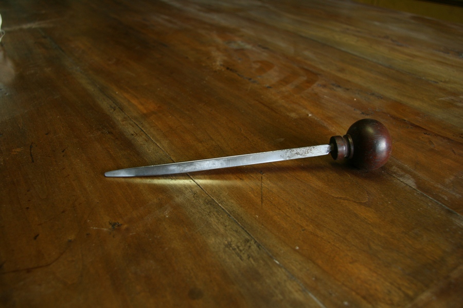

Very good ones can be made from old saws like old Diston's ,if you have an angle grinder with the thin blades,and a linisher or belt sander, I find not much flex is better. I make all my own ,
The best burnishing tool is made from an old file, you have to anneal it [ Make soft ] then file or grind ,then polish, then re harden,you could do it in a camp fire, I have done them in the wood heater at work, and oxy and acetylene is the fastest,these are way better than the back of any tool.
I can go in to more detail if you were thinking of going down that path
After filing them they should be finished on an oil stone , the more polished and square the better
Rob
Rob

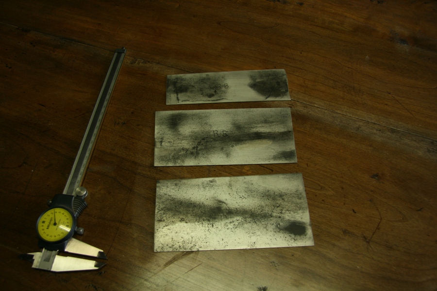

Just measured the thickness of the stiff ones that I think do the best on flat surfaces, all 1mm.

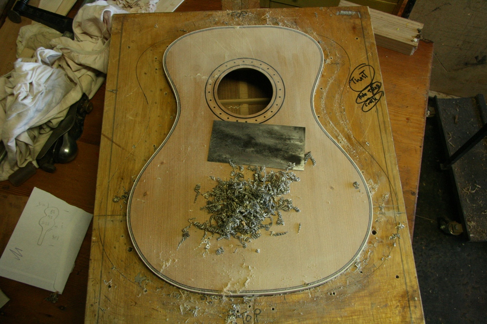

The thick ones are good for leveling off the top peaks left after hand planing of flat boards after it has been planed with a smoothing plane with a slight curve in the blade,this leaves slight peaks which are taken down with the scraper kept 95%to 98% straight, and for taking down purfling and binding flat and level with sides, they are a tool for making things flat
A more flexible one would be better for taking out stains or dents but you have to watch you blend it in with the rest other wise it shows up as a dip when polished ,scrapers usually dont need to be bent as much as the Carbatec picture
The curved ones are good for getting scorch marks out ,specially on the inside, the concave curves ,good for the neck shaping.
Once you know how to sharpen one they are great but the sharp part of the blade is usually good for about ten to fifteen shaves, it starts to dull and you use the blade to the left then the right and then flip it and you have three sides left . Flat blades can be filed then to a stone, but the curved ones I just do on the linisher ,that creates a burr that works but it's a little jagged
The ones with the handles would be easier on the hand muscles,but when the blade goes dull they are a fair bit of a fiddle to re do and set up compared to the life you get out of the hand held one, plus they are ground at an angle first, same as a plane blade [? I forget the exact angle ] then a hook is formed with a burnisher,
cheers Rob
cheers Rob

I have an old Bahco. You can't find them in the US anymore. I also have a set of Lie Nelson's and a couple of Lee Valley's. I can't say I like one more than the others. Why so many? So I don't have to stop and sharpen them when I'm doing something.
As far as thick or thin goes, I have both. I tend to use the thicker ones in the Veritas holder and the thinner ones by hand. I have issues with my left thumb and can't hold the thicker ones and flex them. The holder works nicely. If my hand is really bothering me, I'll use the thin ones in it as well.
As long as the scrapers are made of good steel, your sharpening technique is what will make them a joy to use or the reason you never use them.

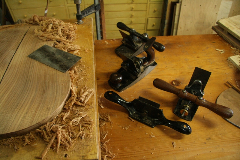

Re: Scraper Blades

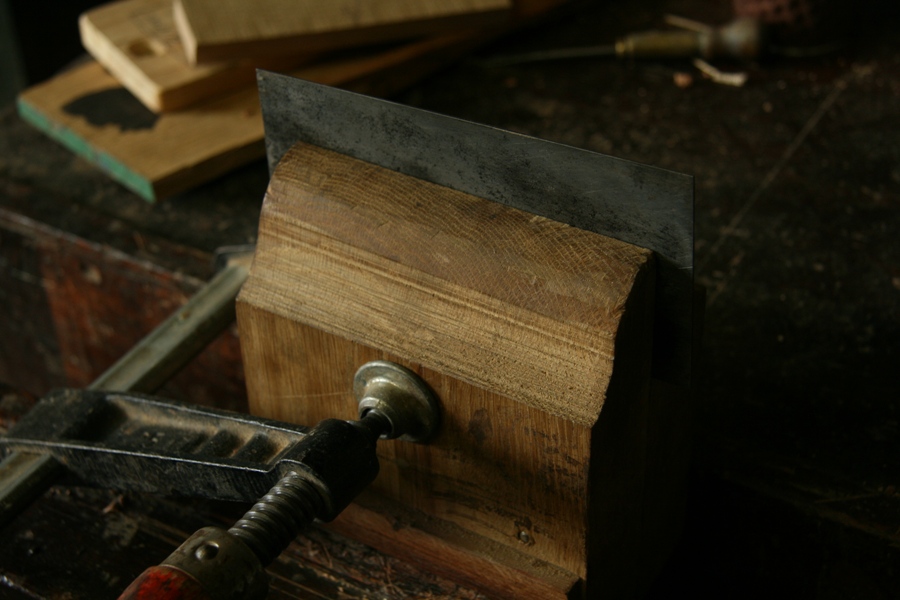

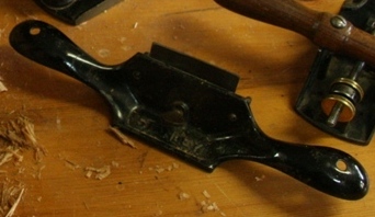

Just did a check on the stanley 80, the blades on these are ground to 45 deg ,honed , then the hook is formed with the burnisher,
It may be that to grind a curve on the end of a rectangular scraper, and then finish it same as above ,you could get an easy to handle long scraper,that would be better for a soft wood, I'm thinking of the inside of your top. I dont know if it will be better, could be worth a try.
The normal sharpening of a scraper is not as good for soft woods as it is for hard woods, may be fine for tone woods ? but not on a lot of the standard building softwoods,
Moulding plane makers used to change the bed angle of the plane depending on whether you were working on soft woods or hard woods , joiners mainly moulded softwoods and had the common pitch at 45 degrees , cabinet makers moulded the hard woods and the bed angle was 50 to 55 degrees
cheers Rob
cheers Rob

My favorite burnisher is the stem of an old cylinder head valve....hard, smooth, shiny and freely available for nothing from any engine recon place and they work a treat.

Yes, a good burnisher is simply smooth hardened steel - harder than the scraper you want to put the burr on. As Waddy says, many of the old screwdrivers are perfect. I don't see the point in buying a burnisher designed for the job - I'm sure they work well, but given that many items already in your workshop are likely to do the same, there seems to be little point.
Franks comment on the LV adjustable burnisher is different though. That allows you to "dial in" the angle of the rod, in this case tungsten carbide from memory I think, allowing consistency from one end of the scraper to the other, as well as whether you want a shallow fine cut, or a heavier burr for more aggressive work. The bonus is if you find you like particular angles for particular scrapers you have in your sets, or specific jobs, you can also re-create the same angle edge easily. You can simply stick some masking tape on each tool and write the preferred angle on it to remind yourself when it comes to sharpening.
Doing it without one is not overly difficult though.
