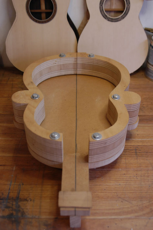

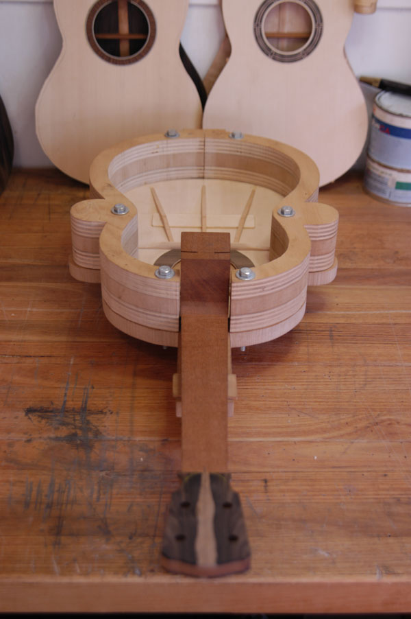

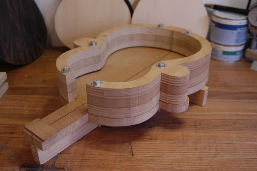

I modified both ideas into one unit - A solera/mould in one. This way, either build style is possible so far as neck construction is concerned. I feel it gives me the best of both worlds and is still very flexible. Even if you want a different body shape as a one off, the sides simply lift off. This is a Tenor Ukulele model. The base - solera is dished to a 25' radius and the sides have a small 5mm x 3mm rebate on the edge to allow the overhang of the soundboard to tuck neatly under. The little wedge on the neck extension sets the neck at the correct angle. There are internal blocks for the mould too (not pictured), that maintain shape should there be any spring-back in the side bending. The side moulds are held by bolts with wing nuts and removal of two will allow the sides to slide via a groove, back or forth (in or out) if desired. Anyway, a picture is worth a thousand words.
If you have any questions, let me know. Otherwise, I hope it helps.

Jeremy, impressive stuff, your set up is excellent.
I think I'll attack this without a mold and see how I go. Will probably make a mold down the track.
Cheers, Jason
