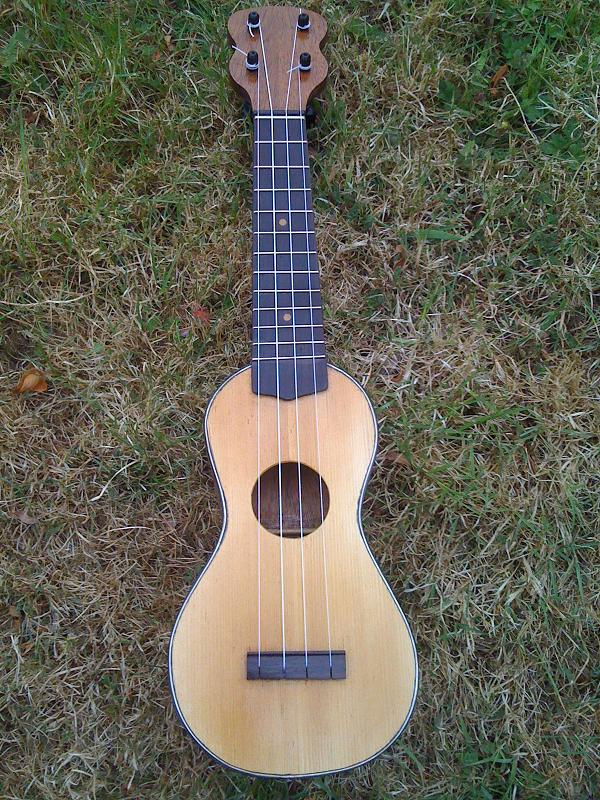

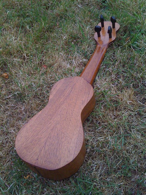

Just finished this one, based (very loosely) on an 1890s Dias uke. Note the asymmetries - these are not in the original, but down to my ham-handed building. Even so it sounds nice and plays well. I don't think there are any plans for this kind of shape, but it really isn't difficult to design for yourself.
The other thing I like about ukes is that you can recycle old wood. For this one, top = dead grand piano, body = discarded shelf,neck= wardrobe.
