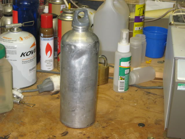

As for easy handling and to prevent contamination from exposure to air, I decant shellite and metho into aluminum fuel bottles used by back packers. Mine are Swiss made Sigg brand and are really good, but unfortunately no longer made by that company as they are not a pressure container as has become so popular with MRS stoves. But there are other Sigg knock offs much cheaper than the originals.
The feature to look for in any of these bottles is in the cap. It has two holes drilled on opposite sides of the plastic thread not far below the seal. The smaller of the two acts as a breather and the larger of the two, indicated externally by a dot mark in the molding, acts as a spout. When you want product, you simply loosen the cap about half way and then pour an easily controlled flow from the spout without excessive exposure of the product to the air. This is not only good for the products shelf life, it conserves the products because you only take what you need instead of glugging it all over a rag, and because the bottles are aluminum or stainless, its no real hazard if you drop or knock them in the work shop and the loop in the top makes them easy to hang up and out of the way.
Just a warning, a lot of these bottles are lined inside to make them suitable for drinking water..I am not certain that some fuel would not react with this lining. My old Siggs are fuel specific and are not lined, I would recommend looking finding a knock off that is unlined and if the cap does not have the holes, drill them.
Here is an image of a Sigg 'fuel' bottle I found on the net....note it is plain ali so you know its for fuel, I painted mine red for shellite and blue for metho...you can see the dot mark on the lid indicating where the pour hole is located.
