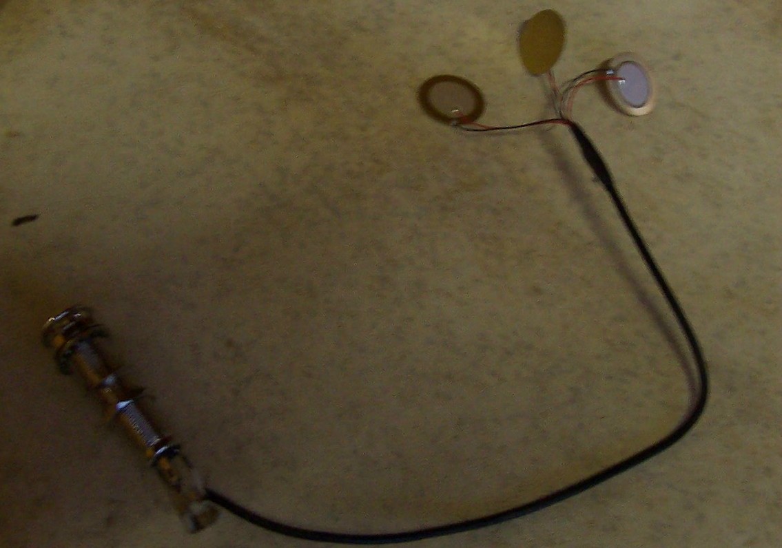

Got more instruments needing pickups than money so
Strap button output jack $5, 3 by 20mm prewired piezos at 75c each.
Recyled hookup wire from an audio cable.
Done
Seems to have the same output as a K&K and a pretty natural sound.
Done

The flash prewired ones, they are cheap enough.
Thick CA to glue them to the bridgeplate under the saddle location
I did them like the K&Ks with a cardboard template with dowels through the pin holes and the piezos held on with bluetac
I did the three at once rather than one at a time.
I just wired them in parallel so all the red leads together and to the core wire, and all the blacks to the ground shield and hence to the appropriate terminal on the end jack.

Just a headsup for anyone considering trying this out for themselves. If you have not fitted a set of K&K's before, make sure you follow their tutorial for fitting them as Jeff has suggests.
I tried this same thing years ago and wrote the idea off as a waste of time. This is because the guitar I fitted them to ended up sounding all trebles, average mids, and piss poor bass. At the time I put it down to the cheapy peizo disk having limited response to low Hz....This experience put me off even considering trying out K&K's for a long time. But with all the good press from so many people I weakened and bought a set of pure and westerns. When I fitted them, it was a revelation...not just the 'sound' but the method and the understanding of 'why' it was so crucial to fit these things properly.
I'm now very confident that the only problem with my first home made attempt had been how I had fitted them
These things really do need to be precisely placed so they sit 'directly' below the saddle slot, with each one positioned on an imaginary line that would split each pair of bridge pins E+B, G+D, A+E...take your time to do this properly and the result is a very even and natural sound that is very hard to beat IMO.

Definitely no problems with lows and mids on this install Kim
And it is on my Baritone tuned to drop A so issues with lows would be apparent.

I am no electronics expert Jim, so no designs for preamps from me.
The output is fine passive, just a little less than an electric guitar, but plenty to drive your average amp.
I have used the K&K's through existing onboard fishman preamps (or chinese fishman knockoffs) on client's guitars and that works fine.
As far as volume, I personally run through a pedalboard with volume pedal so onboard volume is not a necessity for me
