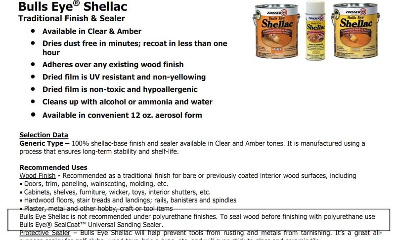

I was in the local art supply shop today and found a pre-mixed shellac - Bulls Eye Shellac- The brand on the can said it was by Zinsser, but when I went to there website www.zinsser.com, it came up as another site www.rustoleum.com.
Anyway, has any had any experience with this product? I read the specs on the site and it seemed like it might be ok - I was hoping to spray it on as I aquired a spay unit recently. This product seemed like it might be a good option as it is not to expensive and is a regularly stocked item in the store I visited.
I really have no experience with finishes so would greatly appreciate any imput.
Thanks, Paul.

Paul, your link does not work however the product# 245 in the URL you provided leads to Zinssers standard bullseye shellac that we discussed earlier so I am assuming you are still asking about the same product you had refereed to in your OP.
This product should be fine for a 'one product' finish and as a beginner you are likely to get far better results if you follow the basic process of french polishing as per the Milburn Bros tutorial: http://www.milburnguitars.com/fpintro.html. The Zinsser product details sheet has a dilution list to obtain the required "cuts" of shellac for the various stages of the FP process.
From what I can see the Zinsser "shellac" product is just normal, run of the mill, Indian shellac devolved in alcohol with some additive to slow down the polymerization process to 'extended' the shelf life to a minimum of 36 months from date of manufacture if stored from exposure to temperatures exceeding 95 degree Fahrenheit for extended periods... So if it is just standard Indian shellac, (lowest level of refinement) it will most likely bring with it a yellow hue to the wood, the desirability of which should be considered before you commit to the product.
As stated, I would not use that particular product as a 'sealer' or under any other finish. I say this because if it was "de-waxed" shellac, they would promote that on the label as they do with their sealer and if it was de-waxed they would not be warning people that is not recommended for use under urethane and advising people who intend to use urethane to use their de-waxed sealer. In other words, their standard "Shellac" product does have wax in it and therefore would likely prevent urethane...or most other finishes for that matter, from adhering as well as they should.
Sorry if it seems like I am bashing the importance of waxed v de-waxed in relation to your question about a single product finish, but this topic is likely to be re-visited be who knows how many people over time via the search function should they enter any of the words in the topic...for this reason it is very important that people know of the pitfalls because they really can lead to complete disaster for some poor bastard who did not realise there is THAT much difference from one shellac to the next.

I've not been posting much here lately, but I'm a little distressed by some of the responses you've been getting here, from people who I'm sure mean well, but are just blowing smoke, providing inaccurate information.
Products labelled "Bulls Eye Shellac Traditional Finish and Sealer" are readily available in New Zealand; in fact, probably the only brand of shellac you'll find in your local kiwi Bunnings or Mitre 10 (can't say about Oz). I have spray and non-spray versions sitting in front of me.
The spray version, product number 00408, is 100% wax free -- says so on the label and is safe under polyurethane and other finishes. Pretty much the only shellac I use -- I don't do French polish, but use it as a barrier under lacquer, protection against dirt and staining, and sealing.
The non-spray products in regular cans (in various colours and sizes) are NOT dewaxed and not suitable under some finishes (label makes no dewaxed claim and specifes not recommended for use under polyurethane).
I hope that helps sort some of the confusion.
