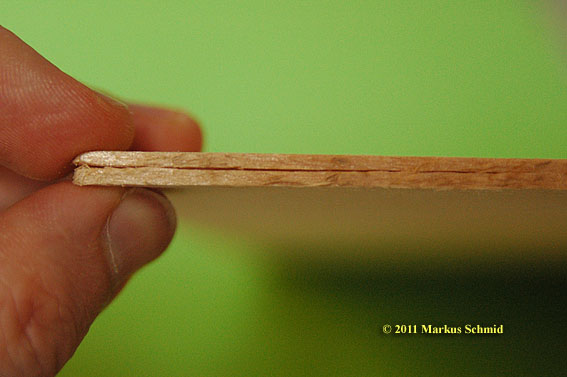

Whenever I want to learn about the runout of a top (of course only if it's in my possession), using a not too sharp knife I pry a two or three grain lines wide and 10 cm long splinter off one of those edges which anyway will be cut-offs: Then I split this splinter in the other direction. No doubt, this top (a low grade one, btw) has a measurable runout of 1:28 I have measured runout ratios as bad as 1:15. And I have seen a top that failed because of really poor wood quality (the responsible luthier is not to blame but I bow with respect that people like he can make good sounding instruments out of the material they can get their hands on). That failed top had an estimated runout ratio of about 1:5. 1:1 would be 45%
This one is a master grade top without measurable runout: Same master grade top with closed gap in order to see better the "no-runout".

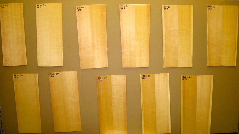

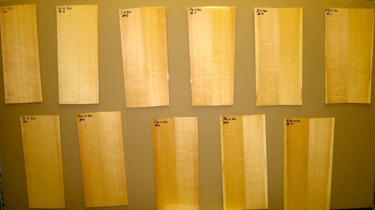

I have put this image up before but I think it will fit well with this thread. It shows a number of bookmatched Sitka samples with varying degrees of runout as they appear under a finish.
There once was a high resolution image available of the above but the original link is now dead
But if you click on the one I have uploaded it will display larger and is good enough to get some idea as they are marked one above the other, to the next in 1/4" gradients. This is to say the sample in the image marked 3/4" in 20, is telling us that the grain in that particular sample rises 'through' the board, from the bottom surface to the top surface, at an ratio of 3/4" for every 20" of the boards length.

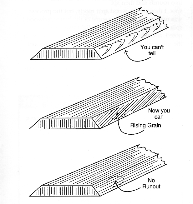

This series of line drawings are quite good also for anyone not quite sure exactly what people are talking about when they refer to runout....some people confuse the term with straightness of grain on the 'surface' of the board from one end to the other. This image shows that it is actually referring to straightness of grain through the board. The top line drawing is meant to show a rough sawn edge, the next 2 are meant to demonstrate how it is more easy to observe runout in the edge once you shoot a 45 degree with a sharp plane:
(EDIT: Please note. Markus demonstrates further along in this thread why shooting a 45 degree along the edge of a board 'does not' make runout any easier to detect. The bottom two line drawings do successfully demonstrate exactly what runout is though so I will leave them displayed in this post.)

What a great sample collection, Kim!
Are these tops still in this state? Maybe it would be great to attach runout ratio numbers to some of those samples.
Re: How to determine runout in spruce top billets
Oh, now I see... It seems that these ratios are already written onto the tops as 1/2 in 20, or 2 in 20 and so on. How did you measure them?charangohabsburg wrote:Maybe it would be great to attach runout ratio numbers to some of those samples.

Not my samples Markus, just something I downloaded from a web site that is no more...I am sure that the owner would be happy that his hard work and great information still lives on at the ANZLF.

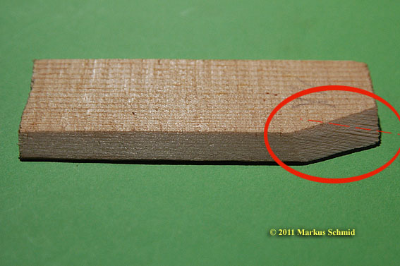

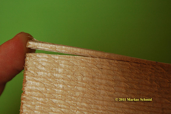

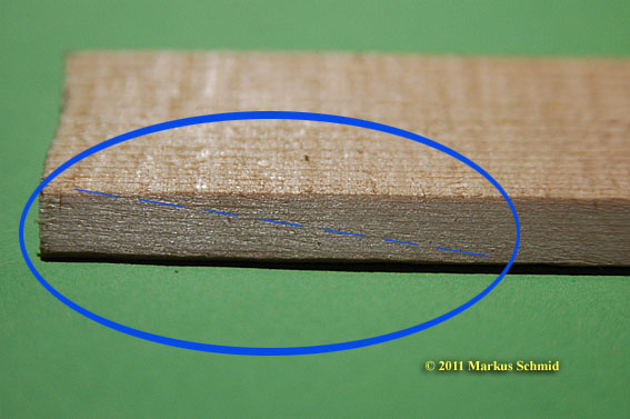

I disagree.Kim wrote: [...] the next 2 are meant to demonstrate how it is more easily observed runout in the edge once you shoot a 45 degree with a sharp plane:
What you will see is just plain grain lines cut at an angle (no "quartered surface" anymore). If you don't plane your bevel exactly parallel to the grain lines these will appear at a raising angle, which is not the runout. Look here:
Now you might say "but look, there are some very fine silver lines!". These here:

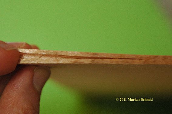

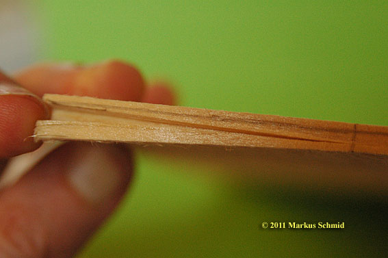

But now let's pry apart a bit of the wood to reveal runout more clearly...
Yes, runout is in the opposite direction than the lines in the two former pictures suggested!
A broken (split) surface normally will reveal runout, although sometimes not so clearly as here or as when continuing with my "step 2" - photo in my earlier post. A planed surface instead hides the runout unless you compare it's refraction with a bookmatched piece as it happens in a completed top.

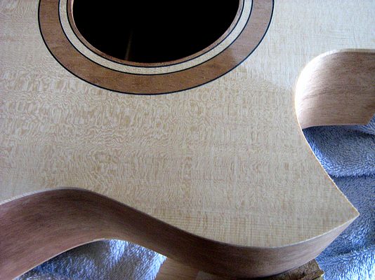

I was thrilled with this soundboard when it revealed so much silking. Not surprisingly ,it's a master set of Sitka . Now that it has finish on ,it displays no colour change between the bookmatched halves indicating little to no runout so maybe Mr. Fuch is correct.

kiwigeo wrote:Wheres the binding????
Before finish ( shellac):
Craig Lawrence

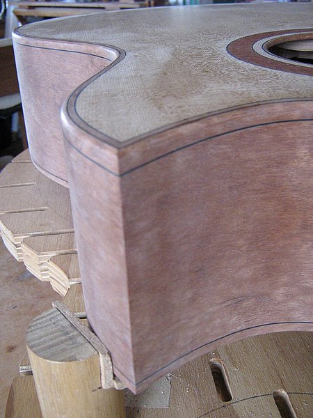

When did you take up using the plastic moulding process to construct your guitars Craig???
Incredibly sharp work mate.
Thank god there's binding. Guitars without binding just dont work for me.

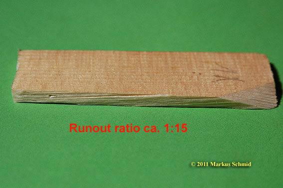

This is piece of decent, nearly quartersawn package grade Swiss alpine spruce:Craig wrote:I was thrilled with this soundboard when it revealed so much silking. Not surprisingly ,it's a master set of Sitka . Now that it has finish on ,it displays no colour change between the bookmatched halves indicating little to no runout so maybe Mr. Fuch is correct.
As you can see it has nice silking:
... and quite a horrible runout (measured runout ratio of 1:11):
Today I cut this piece in two and joined it in "false bookmatch manner".
It is no surprise that the colour change is noticable without varnishing the sample, and even so without cleaning up the smeared fish glue near the joint.
In the sun:
In the shade:
And yet, in spite of apparently being wrong, Mr. Fuchs's theory is not totally wrong, only that he forgot to attach some numbers to it. Silk appearance starts to decrease when runout is far beyond what we would accept as suitable tonewood. If someone is interested in these numbers I can make an effort to explain it. I would have to do some drawings though.

Here some better pictures of the colour change.
After planing the surface of the jointed pieces ( = cleaned from glue rests) :
This is how silky 1:11 runout looks like "under varnish" (I'd better say "after slapping some shellac on" ) :
