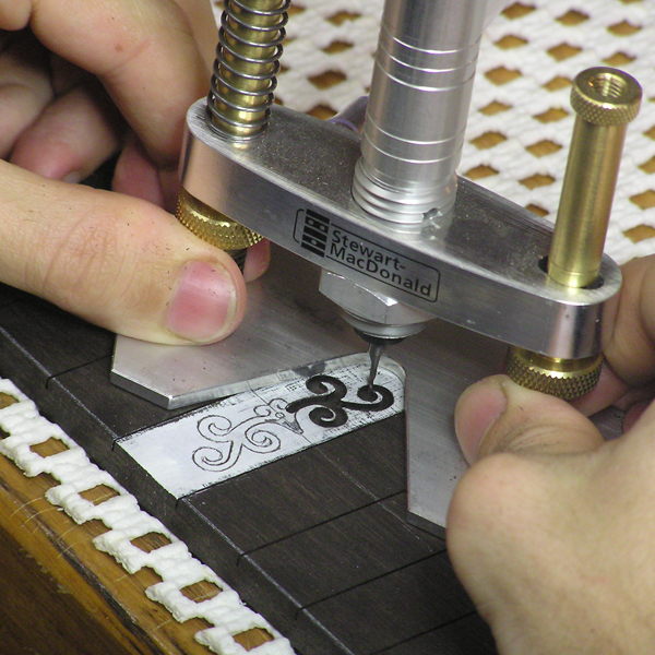

Has anyone had any experience with the Stewmac Router base for the Dremel tool?
http://www.stewmac.com/shop/Tools/Speci ... Bases.html
I have a dremel and a heavy router. This tool if good, would be a good option for me.
Re: Lightweight router recommendations?
I have the stewmac dremel base. It's good quality - I got it to help ease me into inlay, but it doesn't "plunge" like I thought it would (it kinda does look like it should). Doesn't fit cheapy dremels but the real deals work great and I'm sure I'll use it for other things further down the track. I'd probably replace it if mine went missing, if that counts as any kind of endorsement.
Hi Pete,Pete wrote:Has anyone had any experience with the Stewmac Router base for the Dremel tool?
The Stewmac dremel base is pretty much a standard for inlay work and also adapts the dremel for use with their circle cutter jig for cutting out the soundhole and rebating the rosette. It can also be used to adapt the dremel for use in Stewmac's saddle slotting jig. I have one of these bases and they do work for all of these task. The only issue is the dremel tool itself. Its a bit under powered and the bearing in the nose can develop runout in a short time which results in a wandering bit, not good for inlay, disastrous for a saddle slot. There is a work around for bearing slop but nothing you can do about the lack of power out put from the dremel.
This leaves the value for money question in buying a base designed specifically for the dremel tool dependant upon the intended use. If you intend to do a lot of work, get more tool to fit the base or find/make another base. On the other hand if one intends only to build one or two guitars, then the dremel should get the job done adequatly as long as the limitations are taken into account.
One adaptation I have seen for these Stewmac bases which I am told works well is to fit an air powered pencil grinder however unless you spend the $ this can import a lot of problems of its own. Another option is to drill out the thread in the Stewmac base that is cut for the dremel so the hole will friction fit Proxxon die grinder. You also need to drill some holes horizontally in the Stewmac base and tap them to take a couple of grub screws to secure the Proxxon tool.
http://www.proxxonworld.com.au/product/ ... e_220-240v
At max 20000rpm, the Proxxon tool is slower than the dremel tool by about 6000rpm. But the Proxxon is much more powerful than the dremel and because the bearings are focused toward pro use, they are a lot more accurate and should last for years.

I use the Stewmac base too, although I use it with the Foredom style setup.
I prefer this setup as it is - lighter giving good control, smaller with better visibility and higher powered at 1/4HP. It's also more quiet than a dremel or similar tool, although as Kim mentioned too, these units vary in their RPM abilities. Mine goes up to 18'000 RPM I think; a bit slower than my Dremel which from memory was 30 or 24K ? But it is enough with these tiny bits and the right feed rate.
