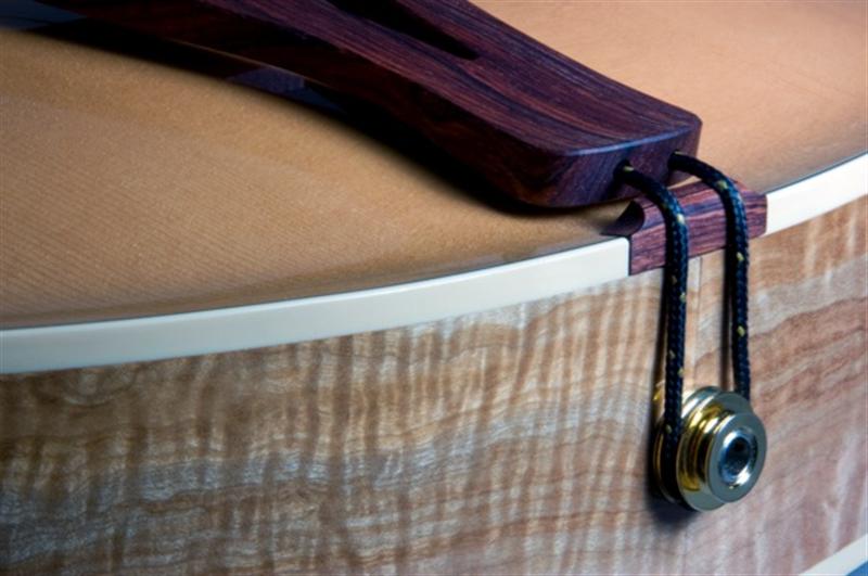

I think this is a much better way to do it. I also found that because of the geometry of the tail piece block and tail gut loop it is very difficult to keep the pivot block on the portion of the top supported by the tail block unless the tail block is quite deep. Under string tension it wants to pull forward. The shorter you make the loop in order to pull the whole thing back, the higher the angle it makes to the tail piece and the more downward pressure it puts on the pivot block. Apart from having a significant force pressing on the top and preventing it from vibrating in the that area it leaves a bad dent on the spruce. After a few years it would get quite bad I think.

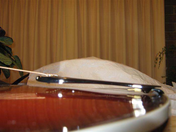

Here is a picture of the fix.
I'm with Jeff and like Dom's answer to the problem or make a one piece tailpiece.
Dave: Welcome to the forum and thanks for the explanation on the Archtop tailpiece.

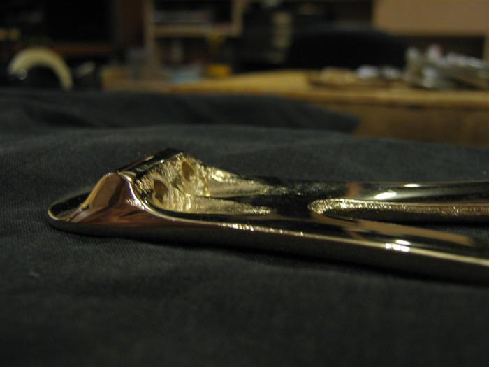

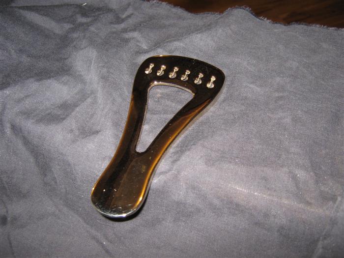

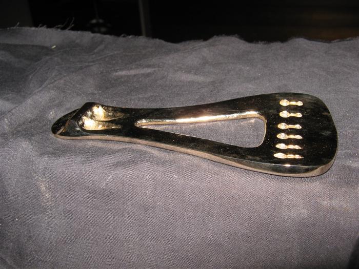

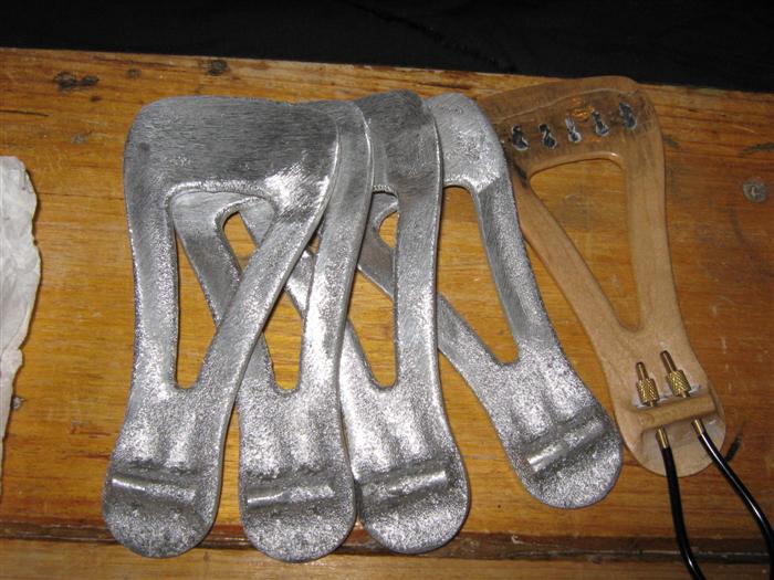

This may be of interest to some, a while back i made a one piece tailpiece similar to the type we've been discussing here, i had it copied in alloy, i had several cast, polished and plated. A couple of pics to show you.
Cheers,,,
Rod

Nice, although in wood that one piece design invites potential failure in shear along the grain (above the pivot) that you don't have with the more traditional construction (where there's no shear, only compression). Also, not sure I want to see those adjusters so visable, rather than tucked away in their slots, but that's just me. But lots of ways to build a tailpiece.
Milton, On. Canada
