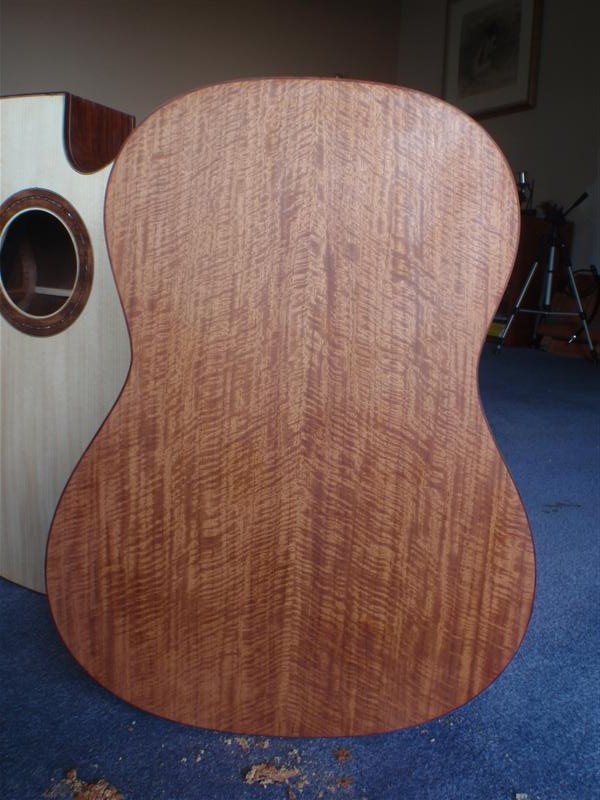

Thanks for the info Peter. Seems there are few good options for a clear filler. Where do you source the Target Coatings HSF5100 Filler and Glaze and what is it designed for? I am currently doing a beautiful curly narra classical and want the wood to show through as much as possible. I could have used coloured timbermate but I didn't want it to stain or obscure the wood in any way so zpoxy is my best option.
