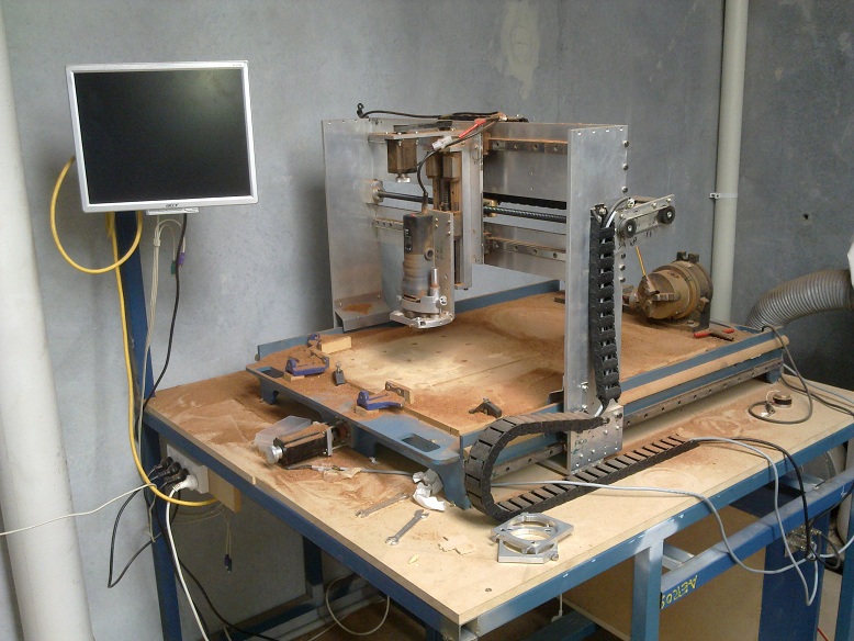

This is my one,
I made it myself

Im wondering how you get that chuck (at right) to fit onto the routersimso wrote:This is my one,

Ah ha.....kiwigeo wrote:Im wondering how you get that chuck (at right) to fit onto the router
I use to engrave pool cues for mates, hence the rotary table attachment

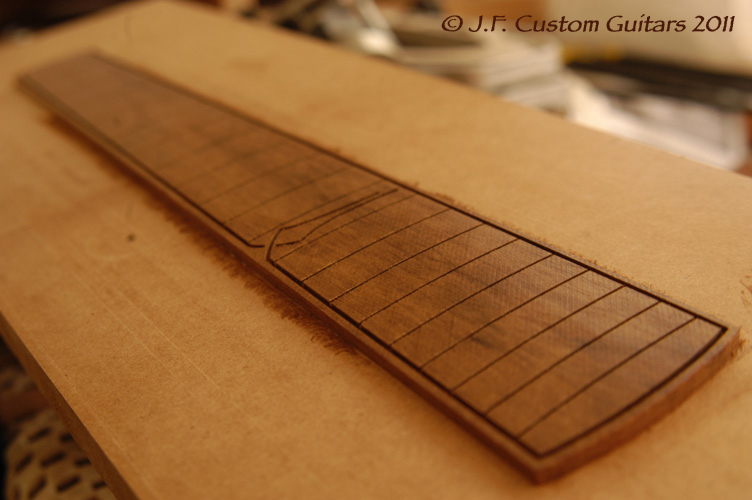

Hmm, you mean like this ?Kim wrote:...fretboards with faux binding...
That was done during my brief month long romance with a CNC Shark Pro Plus.
Three bits - 1/4" roundover created the radius first - you can see the minor machining marks running at 45˚ that were easily removed with a touch of sandpaper. Then a 1.2mm spiral bit for the purfling; then a 0.55mm spiral bit for the blind fret slots. Perfect results on this fairly plain BR rosewood fretboard. Now that was done with a Shark and a laminate trimmer running at 24'000rpm, without any dust collection or air to blow it out - so definitely possible. Aside from blind frets like this, it is also useful for Multiscale builds which can't be done easily by the tablesaw method. Can be done by hand with a jig though.

I would not have thought it possible, such a small tip without breaking it. How long did it take from start to finish with setup and changing of all 3 bitsJ.F. Custom wrote:That was done during my brief month long romance with a CNC Shark Pro Plus.

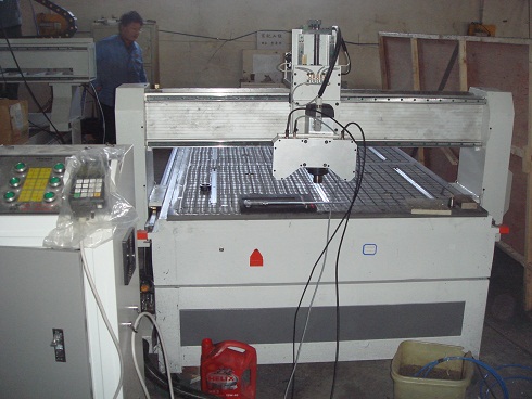

If you havent guessed I love cnc, it, to me takes woodwork to the next level, I think totally automating everything is wrong, but using it to lay the ground work for customising is always good
Ive made my own cnc lathe / cnc mill and cnc router. But becuase theres no time any more in life I contracted a company to make the following for me, this is a cnc laser scanner prototype. I take delivery in about 5 weeks

Now you're testing me - that was over three months ago and I only did four boards in the weeks I had the machine. I think the longest job was the radius machining at maybe about 25 mins? The purfling channel was only about 2 mins and the frets from memory were about 20 mins. So perhaps all told in the realm of a 50-60 mins for the completed board. These are rough estimates though. Also, bear in mind this was a complete CNC newbie doing this - I'm very sure I could have upped the speed in the radius cutting at least (plus used a larger bit), let alone tweaked other aspects too. I think from memory the fret slots themselves were cut in four or five passes each. I did the four boards with the one bit - no breakage and it does not seem to have dulled at all as yet.simso wrote:I would not have thought it possible, such a small tip without breaking it. How long did it take from start to finish with setup and changing of all 3 bits
Not really suitable for production as these are not production speeds, but for a smaller operation where "numbers off the production line" are not as relevant, It's a viable option. Unlikely also to be as fast as a tablesaw for purely fret cutting, but far more flexible. The CNC will do everything from the radius through to inlays, purfling and slots, without having to reset or move anything - except change the bits. Aside from the aforementioned multiscale cutting, there is also the fact that the tablesaw is limited to scale lengths you have the templates for and templates are only made in "standard" scales. The cnc could be used for simply cutting a new template too, but for one off jobs of non-standard scale lengths, it provides a quick and very accurate way of doing the job. You can check out the Precise Bits website - it has some more details on their micro bits and use in luthiery.
Mind you, all that said, I would not be buying one just to do fret slotting!
