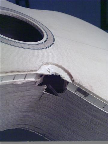

Hey Nick, remember when you said I was an unucky bastard!
Uke 010.jpg (26.6 KiB) Viewed 12662 times
Surprisingly, there was complete silence once I turned off the router.
I was going to burn it, but have put it away until I have some creative inspiration. :roll:
As to why?
Well, it's my fault.
I used too much water bending the side & had some cupping in the waist.
After scraping out the cupping I knew the wall was thin, but not that thin!
Once the main binding channel was cut the wall obviously lost all integrity.
The bearing pushed through, the router bit followed, the uke got trashed, craig went & quietly opened a beer. :dru
"Gentlemen, we can rebuild it. We have the technology. We have the capability to build the world's first bionic uke." :lol:

A piece of advice Paul - rout the purfling channel first. If I'd done this I probably would have got away with it!
Actually Martin, I've been considering a soundport fix.
It's a concert sized uke and the way it's held would place the soundport in a pretty good position.
I'd still have to restore integrity to the waist somehow though.
