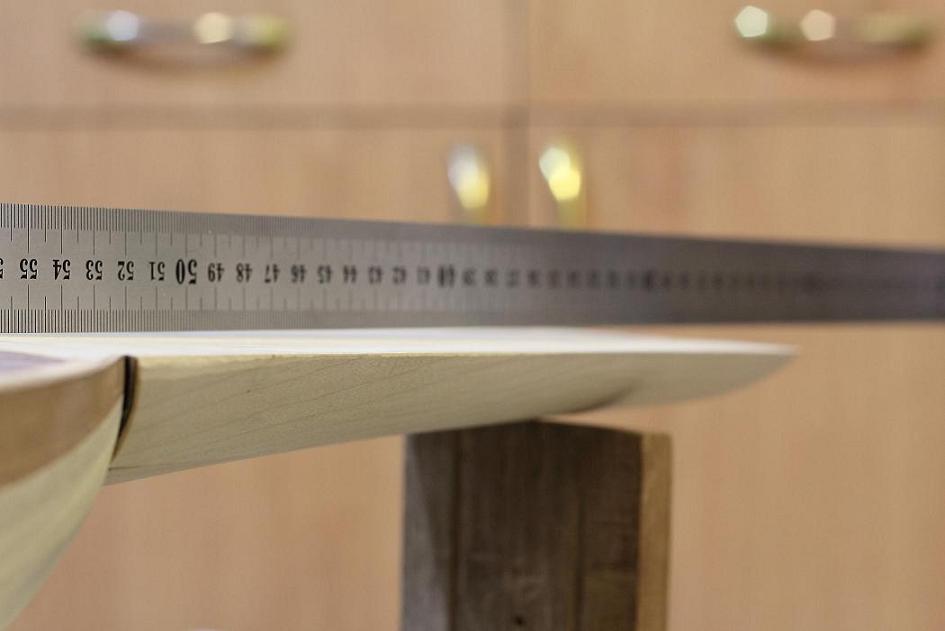

Hi all,

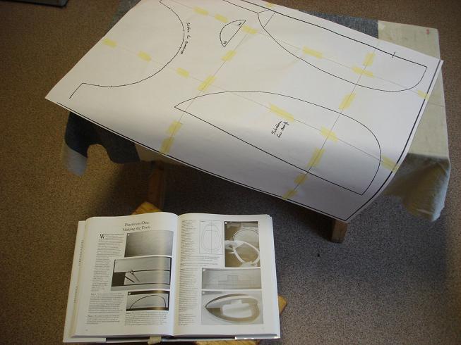

2 - 3 months ago I have begun the interesting project - building archlute.
It not the simple instrument, some stages of work is very fiddly...
Some pics for ANZLF, probably will interesting...
So, archlute progress:
02 Sallas.JPG (32.01 KiB) Viewed 31096 times

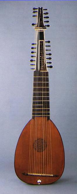

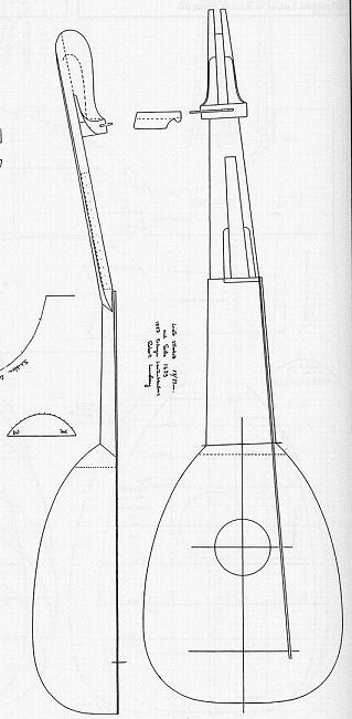

Original archlute by Mateo Sellas, 16 c.
Cristoforo Choc, Venice, Italy, about 1650
(Cristoforo was one of the best pupils of M.Sellas)

Re: Building archlute.
Post by kiwigeo » Sun Aug 28, 2011 8:06 am
Nice work Sergy. Im looking forward to seeing this instrument finished..it's going to be magnificent.

It must be that you only fret the first six pair of strings, are they the courses ? and the rest are played open , is that right ?

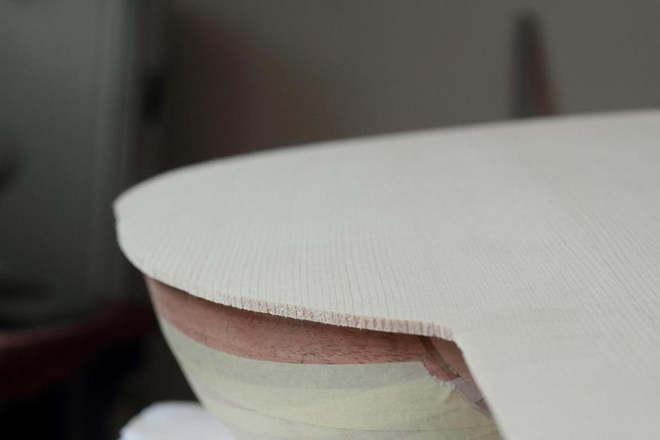

Post by charangohabsburg » Sun Aug 28, 2011 10:03 am
Hi Sergy, that looks very demanding, just the right stuff for you! 8) :cl
I like the picture with the tip of the mould cut off. :wink:
Post by kiwigeo » Sun Aug 28, 2011 10:15 am
Me too......it reminds me how much I'd love to saw off Julia Guillard's nose :?

auscab wrote: It must be that you only fret the first six pair of strings, are they the courses ? and the rest are played open , is that right ?
On a photo we see 6 strings for frets, other free.
But also it is possible for 8 pair of strings, + 6 bass strings free.
These are preferences of the players.
Also there is a version with single basses, apparently, is more suitable..

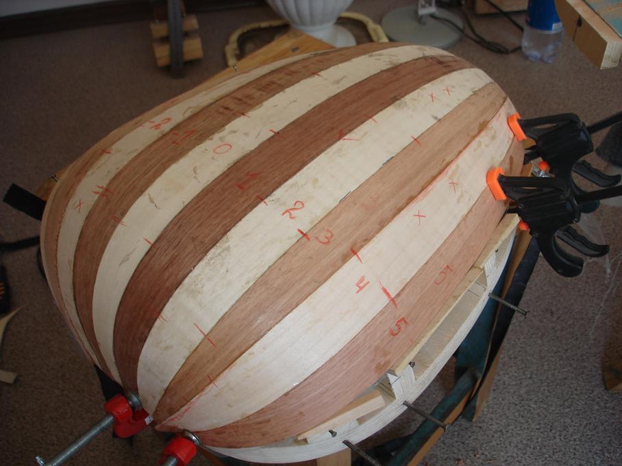

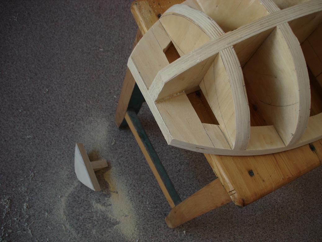

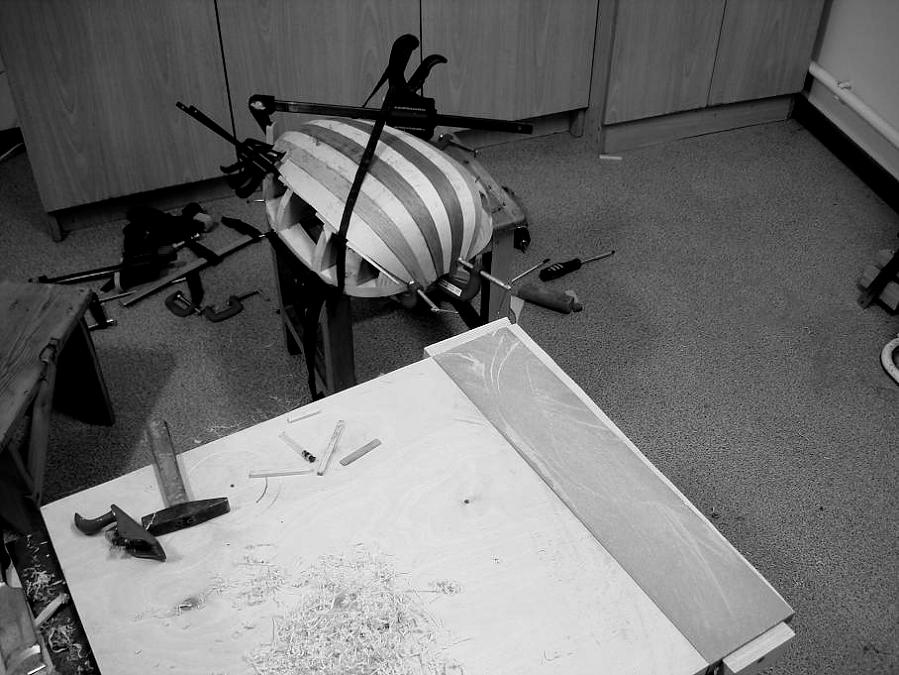

Post by Sergy » Mon Aug 29, 2011 12:20 am

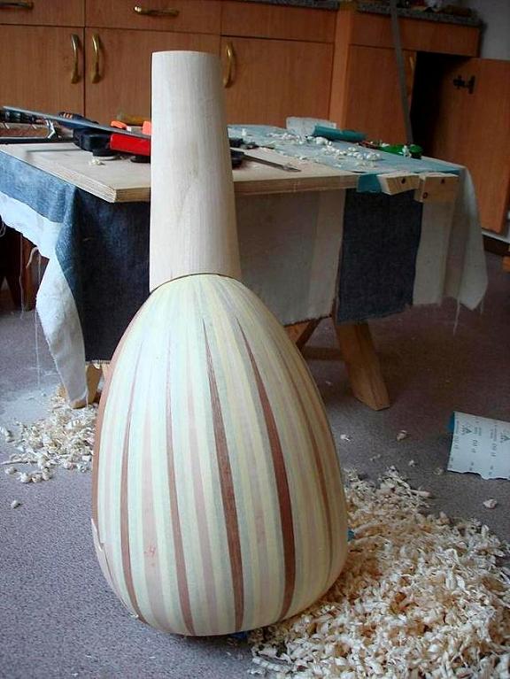

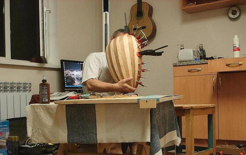

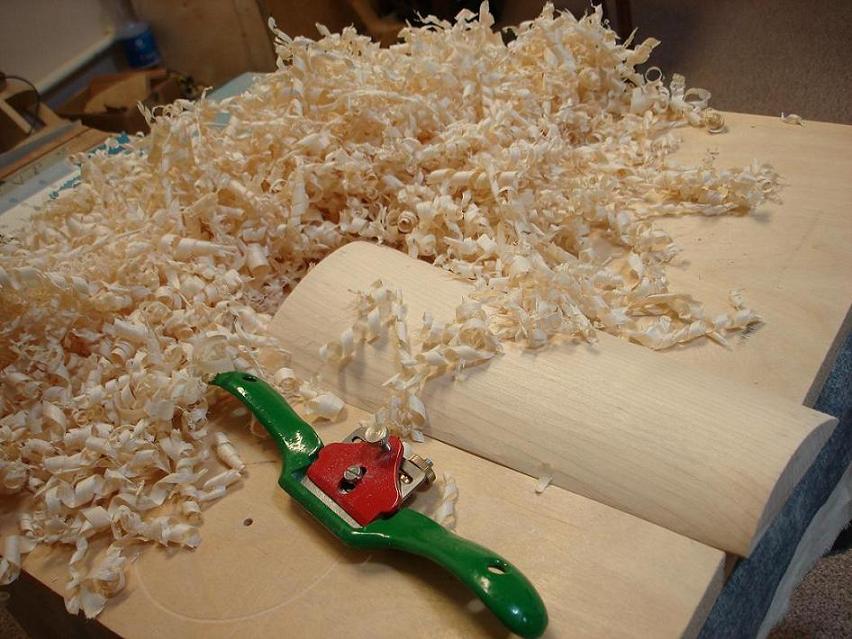

Continuation -

Post by Allen » Mon Aug 29, 2011 5:47 am

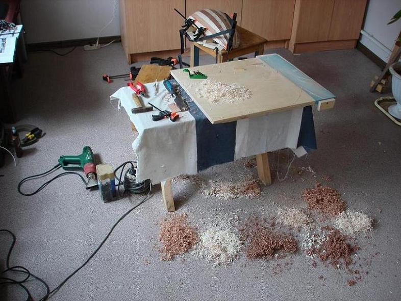

Should be no excuse for space either. Looks like you are building in an unused bedroom?
I'm most impressed with how these instruments go together.

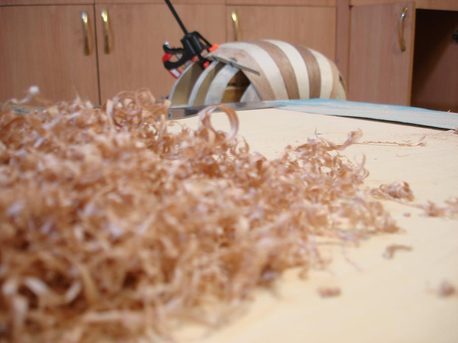

Post by Matt Bach » Mon Aug 29, 2011 11:28 pm
Amazing.
Even your shavings arrange themselves into neat piles!
Sergy
Posts: 73
Joined: Sun Oct 17, 2010 3:26 am
Location: Aktobe, kz
Post by Sergy » Tue Aug 30, 2011 12:07 am

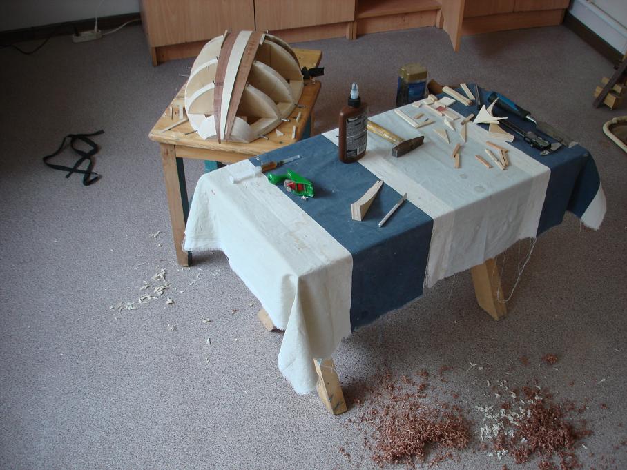

Allen wrote: Looks like you are building in an unused bedroom?
No, it not a bedroom. :)
It's my new workshop, there I do the basic work. For dirty work I have other room (shed?)

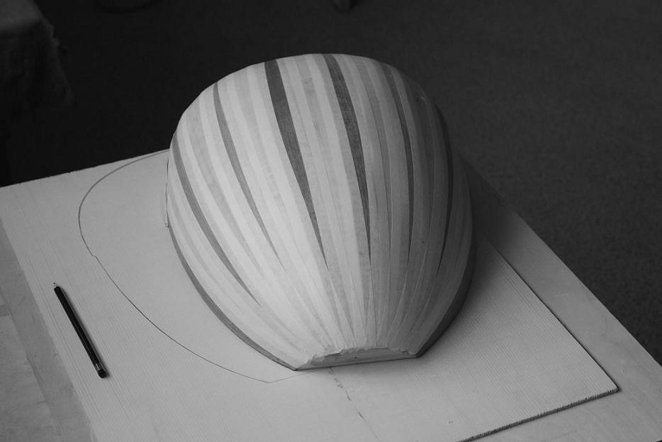

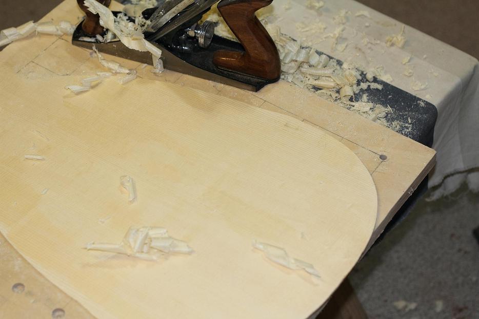

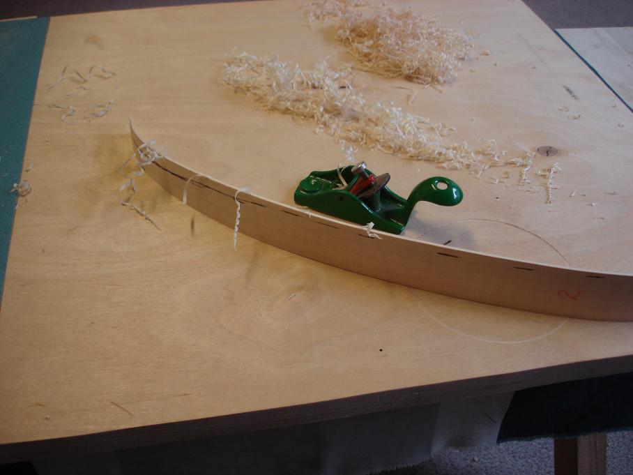

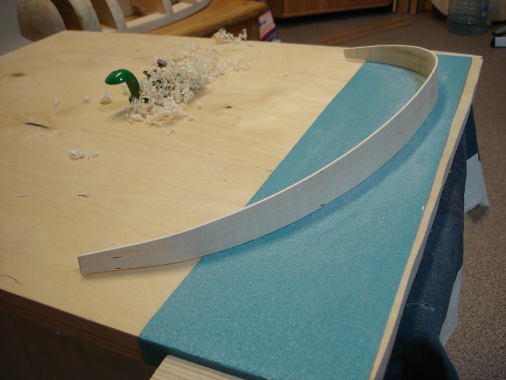

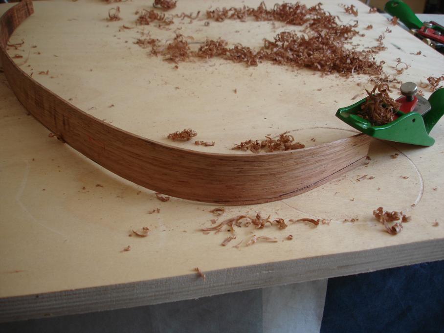

Counter cap -
Counter cap gluing -

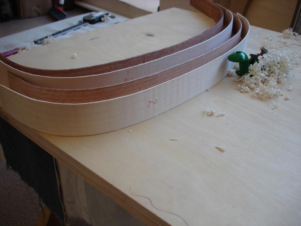

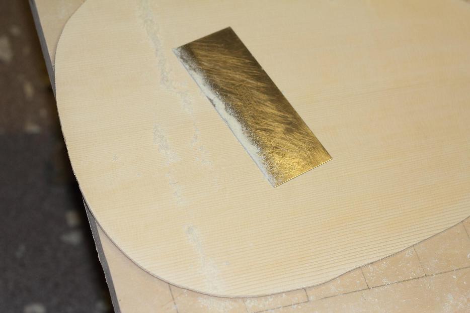

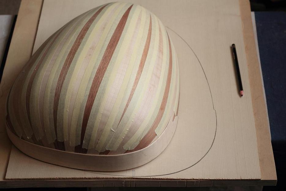

Post by Allen » Wed Aug 31, 2011 5:50 am

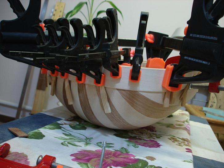

Why do all the seams get taped up again after scraping? Do they have a tendency to come apart until the inside has had it's cloth or paper reinforcements?
Sergy
Posts: 73
Post by Sergy » Wed Aug 31, 2011 6:04 pm
I glued inside strips, then cleared a scraper the dried up glue.
But masking tape should be used earlier, for the previous stage (pic #101) ...
Lundberg also about it writes.

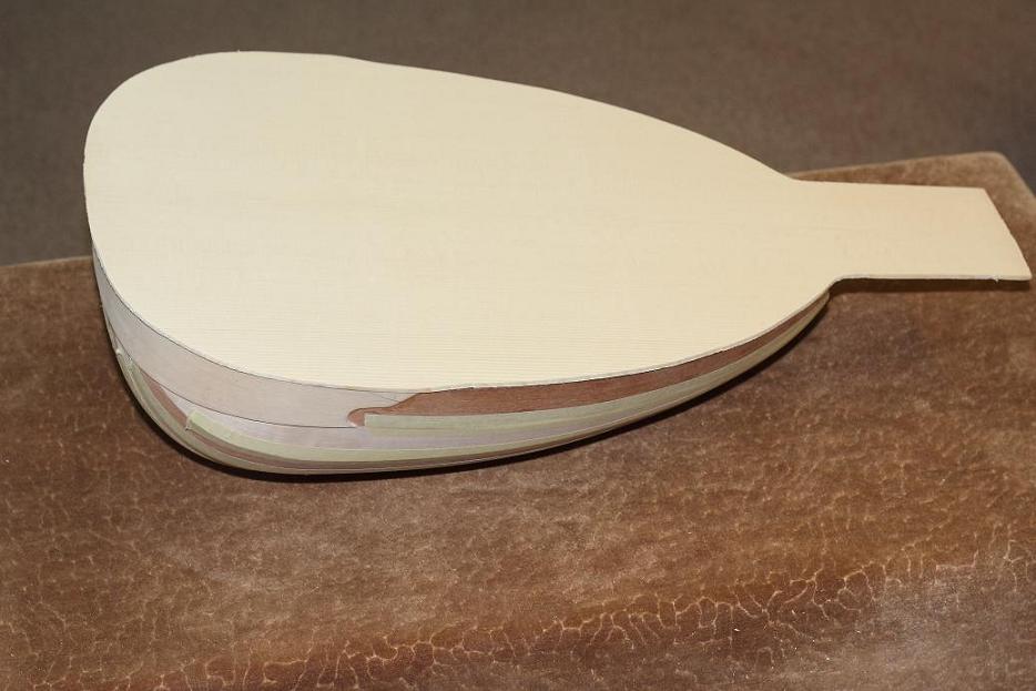

Post by Sergy » Wed Aug 31, 2011 6:21 pm
Continuation -

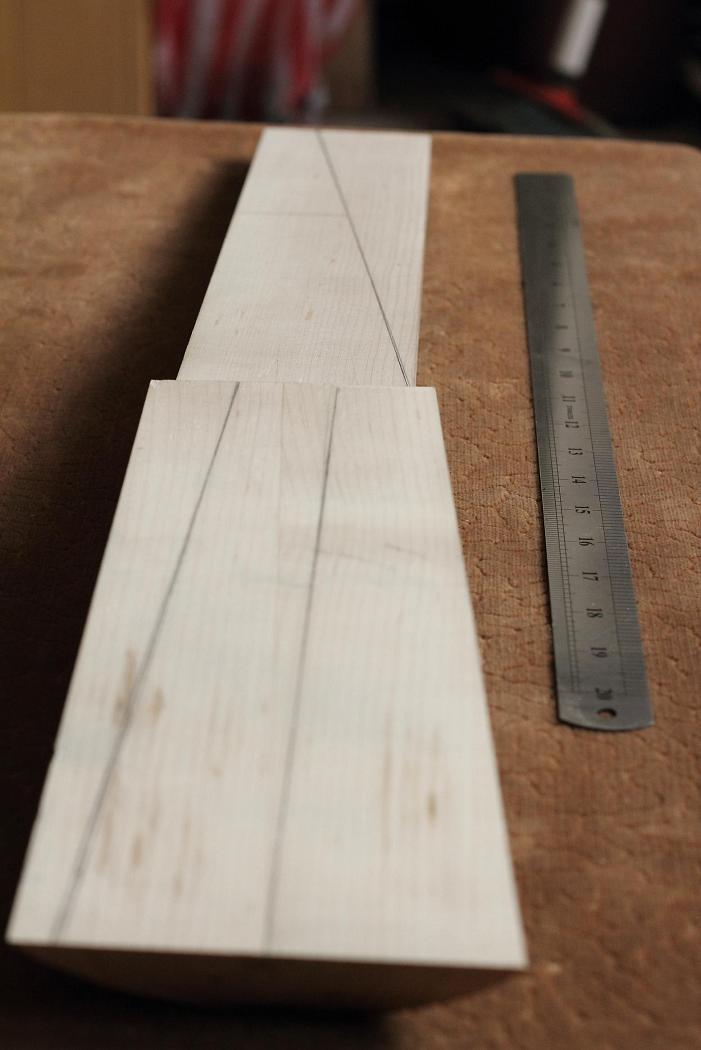

Post by kiwigeo » Wed Aug 31, 2011 7:50 pm

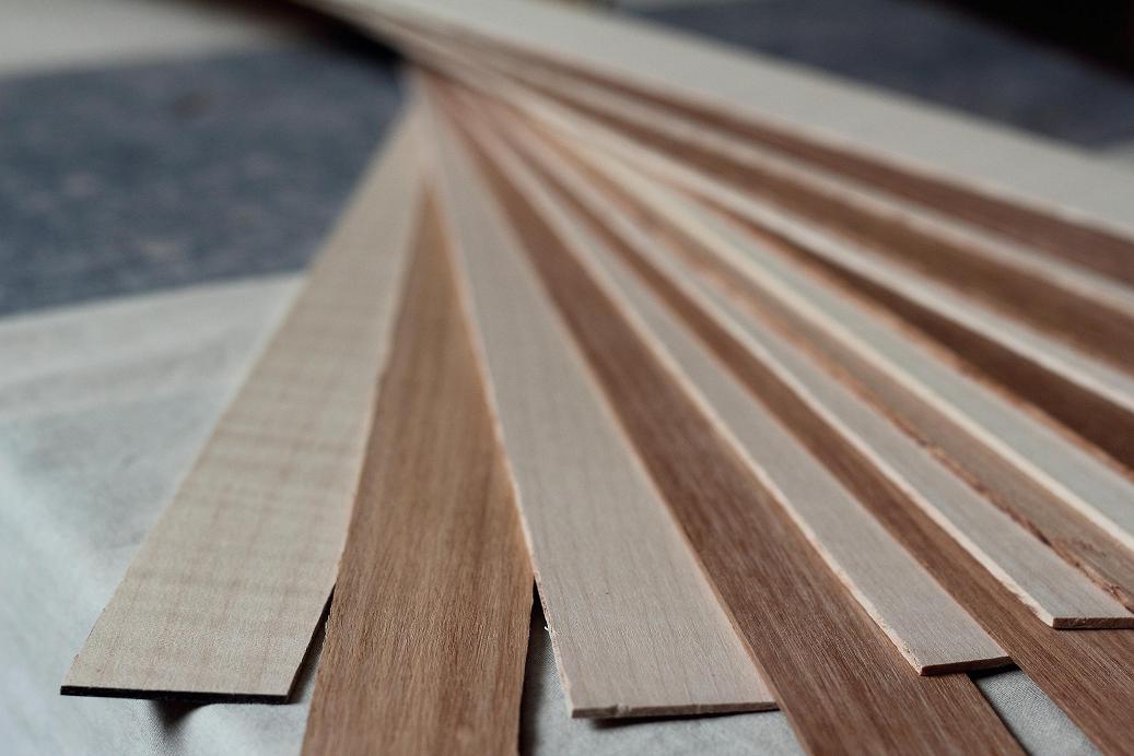

Sergy what wood is the neck core? I used lime on my lute.
Sergy
Posts: 73
Post by Sergy » Wed Aug 31, 2011 9:05 pm
For neck - maple (no figured wood), ribs - medium figured maple + mahogany ribs,
for soundboard - Engelmann spruce ( 2A ).

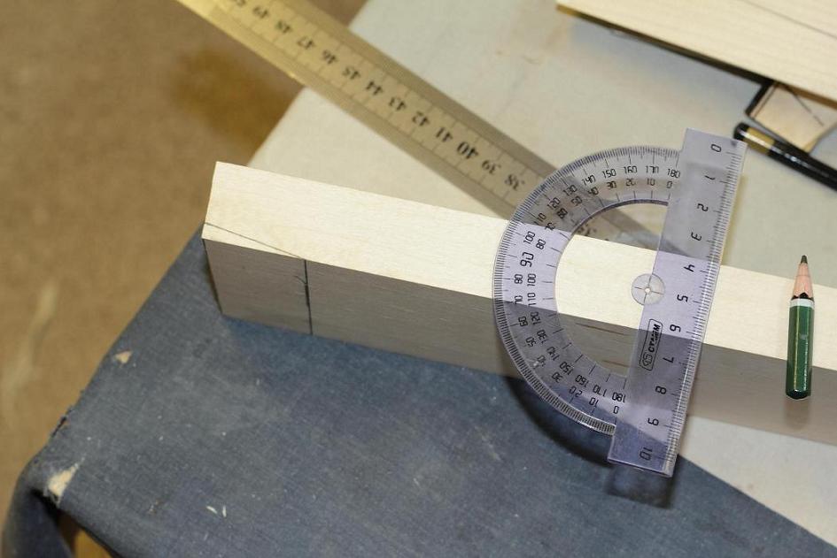

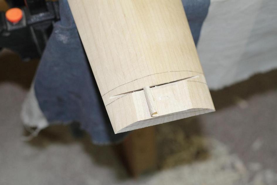

Post by Sergy » Thu Sep 01, 2011 5:08 pm

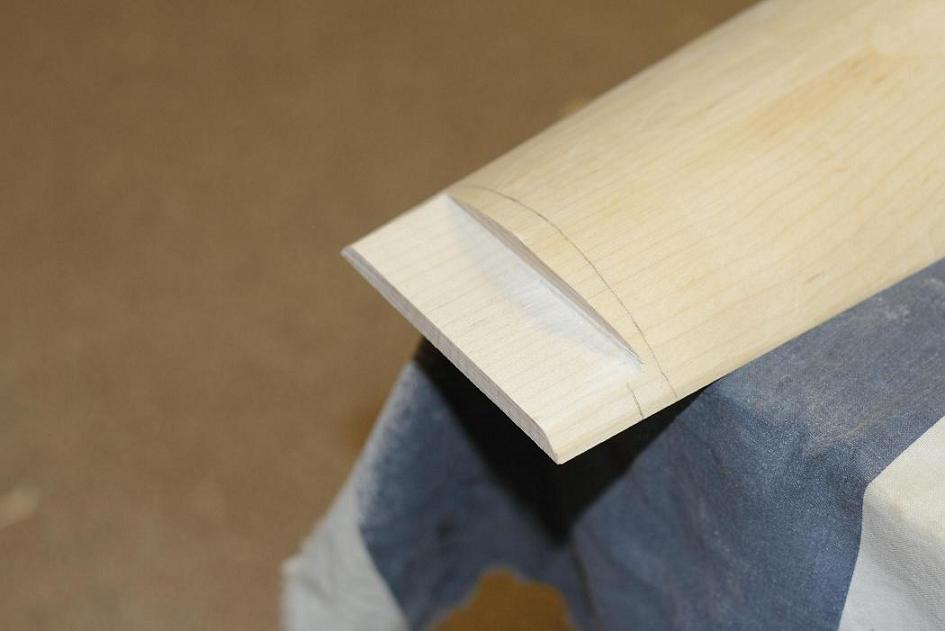

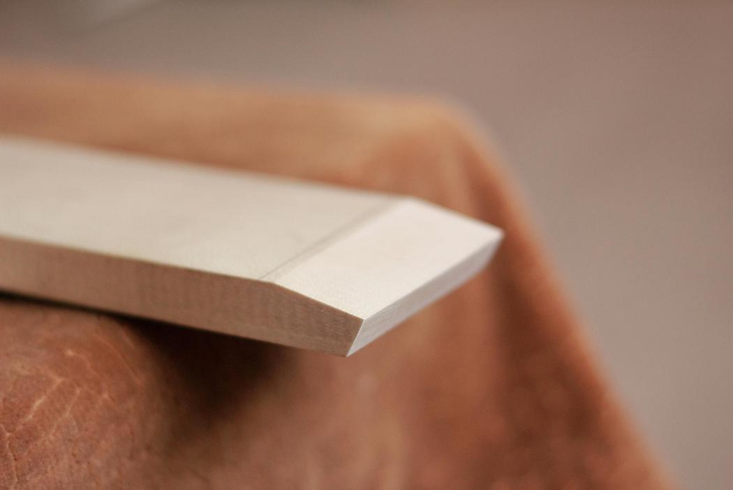

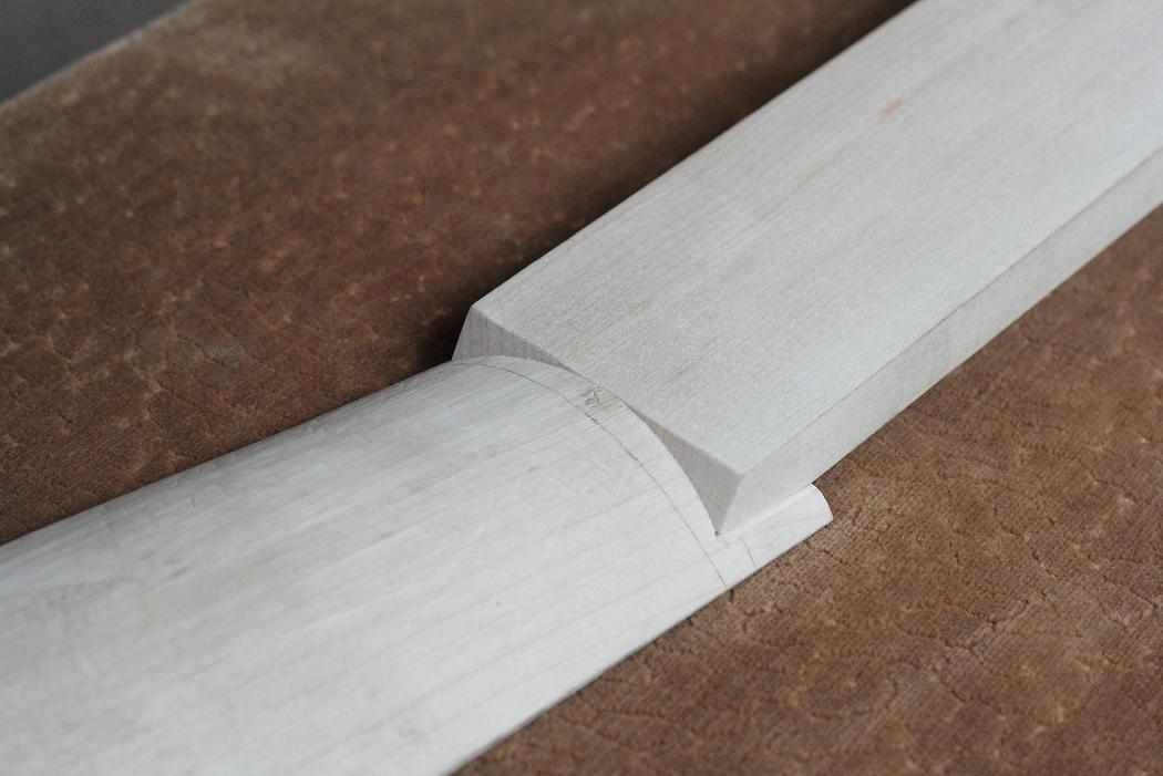

Neck and bassneck processing -

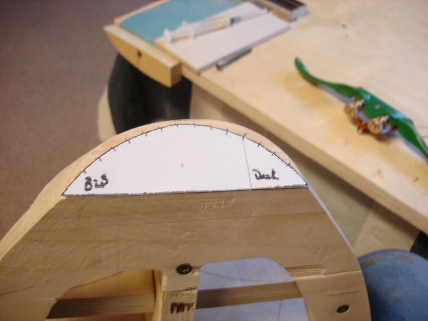

Post by Sergy » Sat Sep 03, 2011 9:04 pm
Here the peg boxes are being made up. The pegbox and neck shaft centrelines dont line up but this is intentional (see drawings).
