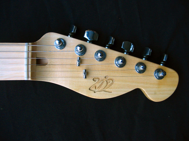

Hi, here is a pic and a link to a guitar builder in Melbourne "twenty12 Guitars". He has built a Huon Pine & Satin box Tele for a customer which looks great.
I have spoken to Jon at 20-12, he said the satin box worked really well. It was an old piece of timber provided by the customer, as was the huon pine body blank.
http://twentytwelveguitars.com/?p=375
Jon also said this about the satin box "you'll be pleased with its tone, its a little more dense than maple but will give you a nice snap and twang. Its quite oily and suits a oil/wax finish very well. I had it sitting in my workshop for about 6 months before I used it and it remained very stable and true which is obviously a necessary part of a useable neck wood".
I would love to get hold of a stash of satin box.
Will
Will

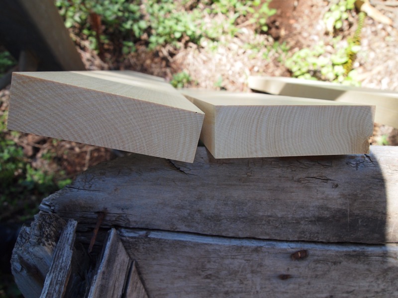

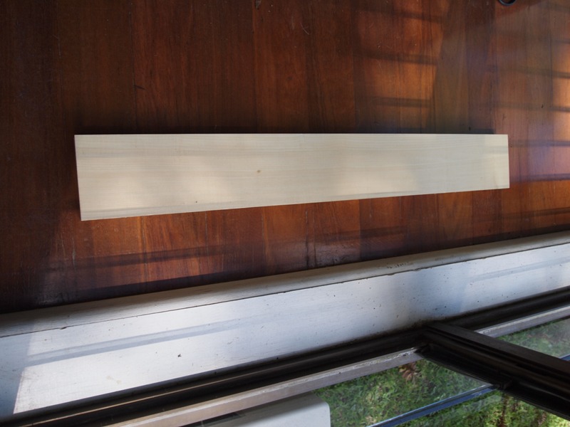

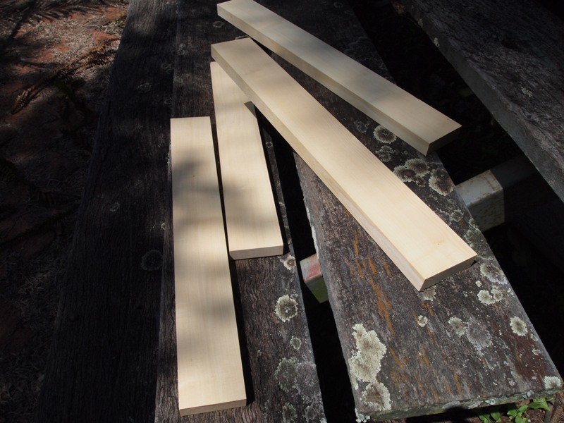

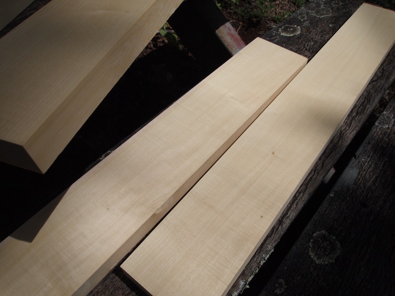

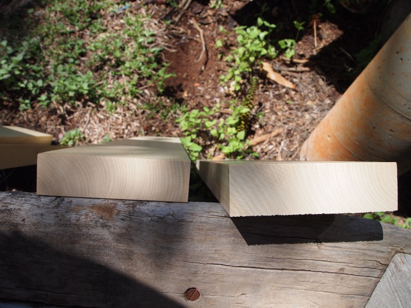

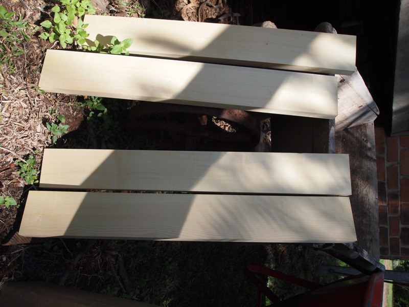

Re: My Satin Box Has arrived!
Well I finally got around to ordering some satin box blanks for a tele neck.
The size is perfect for what I want which is great.
A couple of the blanks have some minor flaming through them in a couple of spots which is nice.
Here are some pics showing the colour against some mixed species floor boards.
Can't wait to get at them.
Will
Will
