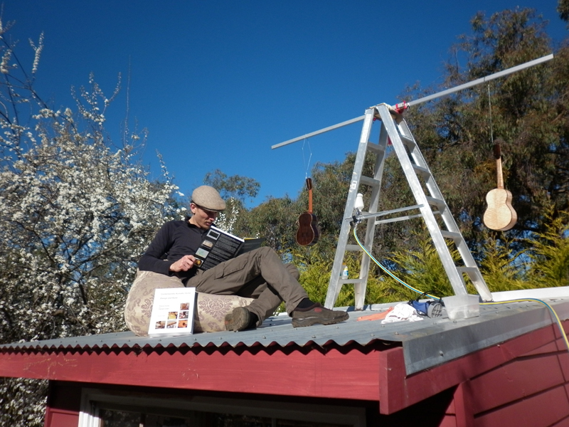

Well for me, a decent double barrel face mask and a room with a view! :lol:
Seriously though, I found when spraying up there, any breeze tends to take any overspray and fumes straight up and over any surrounding trees, buildings etc, as opposed to getting caught up in the fray of eddies lower down around the house and garden - generally this disperses it everywhere you don't want. I don't smell a thing with the mask, but of course can still smell it while it cures. Letting it cure in a separate room/area is the easiest solution for that.
