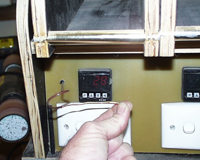

Going back to the original question about temperature measurement. I've been using simple thermocouples, they are as simple as twisting two wires together. Very slight gauge, with Teflon insulation so they can be put into the foil wrap or under the slats so you get the actual temperature of the wood.

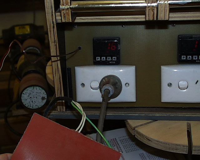

A thermocouple is basically a joint between two dissimilar metal that produces a small voltage (emf). This voltage is proportional to temperature.
The ones I use look like thin speaker wire (figure 8 type flex) but have teflon insulation so they can with stand much higher temps before melting. I strip the outer insulation to leave the two inner cores with about 60-70mm of insulation and then they are stripped and joined together. This end is then put into the sandwich of slats timber and heating blanket. I've been putting it in the center of the lower, but it can go anywhere as the heating blanket should heat evenly over its length.
I have a temperature controller set up which turns the blanket on and off to achieve the set temperature. But the thermocouple can be read with hand held meter.
I started using the controller after cooking a set of sides.
Hope this explains it
Graham
