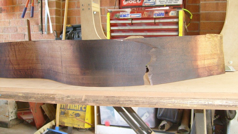

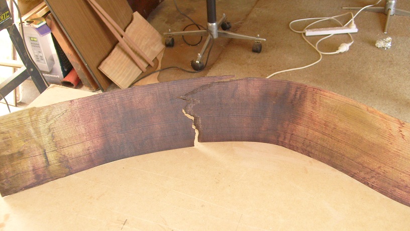

I bent these low grade Tas Blackwood Sides on the weekend useing LMI blanket and my home made Fox style bender Side was spritzed and wrapped in foil placed onto steel slat then blanket then top slat max temp 170 C all over in about 8min and this is the result. I Can't work out what went wrong !!!!!
Does anyone have any Idea's ?

Wow, looks a tad dry... try 150c, 170c maybe too hot I reckon. Also, a spitz, then kitchen paper, then seal in foil, then between 2 x .010 spring steel slats and the blanket on top is what I have used to good effect.

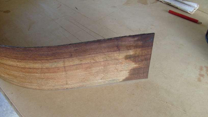

Yeah Kim I tried 150 c For a Max 4minutes and the result was better but still with charring here is the result of that.
Re: Unwanted Outcome Bending Sides
Could just be the angle but the material looks to be too thick and it has acute run-out. Try taking the side down to .090" max .085 is better or even >.080 if you have a tight bend at a cutaway. Also, did you try kitchen paper on the wood sandwiching the foil pack between 'two' slats?? With that sort of short grain that stuff will need all the support it can get. One more thing, how are you measuring temp?? How reliable is the thermometer?

Hi Kim , The sides are 2mm, and yes you do have a good eye, there is runout, it was only a cheap A grade set that I thought would be best as this is only my second Build,I didn't want to use good quality wood at my level of Luthiery, but as it turns out I may have to use good wood in future.
The thermometer I am useing is an oven digital thermometer that is very good quality, I also wondered whether the Thermometer could have been inacurate,but I have used it for bending Silky Oak sides on my first build and they turned out OK See my Avatar Pic at the left here <----- . Also the time 4 min shouldn't be long enough for the temp to get too high any way.
I'm Starting to think that I just got a set that wasn't suitable.

I am just gearing up to do heat blanket bends myself, so no personal experience, but from all the research I have done, it seems that those who bend succesfully, have the bend done quickly in like 2 1/2 minutes, before the wood has dried out
It looks like a combination of too hot, too slow and the bad runout.

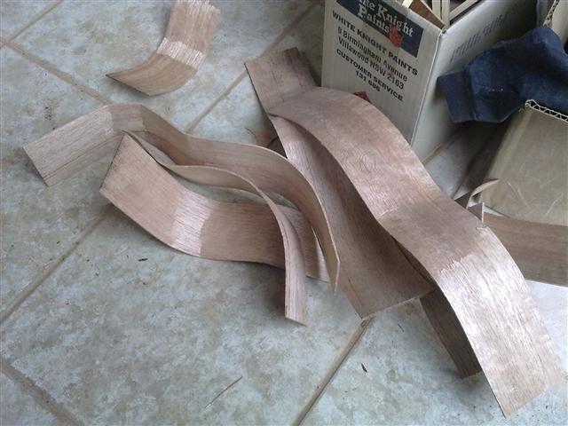

This is how I spent my first (and only) day using an LMI Blanket and a homemade bender. Six meranti uke sides shot to shit
Nothing I tried worked!
Made some more & bent them by hand on the iron.
Been too scared to re-visit the blanket since.

Just a Footnote, I recieved another set of sides from a different supplier ( thankyou Tim Spittle ) I bent these sides today exactly the same way I did the first and it went without a hitch,no burning charing or breaking, So if nothing else I have found that all sides are not created equal,even the same species of timber,can give completely different results in the bender.
