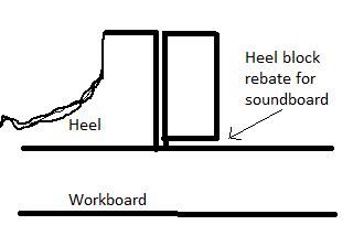

head block rebate : I presume you need to route or chisel out a little rebate in the headblock forward of the slots which hold the sides so that the top can slip under? Does that sound right? Thanks. Frank.

That's correct.vandenboom wrote:head block rebate : I presume you need to route or chisel out a little rebate in the headblock forward of the slots which hold the sides so that the top can slip under? Does that sound right?

Yes, you need to cut a rebate for the top on the heel block portion of the neck. I've used various methods from a laminate trimmer, table saw, and the one that Micheal and I have settled on is with the bandsaw. But it's not hard to do and use whatever tools you have available to you. Make sure that it is the exact depth of the top you are using though.

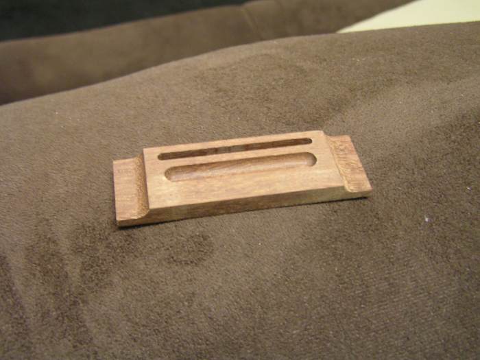

Micheal included the following sample bridge in the kits supplied.
The strings I've got don't have ball ends.
Thanks. Frank.
I understand there are a couple of ways of attaching strings at the bridge but was unsure of what the intention is with this design. Do you drill string holes through the back of the bridge on an angle up into the semi-circular rebate, or do you drill down through the rebate so the strings (with ball ends) sit against the bridge plate?The strings I've got don't have ball ends.
Thanks. Frank.

It's a tie block bridge Frank. Just like on a Classical Guitar. Drill 4 holes from the tail block edge of the bridge into the area where the cove bit has cut a trough. We put them on a slight angle as you asked.
If you've followed the plan, then spacing is going to be 42mm at the bridge. Gives 13mm between strings at the bridge and 10mm at the nut.
