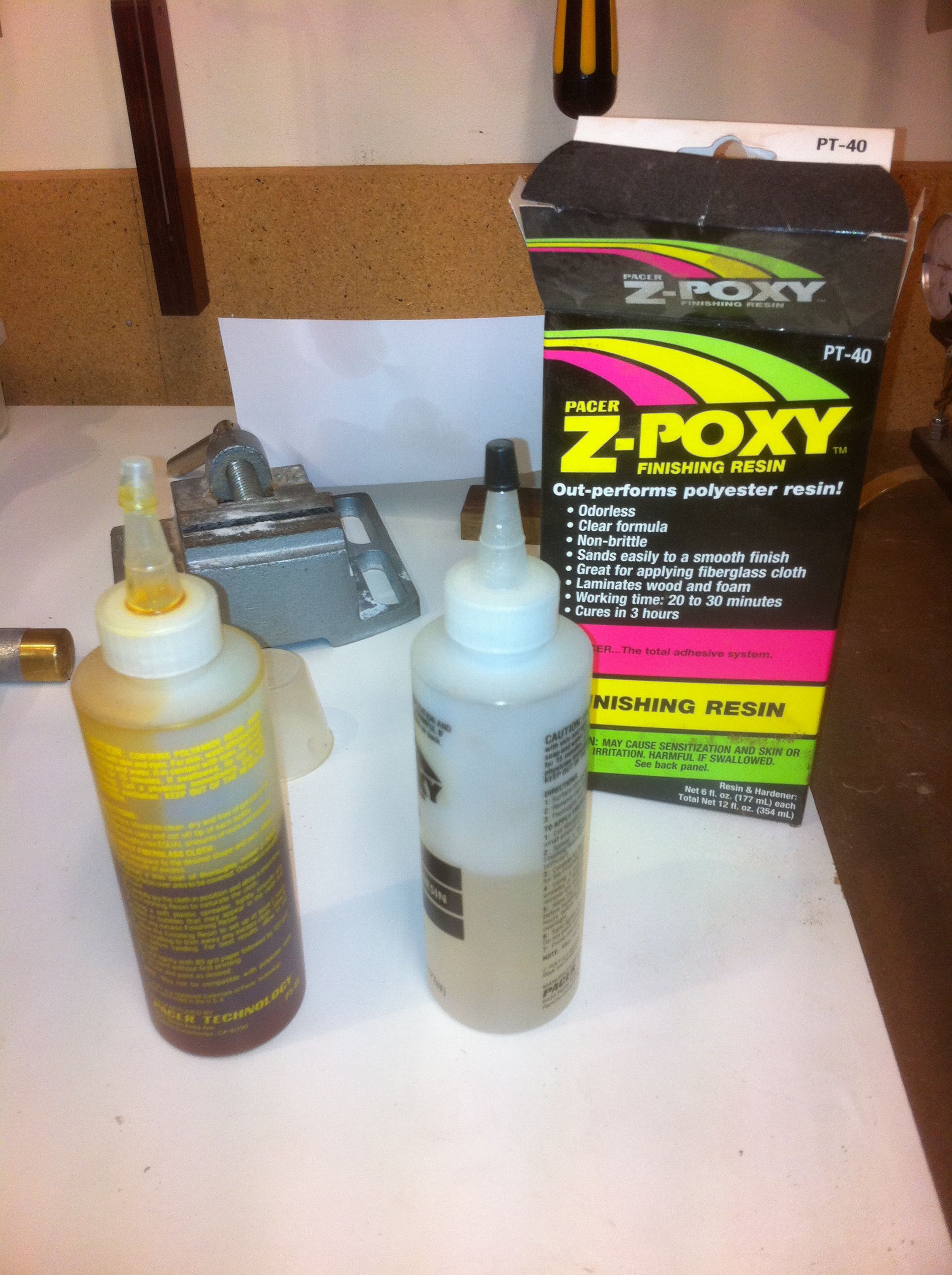

A pic of the Z poxy in my workshop. Note that my bottles have been sitting on the shelf for 2 years and would be out of date. That said the hardener hasnt really changed colour since the bottle was fresh.

Hey guys, I've noticed that the hardener gets darker with age. I just got some fresh stuff and compared to what I had left it was much lighter but still the warm amber colour. The red hardener could be from sitting on the shop shelf for ages before you got it. But I am sure a nice fresh batch should be light amber coloured.
I'd get some fresh stuff from a place that has turnover.
And if the red stuff sets OK keep it for rosewood.
