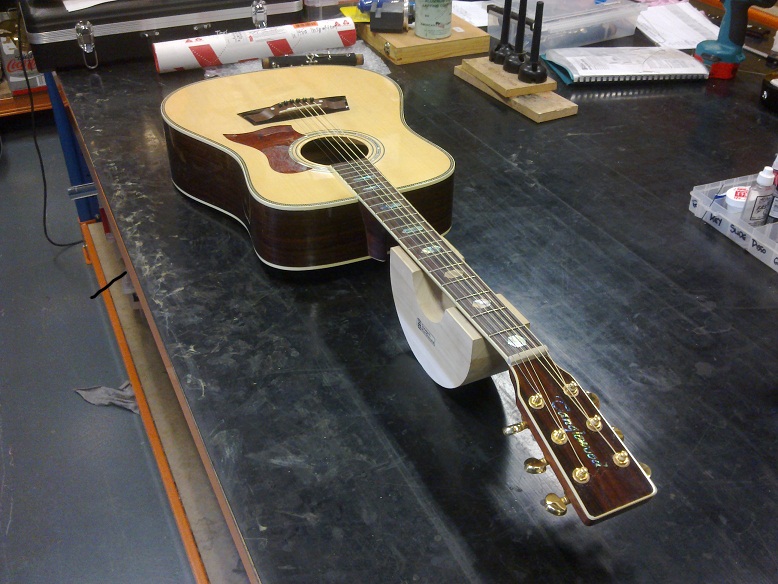

Post by simso » Fri Oct 14, 2011 9:25 pm

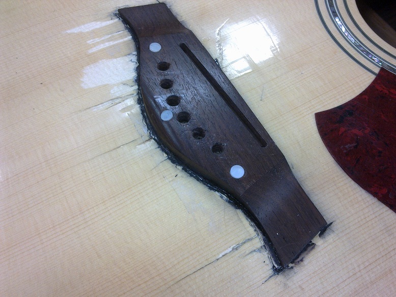

Hey this is a pretty looking guitar. Its suffering from a little bit of bridge tilt
Whats that black thing around the bridge

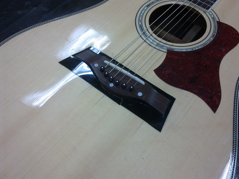

Post by simso » Fri Oct 14, 2011 9:53 pm
Had a repair maybe
2. closer inspection.jpg (178.96 KiB) Viewed 19904 times

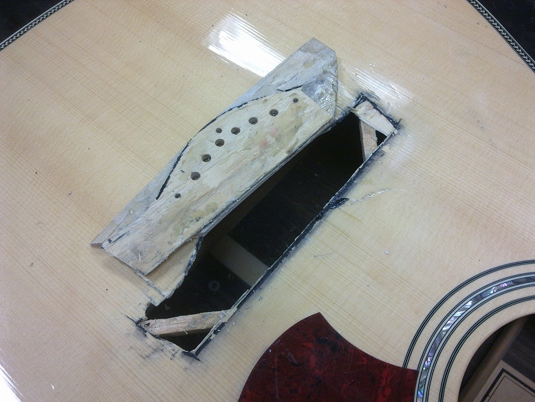

Really we should have a better look
4. What the.jpg (194.2 KiB) Viewed 19904 times

Post by Mark McLean » Fri Oct 14, 2011 10:44 pm
You have got to wonder what sort of nasty hardware is being hidden under those three MOP dots? This thing has really had its face punched in at some stage.

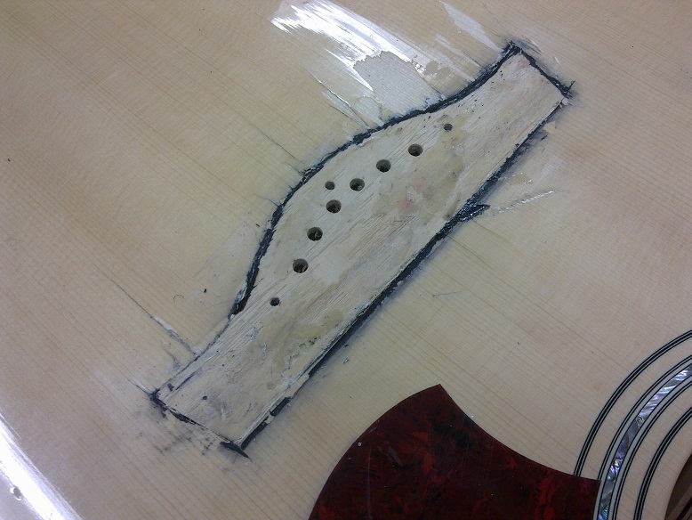

Post by simso » Fri Oct 14, 2011 10:55 pm
You asked and I shall deliver
6 You gotta be kidding me.jpg (171.12 KiB) Viewed 19891 times

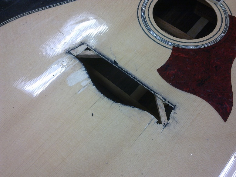

Re: I wonder
Post by simso » Fri Oct 14, 2011 11:13 pm
mmm, houston there is a problem
7 Houston we have a problem.jpg (188.59 KiB) Viewed 19887 times

Re: I wonder
Post by charangohabsburg » Fri Oct 14, 2011 11:50 pm
Oh, there is nothing (where the bridge was). I am sure that being a (even though self declared?) "Master of nothing" you will master this!

I can only imagine with amusement , the thought process behing that initial "repair" , Bridge lift's after going for the next Octave on every string , whilst using 13 - 56 strings , bridge meets Nut , owner says I get Johno to take a look he knows a guy , who drinks with a bloke that once watched a guy change some strings so he knows all about guitars , and besides he's a Plumber , Johno takes a look , gets out the stanley knife , says what this needs is some reinforcment , got some 12mm ply I use under dunnies , we'll sikaflex that in, she will be right , and then we can cover that excess sikaflex with some plastic off that old lawn mower catcher over there , Proper JOB !!!!!!!!!!!! :shock: :shock: :shock: :shock: :shock:

It's just a slightly enlarged Maton pickup hole isn't it. No problem.
Re: I wonder
Post by Nick » Sat Oct 15, 2011 9:42 am
Think you've found the cause of the bridge tilt Steve. Not sure it'll buff out though :shock: .

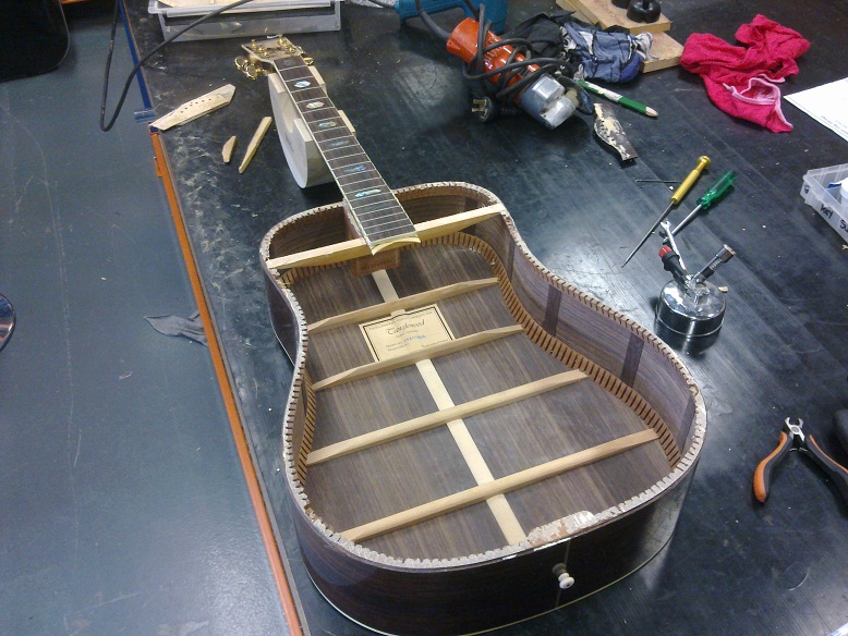

You can see here the different types of braces hes put underneath, but the fact hes cut the old braces off to put them in and then the old braces were not attached properly doesnt help either.
It will be purty again

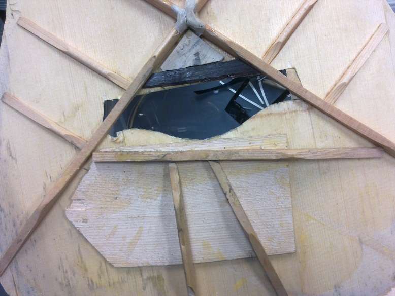

9 what happened to the barces.jpg (168.23 KiB) Viewed 19799 times

Looks like he has something against rosewood bridge patches as well. "Who the hell put that bit of brown wood on there? I don't want it there messing up the nice white wood of the top. I'll just hack it off with me trusty butter knife and an old screw driver"

I find it interesting to get a look at the top bracing (what's left of it) in a mass produced guitar. Common approach re layout and scalloping, but assuming braces are q/s and reasonably stiff, they still have a fair bit of meat on them - the safe approach in a mass produced setting.
