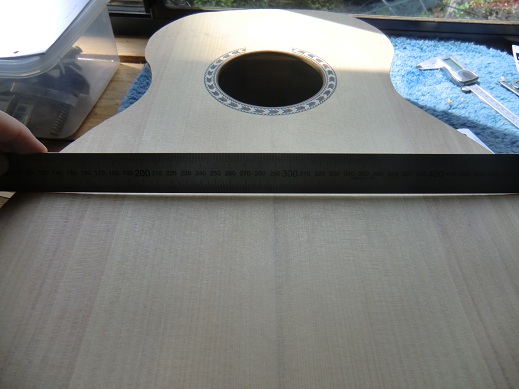

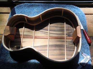

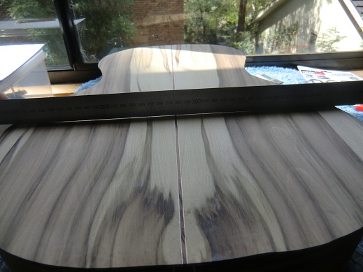

I am the latest member of the learn-this-the-hard-way-club. I work in a poorly sealed, unlined external shed with no climate control. I am well aware of the RH issue and thought I was clever enough to avoid problems. I have a RH meter in the shed and I watch the BOM observations closely and I wait until we have dry weather before I do any RH-sensitive stuff, like gluing bracing or closing the box. But - how much waiting is long is enough? I assembled the back and sides of my latest project. The top was ready for bracing but then we had a long stretch of damp and humid weather in Sydney. Seemed to be for months. I cut and shaped the top bracing and then waited......... It finally got dry. RH down to 48%. Next day I glued it up, then some carving and shaping - all OK. It had a pretty good 30' radius. Then some more rain so I had to wait before I closed the box. 2 weeks later it was dry again (admittedly only for about 24 hours - way too soon in retrospect) and I glued the top. We have now had a solid week of warm and dry weather. Take a look at it now. Both the top and the back are concave. I guess both plates are stuffed. I will probably remove them from the sides, route/sand the bracing off and start again.charangohabsburg wrote:Yes, this is certainly the most solid learning method - maybe the only one that really works.trevtheshed wrote:Have a top or back turn inside out just once and you never take short cuts again. [...]
The lesson is that you certainly need a number of days at low RH for wood to settle. The 5 day rule sounds like a good one.
Just found a dehumidified on E-Bay, in the next suburb, for $80. It is going to be a good investment!

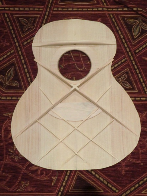

Just a comment about the bracing.
Is this a OOO model? If it is I would probbaly put another finger brace in as they are quite useful in countering bridge/bridgeplate rotation. Yours like a little light on in that area to me. The rest of it looks great.
If it's a OO or o model please ignore me.

Thanks Bob. It is a Gibson L-00 size and the plans only have one finger brace. But, as you can see, I copied your lattice bracing so I have departed from the plan already. Maybe another finger brace would be appropriate. It is interesting that with an increase in RH to around 60% today the plates are convex again. It is a fickle thing. Anyway - I am learning stuff, so that is good.

I think the extra finger brace wouldn't hurt, even on an L00 Mark.
They are very accessible through the sound hole if you think they need reshaping after the instrument is built.
