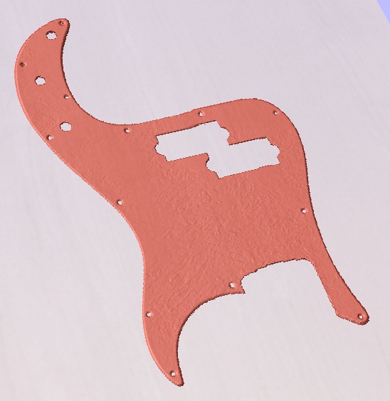

This is how the laser scanner is bringing them in, then Ive got to smooth the lines out with computer programs and reverse engineer it.

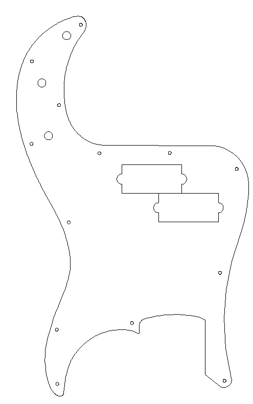

So, 30 minutes later of hand drawing vectors it now looks like this ready for a machine to be able to use.
Tommorrow I can do a pencil run and compare, and if it works then machine out the first pickguard
One down 12 to go.
Cost is an unknown at the moment, I used to charge for hand make pickguards 45-90 dependant on how difficult it was. Once these are drawn up and proof run, then its a max 10 minute job, but to get to that first magic point for each pickguard is a good hour or two of computer work.

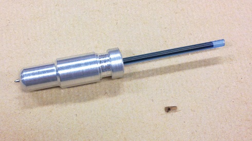

I had to machine up a sprung loaded pen holder for the cnc, so that way I can see what the job will look like on a piece of A3 paper. For sizing and correctness etc..Heres the little blighter, you wouldnt believe how long it took to make it. The top winds out from the bottom, which encloses a pen, with an inner spring which allows up to 3mm down pressure. This whole piece goes into a er32 collet which then gets fitted into one of the quick change tool holders
Lucky I did make it up, the porcess through three programs scanner / vectoriser / cnc software manages to shrink the job by a couple of mm, so got to stretch the job before I can cut it
