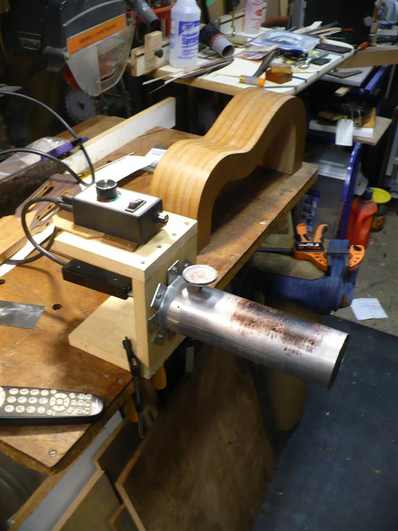

I know stuff is different where you are, but here is the one I made. My cost is less than $50. Parts = truck replacement tail pipe section from auto supply store (cut in half, split one half down the length and squeezed it inside the other half for mass), scrap wood, electric charcoal starter from a home improvement center (squeezed to fit in pipe), grill thermometer, jar lid in end, and finally a router speed controller for temperature control. I have a blanket and you can see the form, which I use as a check for my bending, but I still (working on #10 now) use the iron and hand bend. It's just too easy, and I get no spring back.

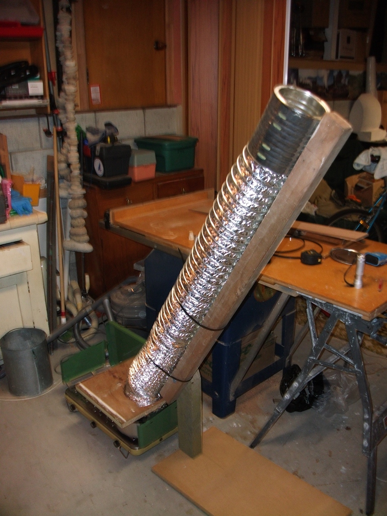

First time I bent sides, I steamed the wood in this, which would have cost us maybe $10 to put together;
It's sitting over a boiling pot on a gas cooker with a lid that channels the steam up into the aluminium ducting. The wood was then wrapped around some pegs on a form to create the bend. It did the job, but a bending iron is much easier and better, much less spring back (although a bending iron doesn't look like a missile launcher!). Jeff's idea of borrowing the use of someone else's would be the way to go if you don't want to spend the money (that's what I've done), but there are other ways.

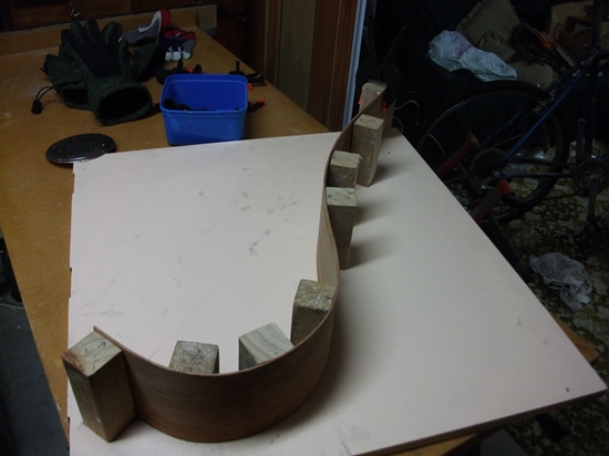

I come from a sailing family, so we just made use of what we know. The spring back is a real problem, I was using this to bend a teardrop shape for a Weissenborn and cooked the sides for at least half an hour. I can't see this process working so well for tighter bends around the waist, especially for a uke, but it's cheap enough to give it a go.
Here's the form I used, the touching faces of the pins are curved to the match the curve of the side. I didn't have any problem with splitting, the sides would have been about 2.2mm and could have been thinner to make bending easier.

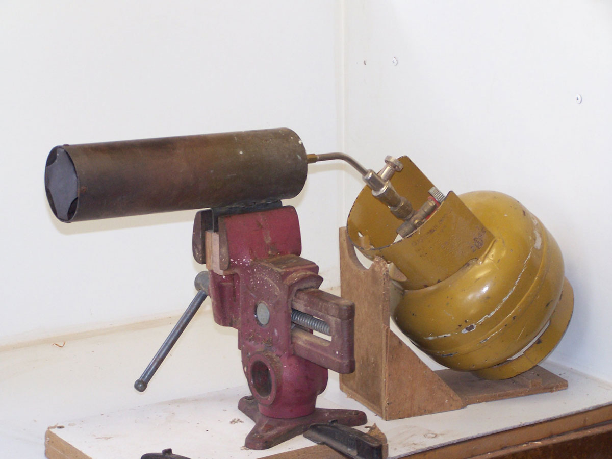

A length of 50mm diameter pipe and a propane torch. Should work just fine for ukes.

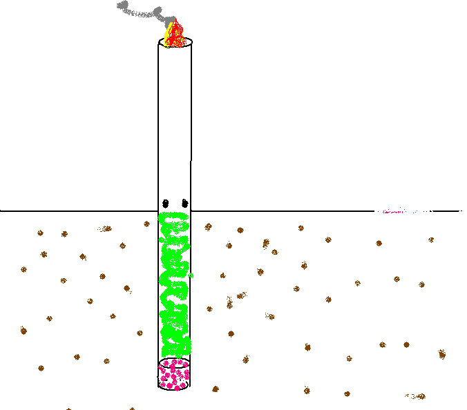

Just an idea, that could be the cheapest way to go.
I read once where an old way of bending was done in a brass pipe in which cotton wool balls soaked in metho were thrown in, the pipe was held vertical on the bench. it got me thinking that if you didn't have welding or brazing capabilities it could work like this picture.
If you got 800 mm x 75 mm pipe
plugged 50 mm at one end with silicon pink
Then drill breather holes ,four maybe half way up.
Pack just below the breather holes down to the silicon with a rag Green
Bury the pipe in the ground to just below the breather holes, pour in metho till the rag is fully soaked and light from the breather hole . the first time you light it it should be a gentle start up,when the first lot of metho is finished be careful when the second lot goes in to the hot pipe ,it will heat the metho and the slightest spark could set it off with a backfire, same for when you go to light it after the second fill, stand back.
I make smaller versions of this at work sometimes , with long thin tin cans to heat a chisel that is my waxing chisel, I hold colored hard wax to the hot chisel an can melt it in long runs, let it go half hard then shave the coloured wax flush with what ever I'm filling
It would be safe to try out side ,and if it works you could adapt to do at a bench later.
if it will hold 500ml of metho it should run for ? 30 minutes at a time.
Could be the 10 buck bender

The general rule for heat is that water sprayed onto the heated pipe should bounce off in little drops, rather than stay on and then steam off. One thing to think about if you are going to be bending uke sides is that the pipe should be of a smaller diameter than the tightest bend in the sides, usually the waist or the upper bout. That is why I suggested a 50mm diameter pipe. Any scrap metal yard should find a length of 50mm pipe of some kind quite cheaply. It is also useful to mostly close the open end of the pipe off to keep the heat in. The pic I posted has a piece of copper sheet roughly bent to shape and pop-riveted in place.
