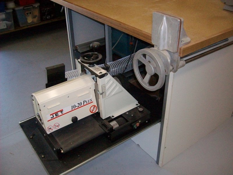

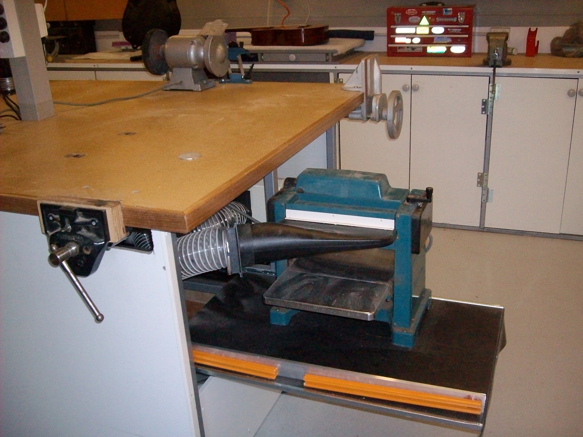

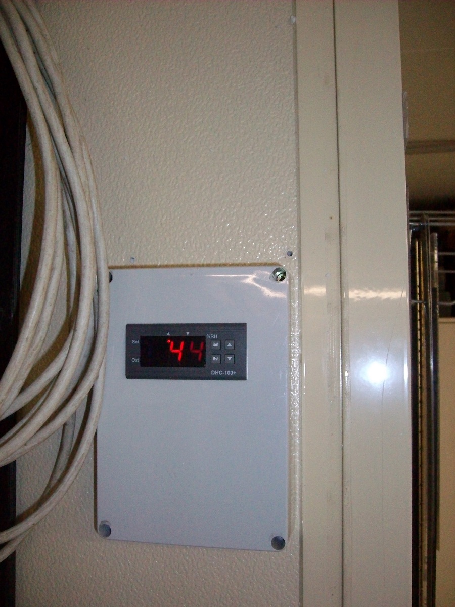

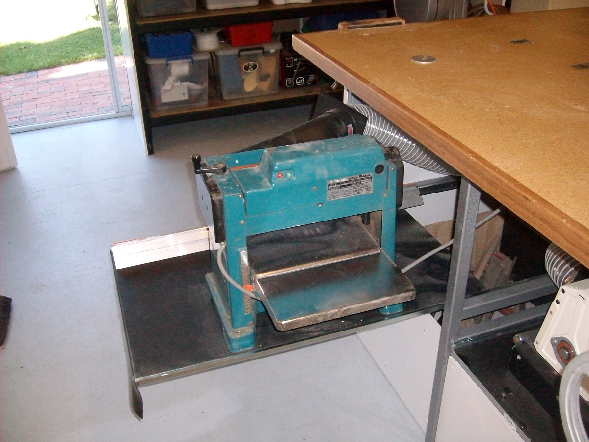

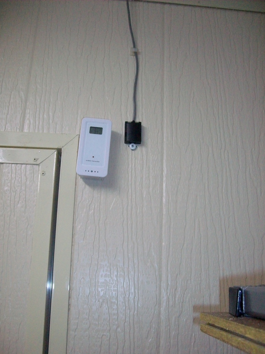

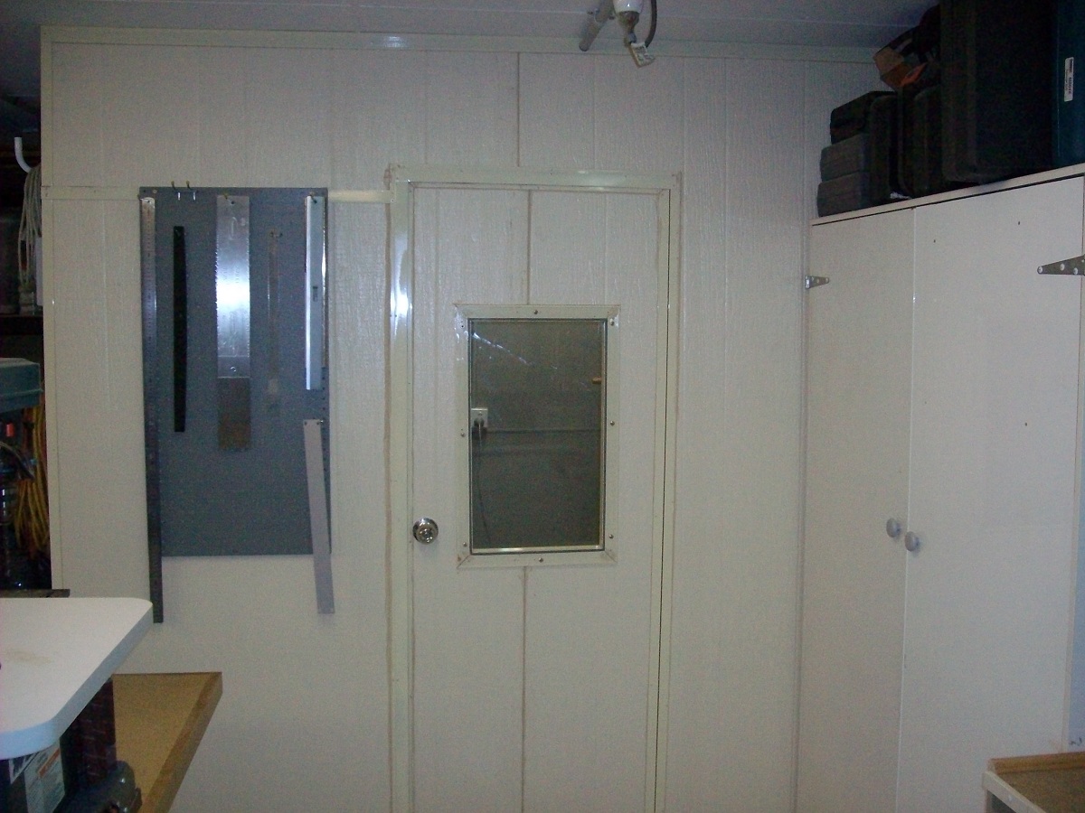

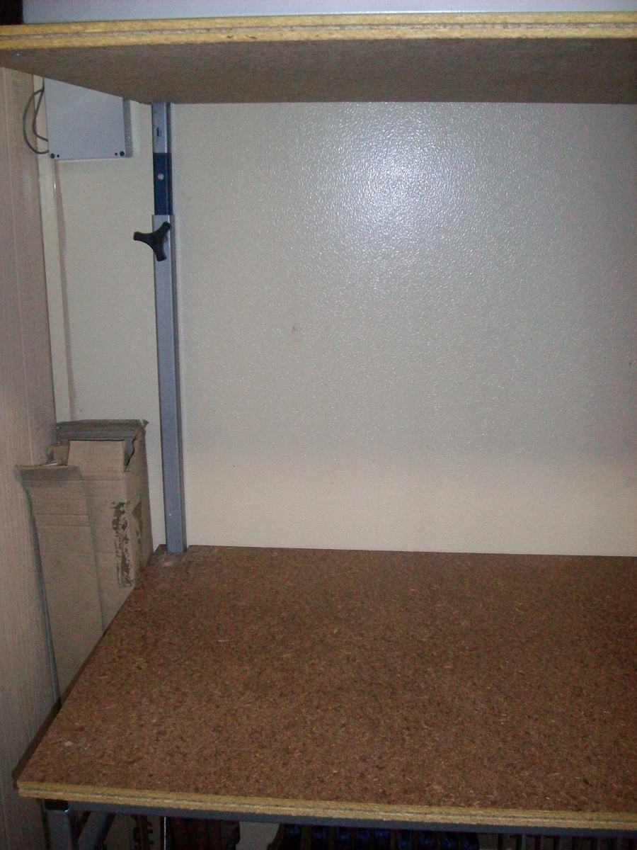

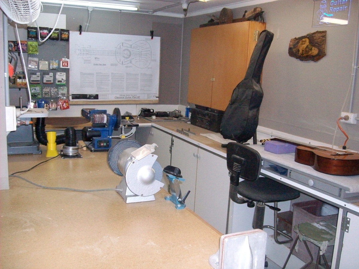

After some consideration , and taking into account the collective wisdom of a the Forum , I decided on a Dry room , the Biggest I could make it was 2.4 X 1.7 Meters which considering my Whole workshop is only 5.5 X 6.0 is a far chunk of workshop, I decide for the sake of speed , cost and Insulation to Go with foam sandwhich panel aluminium/styro/aluminiun , comes painted is easy to cut and install , I went to the Local home improvement place who eher more than happy to do me a deal on some orphan/ dented panels , and the associated c section to make the dors and hold the whole lot tegether I installed the whole thing in about six hours , including laying an el cheapo laminate floor with a vapour barrier underneath , the knock on effect was that apart from losing a fair chunk of my workshop , my bench was now too big and in the wrong spot , so I decided on a whole of workshop Re hash, which was a mission , but I'm pleased I did it . fisrt I installed the dry room complete with adjustable go bar deck /gluing bench/ clamp storage , the dry room also became home to my Humble W.A.S stash .the room is fitted with a Hygrometer/ controller that incorparates a 10 amp relay , to swith the Dehumidifier on and of at the desired levels , I have not hooked it up yet as I monitoring how well the inbuilt sensor works , which seems to be hovering around 44 - 46 % so I may not need to use it for control .

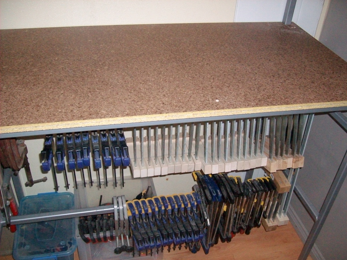

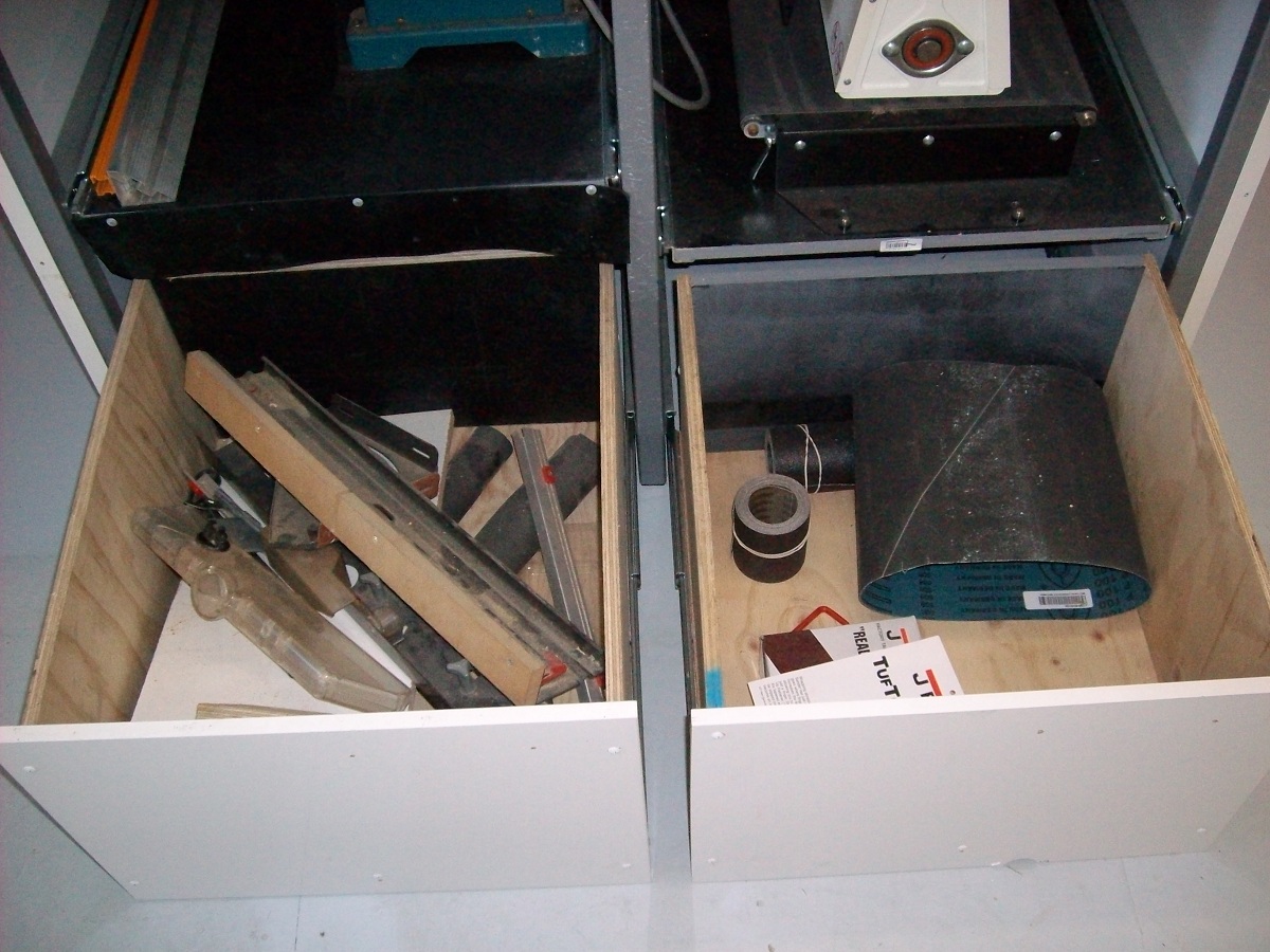

I also decided to redisign my Workbench , Getting out my Thicknesser and drum sander has always been an ordeal , as has attactching it to the dust extractor, so I fitted the bench with two slide out shelves with two storage drawers underneath at the other end of the bench ist the dust seperator bin that catches the bulk of the dust and large chips , connected to the dust extractor motor with the collection bag and filter to be Installed outside connecter via pipe , so once the dust leaves the workshop it leaves for good , even the really fine stuff .
The local Joinery is really generous , and gives me a call when they are having a clean up , so this year I scored some 1800 X 2400 cover sheets , a heap of doors , which wre all sliced up to make various cupboards and storage , including my setup bench . Good to recycle I say . anyt way there are some Pic's .

Looks great Paul, should not use much power to run

After some consideration , and taking into account the collective wisdom of a the Forum , I decided on a dry room , the biggest I could make it was 2.4 X 1.7 meters which considering my whole workshop is only 5.5 X 6.0 is a far chunk of workshop, I decide for the sake of speed , cost and insulation to go with foam sandwhich panel = aluminium/styro/aluminiun , comes painted is easy to cut and install , I went to the local home improvement place who were more than happy to do me a deal on some orphan/ dented panels , and the associated c section to make the dors and hold the whole lot tegether I installed the whole thing in about six hours , including laying an el cheapo laminate floor with a vapour barrier underneath , the knock on effect was that apart from losing a fair chunk of my workshop , my bench was now too big and in the wrong spot , so I decided on a whole of workshop Re hash, which was a mission , but I'm pleased I did it . fisrt I installed the dry room complete with adjustable go bar deck /gluing bench/ clamp storage , the dry room also became home to my humble W.A.S stash .the room is fitted with a Hygrometer/ controller that incorparates a 10 amp relay , to switch the Dehumidifier on and off at the desired levels , I have not hooked it up yet as I monitoring how well the inbuilt sensor works , which seems to be hovering around 44 - 46 % so I may not need to use it for control .
I also decided to redisign my workbench , Getting out my Thicknesser and drum sander has always been an ordeal , as has attactching it to the dust extractor, so I fitted the bench with two slide out shelves with two storage drawers underneath at the other end of the bench ist the dust seperator bin that catches the bulk of the dust and large chips , connected to the dust extractor motor with the collection bag and filter to be Installed outside connecter via pipe , so once the dust leaves the workshop it leaves for good , even the really fine stuff .
The local Joinery is really generous , and gives me a call when they are having a clean up , so this year I scored some 1800 X 2400 cover sheets , a heap of doors , which wre all sliced up to make various cupboards and storage , including my setup bench . Good to recycle I say . anyway there are some Pic's .

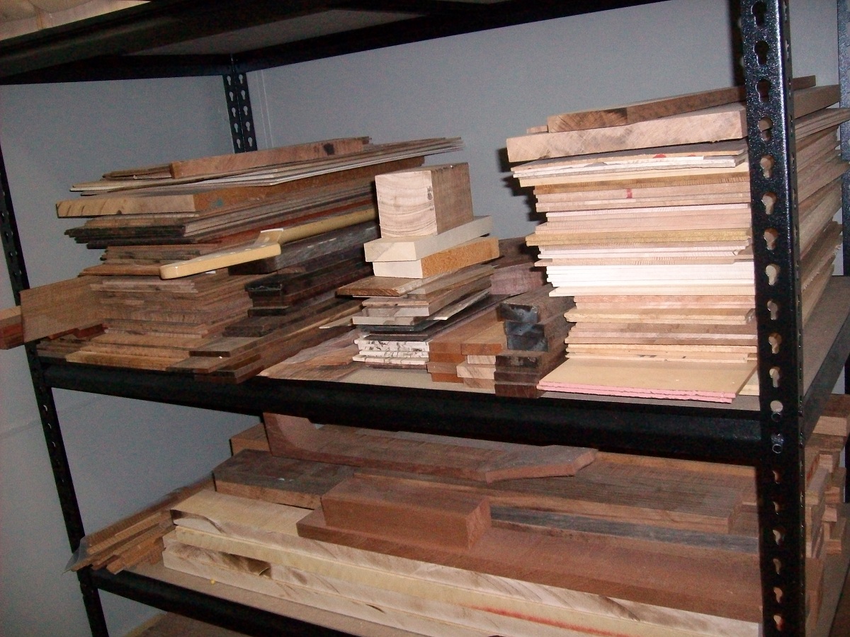

Good work Paul,
I store tops and any working project in the RH controlled area but leave the backs racked out in the main shop so they can move with changes in RH. There is a difference between dry wood and "seasoned" wood, but soft woods like spruce are not so effected as they are less dense and in most cases, should have little in built tensions due their straightness of grain.
Backs however are very often figured or have waney grain making them attractive. But of course this has them far more likely to present internal tensions. They are also far more dense so their cycle of reaction to extremes of RH is much slower than that of soft woods so as they make their way toward equilibrium with an ambiance of higher moisture, chances are conditions will then change before they ever actually get there. This leaves them moving back and forth somewhere between the two extremes of soft wood.
The problem is however that with greater density comes much greater power and in built tension therefore has greater potential to be destructive once it has been restricted by bracings across the grain. So its important to let 'new wood', that is any fresh sawn wood that has been 'dried', to then become acclimatised to the expected swings of RH in 'your' area. I regard this process as true 'seasoned' of the wood. The idea is that as time passes and the wood is allowed to take in and give up moisture from and to the air, that smaller but more powerful movement with changes in RH will decrease making the wood more stable. But you do need to keep everything well stickers so it remains flat throughout the process. Here's how I store mine.
I won't say that doing this will 'eliminate' all unwanted movement, but it does appear to reduce the problem somewhat by making the wood more stable in time. The point is that I feel this would probably not work so well if the wood was stored in a controlled environment where it pretty much just sat there doing nothing. Of course when you are to build, then you would pre select the required back and sides moving them into the controlled area some weeks before.
