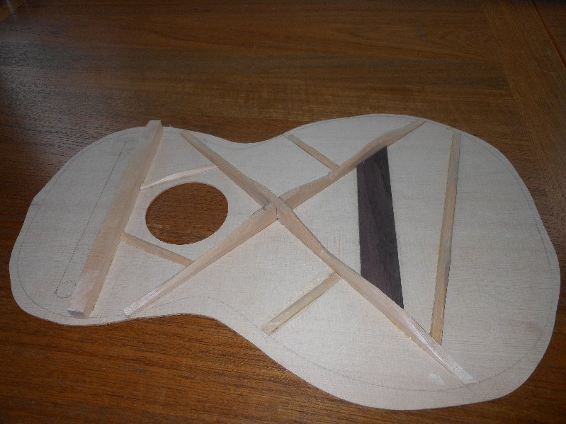

Here is a picture with the braces rough carved:
The Frets.com pictures make it very clear that I am substantially over braced. I am going to pull about 1/3 the height off of the x-braces, and thin the top down some. Currently it is around 2.9 - 3.2 mm, depending on where I measure it.
Thanks for the advice -- I'll post more as I progress. If I thin it too much and it implodes, I'll post the disaster, too. :)

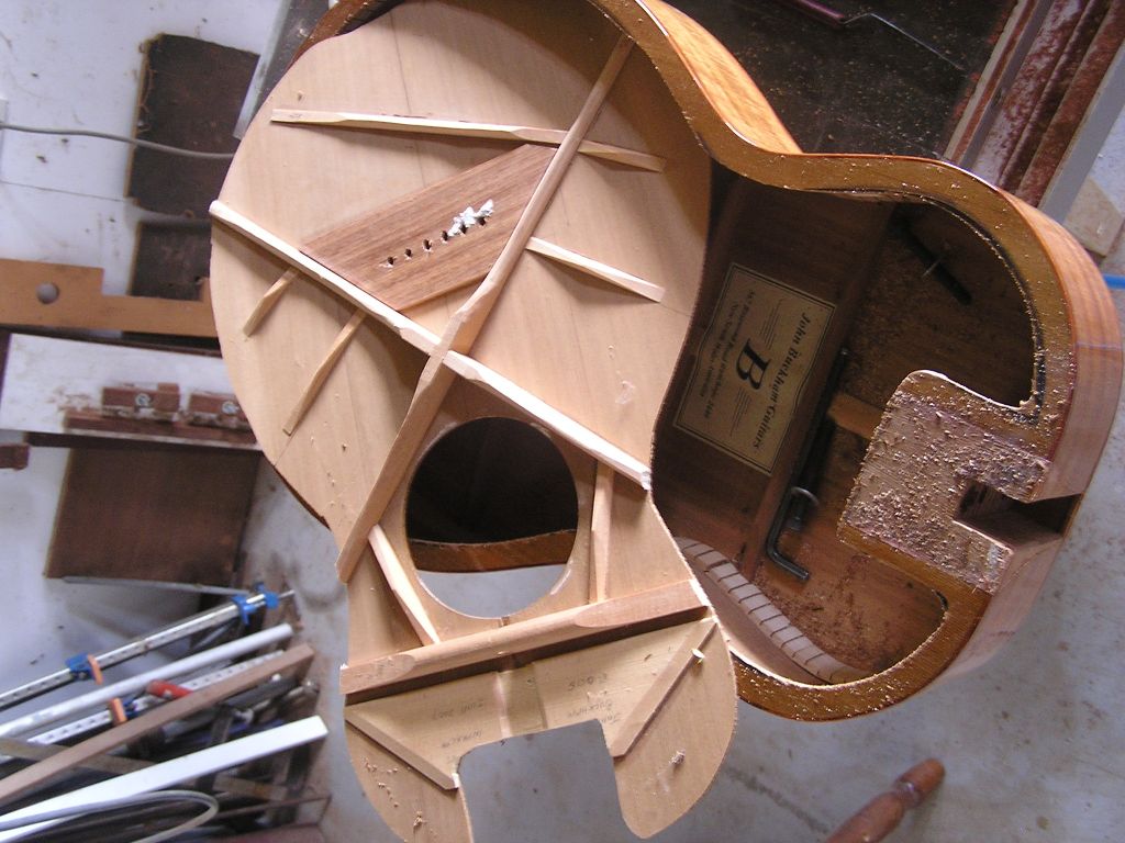

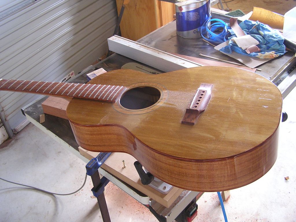

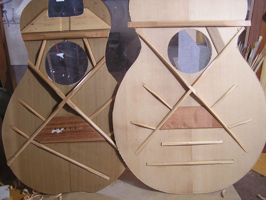

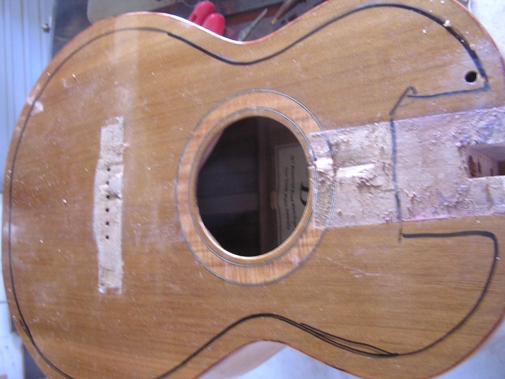

Hi Paul, here are a couple of pics of my Parlor that I mentioned earlier in this thread. It was my 4th instrument after finishing my first 3 from the Cumpiano Book. I thought I knew everything when I finished them and to prove that I would "design" my own guitar...I came up with a pretty horribly proportioned parlor that I was never happy with really. I lent it to a friend to play and he wanted to buy it from me, which he did...but as I mentioned every new guitar I made and showed him his guitar sounded worse and worse so I said a couple of weeks ago that I would take it home and rip the top of and put another one on that would make it sound much better. I ended up using a top that got too thin for a larger guitar and that had also got damaged by having about 1 1/2 inches split off the edge...So I reglued the piece back on the edge and decided to use that on the project. The top is some Sitka that I got from Gilets about 3 years ago and it had "8 years air dried" penciled on it so it is well "aged" I suppose.
With regard to the braces I used old tight Douglas fir that are 6mm wide and about 13mmhigh at the intersection of the x. The original bridge plate was about 3.2 mm thick blackwood (way too thick) and on the new top I have used 2.5mm Forest Oak which I find makes great bridge plates.
I also got to address the issue of neck balance. I originally made the neck from Blackwood that was very dense and that made it very neck heavy. I thought about it for a bit and said to myself "if I can pull the truss rod back out of its slot then I can saw the fingerboard off and the headplate with the inlay in it off and reuse them on a new neck of lighter timber. The truss rod came out easily after I took the tension off it. I then sawed the fingerboard and headplate off and scraped the old glue and sliver of neck timber off and made up a new neck from Aussie Red Cedar which will be much lighter and should be strong enough as its a short scale and has a truss rod.
So I am glad that I have done it (squirted some lacquer on it yesterday) and I know that its owner will appreciate the sonic upgrade. I will post some of it when I finish.
I thought that I would post and tell the tale as your situation was pretty much the same with your parlor and its bracing.
...anyway here are a few pics...

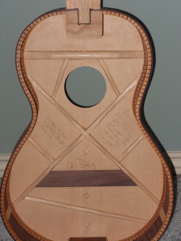

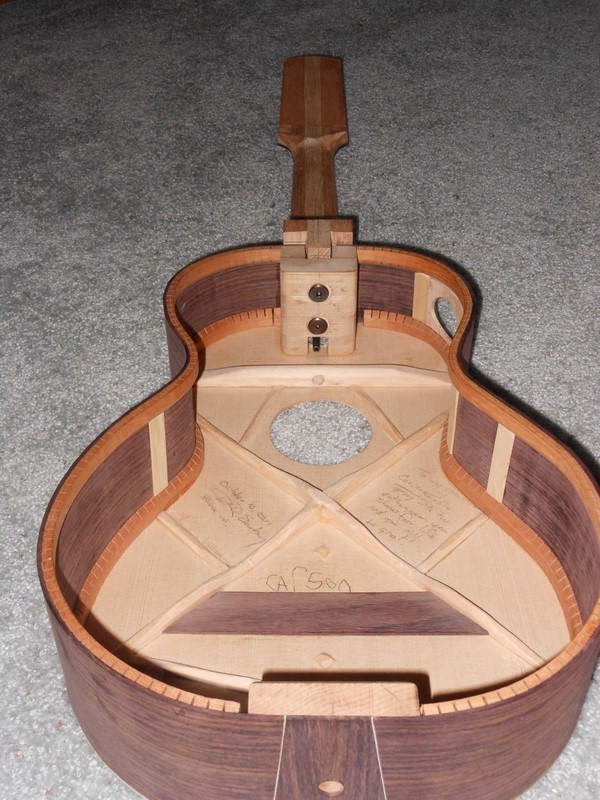

Anyway, I finished carving the bracing down. Doing it at the awkward angle imposed by the attached ribs was a new kind of exciting. And I did it without gouging the top, too! :cl
Here are some pics -- the neck is still just rough carved (obviously).
I had my grandson sign the soundboard -- I figure if he keeps it long enough, his kids can have a laugh at his expense. Assuming they think to get a mirror and have a peek inside...

Hi Paul, It is not too difficult if you have the right kit! I used a laminate trimmer set to just shy of the top thickness and skipped that around the edge after I sawed the top off. Then I sanded the bindings and what was left of the top from the linings on my radius dish sander that a friend helped me make from an old lathe headstock and faceplate. So I aim to sand the old glue just off and there I am back to being ready to glue a new top on it. I will post a few picks when I am finished. Actually I made the original instrument before I had radius dishes to I lost a bit of body depth. About 1/4 of an inch.
Your parlor looks good...I haven't done a sound port yet so thats something I have to try!
Also were your braces 8mm (5/16 in) or 6mm (1/4 in)? Mine are 6mm on the new top...it makes a difference too.
John aka WoodRat
