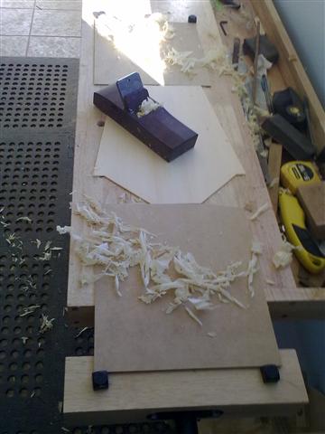

Woodrat's review of the above mentioned book's mortice routing jig reminded me that I've been meaning to post about the Plate Thicknessing Board - as described in section 6-1, page 6-4 of the 'Build' book
For those who haven't seen it, it's just a flat board with a row of tacks along one edge hammered in until the heads just poke up above the surface.
Place the plate on the board and plane towards the tacks - no clamps required.
I used to clamp my plates end-on between 2 pieces of 3mm mdf that I had planed down to 2mm.
I used dogs on my vice & on the table to provide the horizontal clamping.
This gave me clearance at either end for the plane and access to the whole surface.
However, too little clamping pressure and the plate would slide free, too much clamping pressure and the plate would 'bow' up.
A picture's worth a thousand.......
So I gave the 'board with tacks at the edges' a try.
And I like it.
I made mine with a lip underneath so that it goes onto the bench like a shooting board.
Then I can just slap down my plates on top and start thicknessing.
It also makes thicknessing down small pieces like headplates easy to do.

Whilst quite a few texts/teachers recommend it, I would avoid planing on a skew (which you might be doing looking at the pic you posted). Whilst I haven't checked every pic in the books, I doubt you'll find one with the plane shown skew. I've always planed "in line" and it's just the way I work. There's a reason (had to be!). When you push the plane skew, you effectively lower the angle of attack of the plane. So a high angle plane (like the HNT Gordon you have pictured) becomes a lower angle plane, depending on how far you skew it. So on curly back/sides timber you loose the benefit of the high angle unless you push it in line. Now, you're clearly planing a top, so you might have skewed intentionally to drop the effective angle. Works fine, but you then run the risk of dropping the back of the plane off the edge of the wood (and you know what happens then, unfortunately, if you use the tack board). There's also a greater likelihood of "unhooking" the piece from the tacks.
I've found softwoods to plane better using standard angle (I'm fortunate in having a lot of angles to choose from). When working tops I tend to use a standard 5 1/2 or a 7, planing in-line. I have a HNT Gordon plane which looks the same as yours. I seldom use it, because keeping the bottom flat required too much maintenance. Works great as a scraper plane though, with the blade reversed, when a card type scraper leaves too many ridges, but I can mostly get by with my other high angle planes.
Planing thin wood into a stop is a delicate job at the best of times, but I've always done it that way and still do. It takes a bit of getting used to, though.

Thanks Trevor.
It's an old photo that just happened to show the whole of the setup I was using.
As you mentioned, it's a spruce top in the photo so the plane is skewed for that reason.
I have a Record No.6 that I use for planing guitar tops (I used to use a Clifton 7 like in your book
, but found it just too big for me for this)
But the in the picture it's a uke top, and a smaller plane is more managable for me over the smaller surface.
I've since picked up a Record No.3 for this purpose.
For the hard woods I use the HNT Gordon Trying & Smoothing Planes.
I was planing down a hardwood headplate when the 'incident' occurred....
