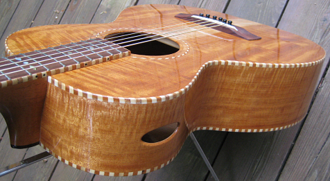

I made my own using the techniques in John Bogdanovich's book Classical Guitar Making. Had to adapt somewhat to get to what I wanted, but the basic how-to is there. Allen's point about having veneer on both sides when bending is important - otherwise the binding wants to come apart pretty easily. I had the most trouble with bending the rosette and went through 3 or 4 attempts before getting a good one. I want to say it was all worth it (although I think the guitar looks great), but not sure I'd do it again until the memory fades a bit more! It's a lot of work. Attached is a picture...the guitar was based on a late 1920's Weissenborn Model "D" "Spanish" style.

Hi Loren, Very nice guitar and very unusual look!
Can you tell us what the top wood and back and side wood are?

Hi John and thanks. The top, back, sides and neck are all curly Mahogany from Hibdon Hardwoods. Fretboard and bridge are Madagascar RW and the rope is poplar and mahogany. The original Weissenborn that this was patterned after was posted on Bernunzio's vintage instrument website several years ago and looked very similar except it was all Koa instead of Mahogany.
