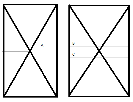

An interesting discussion came up on another forum about the structure and stiffness of X bracing. Unfortunately that discussion turned into one of the most personal and distasteful threads I have ever seen on a guitar makers forum. I thought I would pose the question here for two reasons, 1. to see what people think and 2. to see if us Aussies can conduct ourselves in a more mature and constructive manner. I suspect the answer to 2 is of course we can so I am keen to hear what people think.
OK the proposition is, the junction of the X brace is the stiffest, strongest part of the X structure.
The answer is may seem counter intuitive but is no, the junction of the X brace is the weakest part of the structure.
A few caveats to ensure we are talking about the same thing.
Here we are talking about the X braces ability to resist string tension which means we are examining the stiffness at 90 degrees to the grain and we are looking at sections taken through the X brace and the top to identify the weakest section through which the braced top might fail. We are not talking about the influence of scalloping or secondary braces and the X can be capped as long as it remains the same size as the X legs. We assume the joint is perfect and introduces no structural weaknesses into the junction. These are to ensure we are only talking about the contribution of the X brace to the structures stiffness. OK
Here is my explanation.

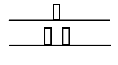

With braces 10mm high and 6mm wide, the junction as a horizontal cross section through the top will have the top and a section of bracing 10mm high by around 8mm wide depending on the X angle. As you move back or forward of the junction, the total area of bracing increases until a cross section reveals 2 brace sections 10mm high by 8mm wide. That is, twice the brace area as found at the junction of the X brace. Here is a picture to show what I mean.

Yes that was a nasty thread, not just because of differing opinions or even ignorance, but because of a huge amount of malice on the part of one individual.
Structural analysis is often a difficult and involved process, I am rusty on it now and scientists and even engineers trained in other disciplines such as electrical engineering often have a very limited understanding.
The diagram Dom shows has it's limitations for a material like timber with directional fibres.
Look at an older gibson where they ran one brace through and butted the other braces against it.The butted glue joints from the end grain would normally be considered to have no tensile strength and so the crossection at the joint would only retain the Flexural rigidity of the one continuous brace
A lapped Martin Style brace would be slightly stiffer, and a capped lapped joint even more so but still not up to the stiffness of two individual braces
So I guess the answer from my viewpoint would be that it is pretty hard to detail an intersection in timber so that it is not the weak point.

Just to clarify things I am assuming an arch built into the braces(otherwise its flexing inward would require the sides to pull in not push apart) and leaving out any effect of the bridge, which would add to stiffness and help spread load if it is fixed, simply spread the load of the strings if it is floating. The most flexible point on the braces would be somewhere between the sides and the x crossing on the longer lower arms of the braces. Where exactly would be determined by the stiffnes of the sides relative to the braces. Just my opinion. I am in no way a structural engineer or makinig any such claims.

The point is to fully understand the structure we are using. I was not trying to say don't use an X or any other motive. Its just always a good idea to know why we do things and the properties of the structures we are using. I've seen this come up a few times lately so I thought I would see what we think.
Philstix, you are talking about how much the brace deflects and you are right, it will almost always be closer the middle than the ends. But this is different to the stiffness at every point down the lenght of the top.
Here is another pic from above. Even is we remove any structural impairment from having to lap the X the result is the same.
The first plate corresponds with the top pic above. So the longetudinal stiffness at any line other than A is supported by twice as much brace material than at A. If we accept this then we must accept that A is the weakest point.

OK Jeff, go for it. Where did my analysis go wrong?jeffhigh wrote:
I still disagree with how you are looking at the stiffness at those two crossections, But at least here we can discuss things with respect for each other.

Well one of the main issues is that at crossections B and C, the braces pass through the crossection at an angle.They are not symetrical across the section.
They are actually less stiff against bridge rotation around this crossection than if they went straight through.
Your diagram shows an increase in brace crossection here and directly relates that to stiffness.
It doesn't quite work that way

Hi Jeff, I thought we all selected brace sizes quite deliberately and then carved them to change their area of the brace exactly because it is directly related to stiffness. We reduce brace sizes to reduce the stiffness of the top. The cube rule relates brace dimensions to stiffness.
And, the angle of the brace legs at B and C to the string pull is the same as at A. If the junction is cut perfectly, the cross section at A will also be exactly the same area as one of the legs at B or C and have exactly the same grain direction.
So how does it work and why is section A, which has half the brace area as at B or C somehow stronger/stiffer?

That's because we are looking at the X brace in isolation, rather than a fully X braced top. But even so, it would be near impossible for a finger brace to stiffen the junction but not also stiffen the legs of the brace either side of the junction so all you really get is a proportional increase in stiffness of both the junction and the legs of the X in the vicinity of the junction. Even if you could, you would only need to do this if the junction is inherently weak.kiwigeo wrote:Um, nobody's mentioned finger braces........

Definitely not stronger or stiffer at section A, just not down at 1/2 the stiffness, somewhere above that depending on whether you have a close fitting joint and use a cap you can approach equal. You have forces acting in two directions along the braces where they meet.Dominic wrote:Hi Jeff, I thought we all selected brace sizes quite deliberately and then carved them to change their area of the brace exactly because it is directly related to stiffness. We reduce brace sizes to reduce the stiffness of the top. The cube rule relates brace dimensions to stiffness.
