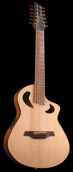

A while ago I was in Mandolin Brothers on Staten Island, New York - one of the world's great guitar shops. I admit that I was actually there to buy a banjo :oops:, but anyway - on with the story. It was 5 minutes from closing time and I was waiting for a cab to take me (and my very patient wife) back to the ferry. Stan (the proprietor) shows me a Viellette Terz 12-string that he has just got in - like this one.
veillette terz 12 cutaway.jpg (24.19 KiB) Viewed 29979 times
It is not easy to tell the size from the picture but it is a small Terz style guitar - 13.5" wide lower bout, 3-7/8" thickness, 22" scale length, tuned a third higher than a conventional guitar. It was a stunning sounding instrument (a bit mandolin-like) and really fun to play. I only got to play it for a few minutes but I now have a craving to make something similar. I didn't get much of a chance to check out the construction, and now I am starting to muse over how it might be braced. I will email Joe Veillette to see if he will let on. But I also thought I would ask the brains trust what you know about bracing styles when you don't have to work around a central soundhole. Here are a few that I have found while searching the www. I'd appreciate your thoughts

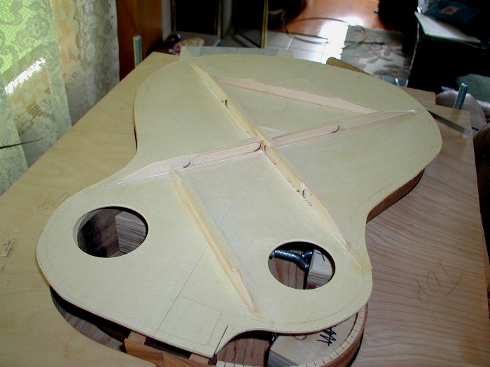

top bout holes.jpg (77.25 KiB) Viewed 29979 times
Here's a Mottola guitar - styled like a Tacoma

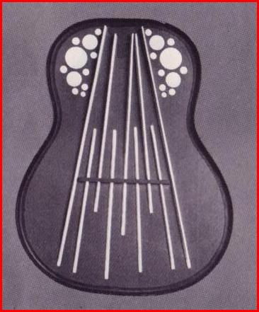

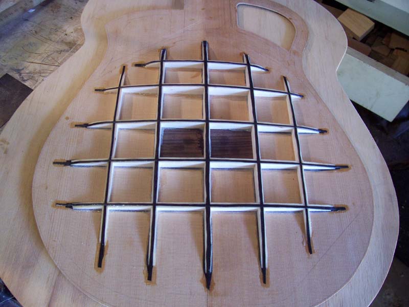

The dreaded Ovation Adamas
Adamas ovation Bracing.jpg (29.84 KiB) Viewed 29979 times

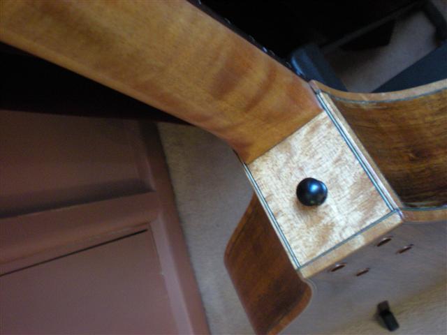

You are right Allen - a standard X would be fine for the lower body. I wondered what to do in place of the traditional upper transverse brace since the holes definitely sit in that zone. But more on that in a moment. I also need to explain how the neck block works in Joe's design. He has a heel-less neck that slots into a routed cavity in the neck block, which must be pretty hefty and have an extension under the fingerboard. A bolt incorporated into a strap button on the back goes right through to the neck extension. I have a Baby Taylor which uses the same concept (but less elegant with screws from the front which show in the face of the fingerboard). Kim's memorable F11 "Matey" project was similar. Here is what the Veillette looks like from the back:
Veillette neck joint 2.jpg (6.58 KiB) Viewed 29901 times
So, the neck area must have a pretty strong block, and if I added soundhole reinforcements on each side (like in that Mottola guitar I showed above) the whole upper bout area would be pretty robust - even without a traditional UTB. What do you reckon?

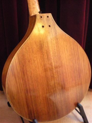

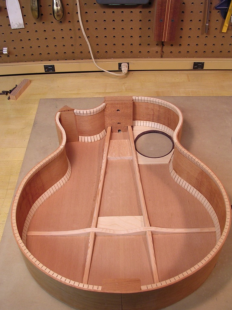

Mark, Graham McDonald uses a similiar neck joint on his irish bouzoukis.
Here's a pic of mine made using his plans.
The four copper tube lined holes (graham uses brass) are for access to the neck bolts.
The neck block, though large, is made as a frame (think hollowed out) to reduce weight.

And Graham has a picture of his neck block on his website

jeffhigh wrote:Proponents of the flyng buttress believe that you can transfer the load from the top of the neckblock to the bottom of the sides at the waist. There is not often an explanation of how the force gets from there back to the bridge. Personally I am not convinced of the need.
Well in my case the main aim of the flying-buttress braces is so that I can brace the upper bout for tone and not structure - there are subtle but very important things that happen there. The tops of my instrument are not in contact at all with the neck or fingerboard and the upper bout is very lightly braced. I'll let engineers draw their force vector diagrams but the rimset top and backs are integral structures and there are plenty of ways for the forces to go back to the bridge. The Larson Brothers used hollow tubes that connected the neck and tail blocks - as does Haans Brentrup, a modern builder. I suspect that similar principles apply.

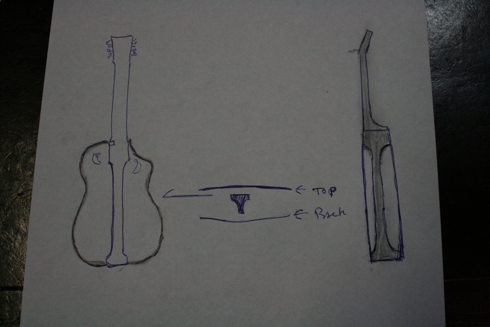

What about a through neck acoustic,assembled like a guitar with a Spanish heel,with the through neck part within the body cut back for space for bracing the top and back ? Built strong enough it will never need a neck re set [ and cant be] , and the whole top gets to move with string vibration,where as normally it slows down above the mid hole design, because of the UTB and the popsicle.

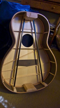

Re: how to brace when the soundholes are in the upper bout?
Post by Mark McLean » Tue Nov 08, 2011 11:07 pm
Interesting concepts. I am starting to realize the importance of the appropriate transfer of the forces delivered to the box through the neck block. It is not just a compressive force - also rotational as the entire neck wants to pitch forward and fold the instrument in half. There is an obvious advantage in not having that directed through the upper part of the soundboard. I have seen the dramatic effect that a "Bridge Doctor" has on the tension and shape of the lower soundboard by bracing the rotational force on the bridge against the solid end block. I assume that the buttress does the same thing for the neck block?
Here is a picture from Hans Brentrup's website of the system that Dave referred to.
brentrup carbon tube bracing.jpg (39.62 KiB) Viewed 29713 times
Rob, would this do the job that you were indicating?
What would be the differences between this and the buttress to the sides layout?
Where is a good source for the carbon rods or tubes that would be used for this?

I put that suggestion up, but I am a P plater round here with only 1 build under my belt so far,compared to the others that are giving you info as well. so it's a question as well, would it do it ? or why not ?
I think that picture with the Two CF rods looks better than the timber drawing I did , and without the center hole one each side of the blocks looks like it will do it , but what stops the string tension from pivoting the neck at the head block and CF rod point ? apart from the top, there is just two sides and a back. the two sides are basically springs ,and the back would be great if it were straight,but it has a radius in it that I would think would like to straighten out .
So I'm now wondering , could you do a third CF rod in the center bottom from the head to the end block which had a threaded rod in side to give the back more tension? problem is you can see it.
Or could you give the back a Timber center spine to do the job better ,that the two back plates join to, rather than the cross grain strip ?
Or is the normal back set up fine ?
