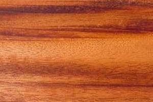

Well...
I'm going to go against the grain here and suggest it reminds me (by appearance) of some Goncalo Alves -
goncalo alves.jpg (25.9 KiB) Viewed 22640 times

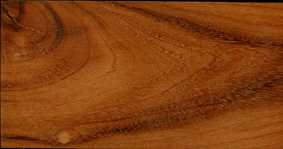

Goncalo Alves however is very dense and heavy. It also looks like some Burdekin Plum I've used, a poor photo for reference unfortunately -
Pleiogynium timorense, Burdekin Plum, Australia.jpg (244.19 KiB) Viewed 22640 times
But you are unlikely to have heard of that - even within it's home territory it is not widely known.
Then there is Monkey Pod... :roll: So many timbers on this planet. 8)
