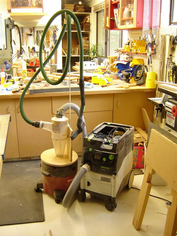

Allen wrote:
Use a dust extractor if you've got one. Don't even think of using the vacuum. It will kill it in minutes. I did mine outside on the driveway with a dust extractor and still managed to cover the surrounding houses in a layer of dust.
You guys have got to get a cyclone for your vac.
Heres mine and it works brilliantly. Cheers Dom
