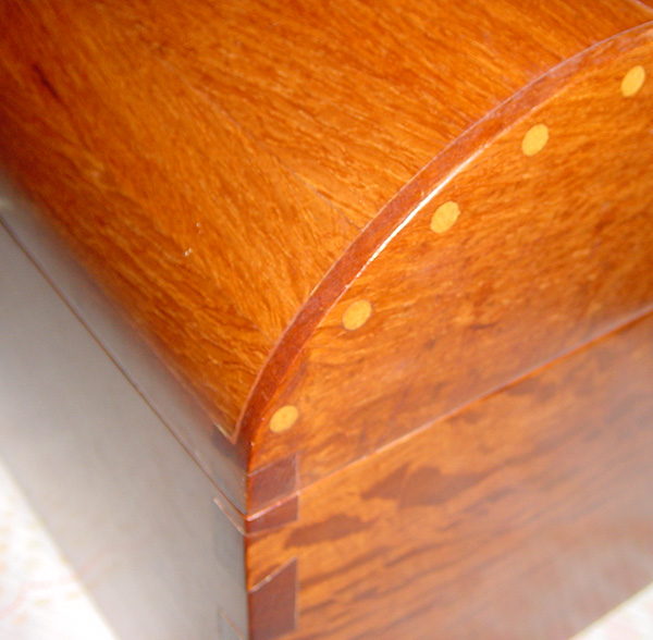

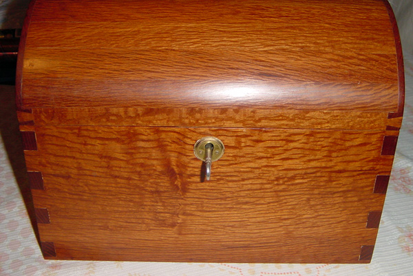

That's a ripper of a chest! Is it Sheoak or Silky Oak? or No Oak?

Thanks..The chest is WA Sheoak, the draw bore pins are Tassi oak...It represents one of my first (and last) ventures into electricity free projects...The only machine used was an old Stanley hand drill....Thank goodness the lights came on and I woke up to myself :D In my defence I had just come from a number of years in building and stair construction and had had my fill of the sound of both static and hand powertools....still don't like the sound of hand powertools that much, but the sound of a good cast iron machine whirring away can be music to the ears.
