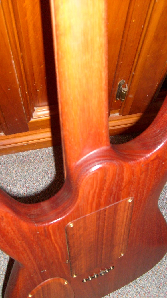

To actually test this situation you will need to remove the neck from the equation completley as per attached picture.
Then you are only testing the body, to find out if there is any ability for the body to influence a set of strings vibrating in a magnetic field, you will need to find out if that solid piece of wood has the capacity under normal playing conditions to flex / vibrate enough to physically alter the movement of the strings
- guitar.jpg (51.41 KiB) Viewed 26294 times

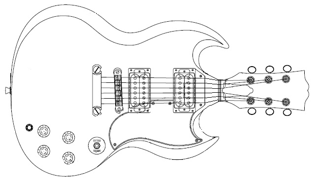

My experience is not vast and is simply gathered from owning 9 electrics, a couple bought and the others I made, all have the same emg active pickups and they all sound different enough that I usually end up preferring one for a particular song. But I am not sure these distinguishing features would be able to be tested.
If different necks effect a guitar then its hard to argue that the bits hanging off each end, the headstock and the body don't also have some impact. I don't think it is magic or guitar voodoo. Just a matter of design such as body volume and where that volume is placed relative to bridge and strings, and material properties such as density.
Small bodies like the sg in the pic and also thin, so there is not as much mass and that gives the sg some of it sound.
I have a flying vee with it big body mostly behind the saddle
A couple of explorers with thick bodies and a big mass behind the bridge and pointy bits out the front.
A thick RG and a thin RG, both sound different.
A 7 string RG
A IC 400
A couple of les pauls which sound more like each other than they do the other guitars
It would be difficult to say what is different about them without hooking them all up but I have a clear preference for each with particular songs.
