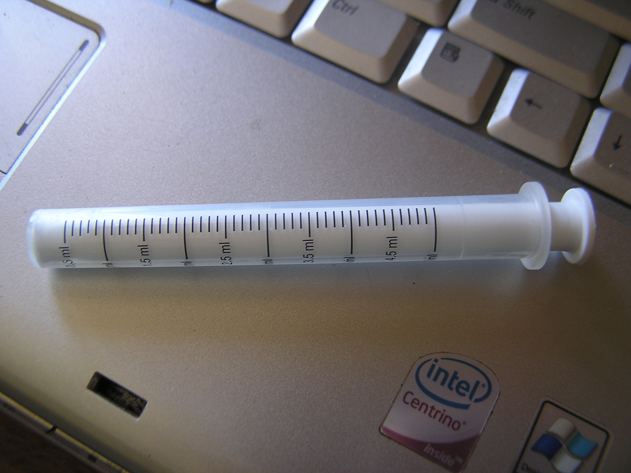

...I am making another falcate braced top at the moment and I remembered this thread because I had to mix small amounts of my West Systems epoxy again. Trevor recommended using syringes and drawing more than you need out and then going between graduations to be accurate which is what I did and it have been very successful. I have now found an instrument that will do all that and allow you to do very small batches too....and its very cheap....
I got a Panadol dosing syringe from a friend who has kids and always has liquid Panadol on hand for the kids. The great thing about it is that it is graduated in 1/2 ml graduations that are nicely marked. Anyway I hope that this info may help someone....
