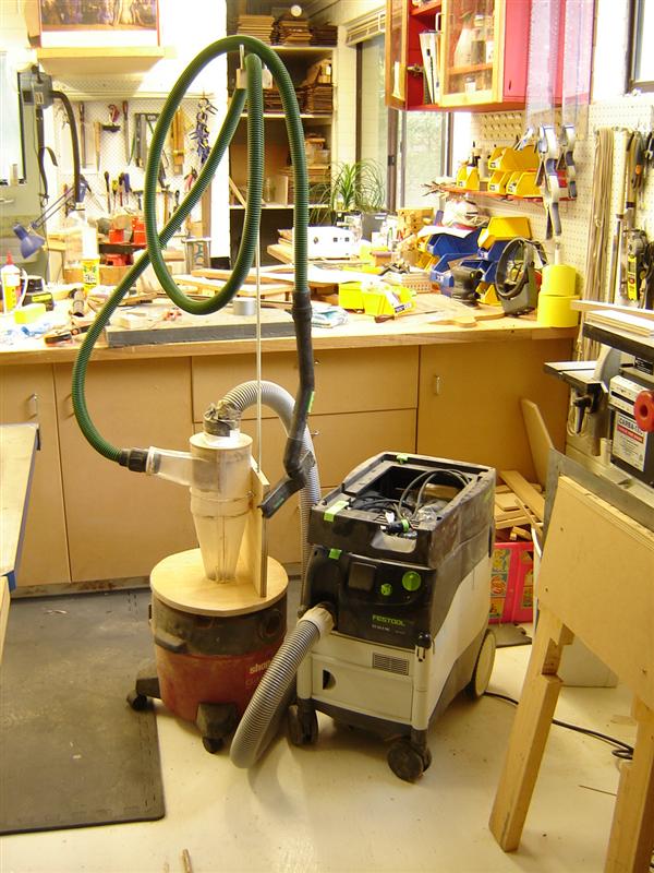

Here my set up. The vac never moves and I just pull the cyclone around on it wheels. The new unit is only half as tall. Cheers

The perspective deceives. The height of the vac and that of the metal part of the cyclone (without the PVC tubing on top of it) are about the same (55 cm). The suction rating of the vac is a hair more then that of your festool, but it is much noisier!Dominic wrote:Your vac does look a bit small next to it.
